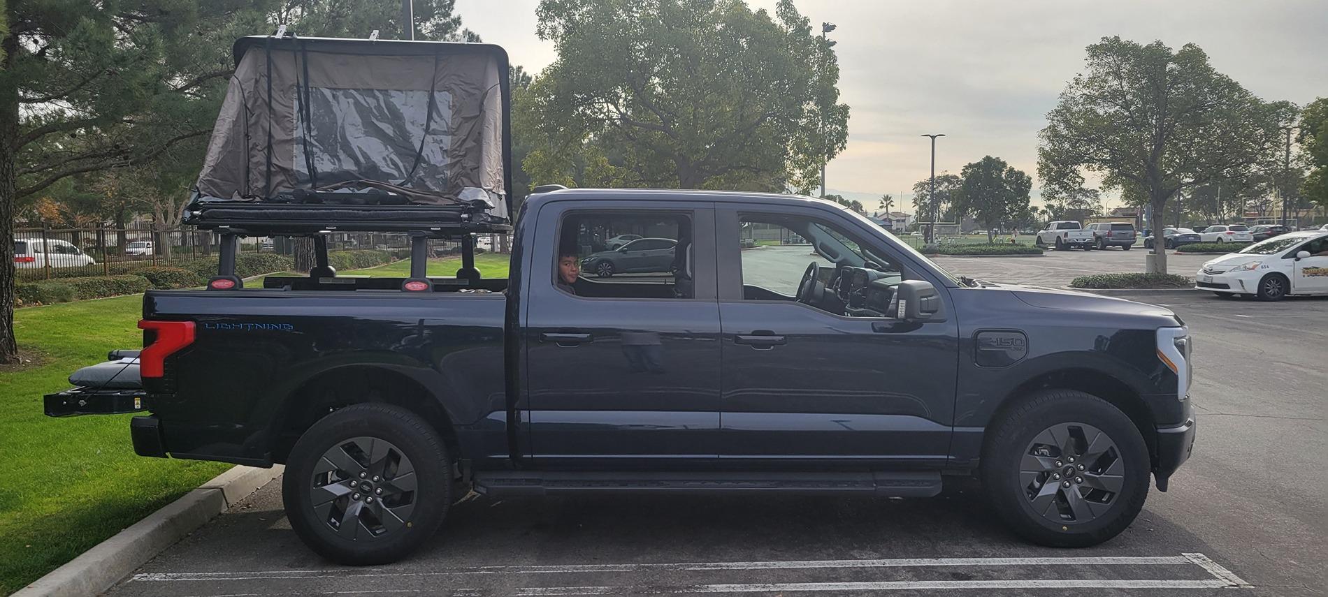

Oh, I not concerned about weight, I just want ease of access and I have a tent over my bed, and the last time I got a flat I wished it was in the bed where its empty 99% of the time.

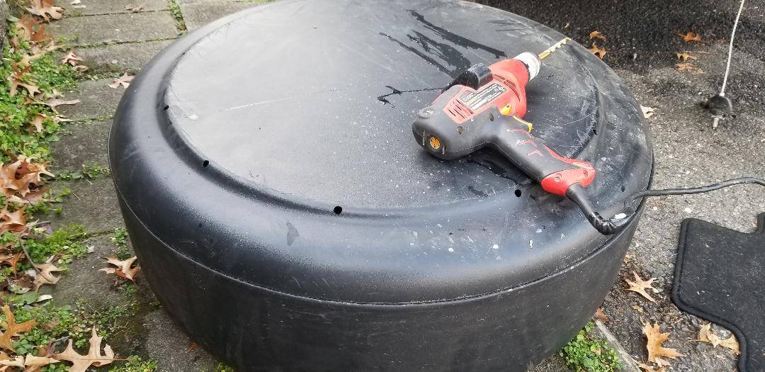

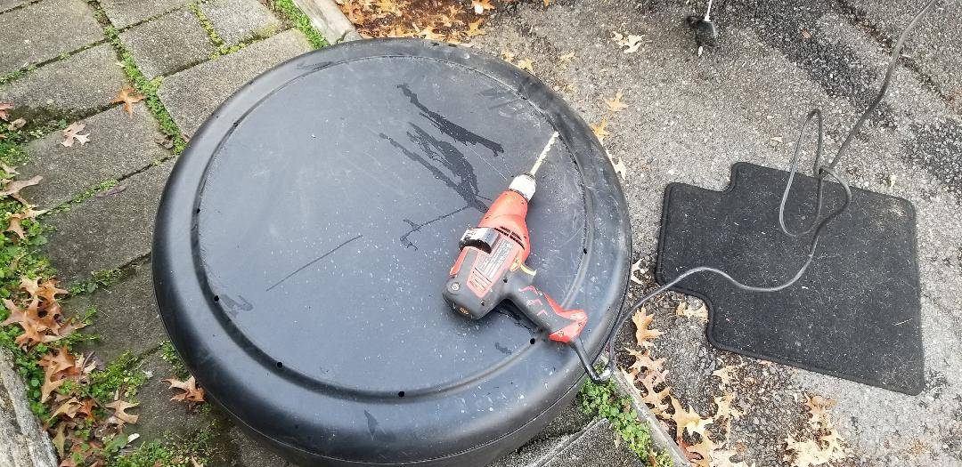

So I mounted this Hummer spare wheel cover on my spare full-size, full-function wheel & tire back in September.
I did observe about a .1kW .1 kWh efficiency gain overall since then.
We had a very dry Fall here in Virginia this year, until the past week+. Lots of cold rain on the wet roads since Thanksgiving.
Today, a sunny day, I got under the rear of the Lightning to replace a faulty Diode Dynamics hitch light harness. I lowered the spare wheel for more access.
I then realized that the spare wheel Hummer cover was significantly filled with water. It's obvious on reflection: the spare wheel cover is a hard plastic dish.
I dumped the about half gallon of nasty water out and drilled 11 holes with a 3/8 drill bit... roughly one every 10 inches or so. I drilled these drain holes right on the edge of the cover's lip, at an angle and didn't need to pull the cover off of the spare wheel to do this. BTW the truck's PowerPro bed receptacles came in very handy for this job.
No need for our Lightnings to carry around a half gallon of nasty water down there, or a potential ice block during Winter, for those of us who bought the spare wheel cover.
Pix attached.
Ford F-150 Lightning Any range gain within spare removed? Spare wheel cover drain holes 3
Ford F-150 Lightning Any range gain within spare removed? Spare wheel cover drain holes 2
I did observe about a .1 kW efficiency gain overall since then.
Pix attached.
Perfect. Nice catch. I'll check mine tomorrow. Thanks.

Note: the holes I had drilled on the Hummer cover's raised edge (post #41 above) does drain all accumulated splash water from the cover's inside - no ice block at all inside the Hummer cover :)
