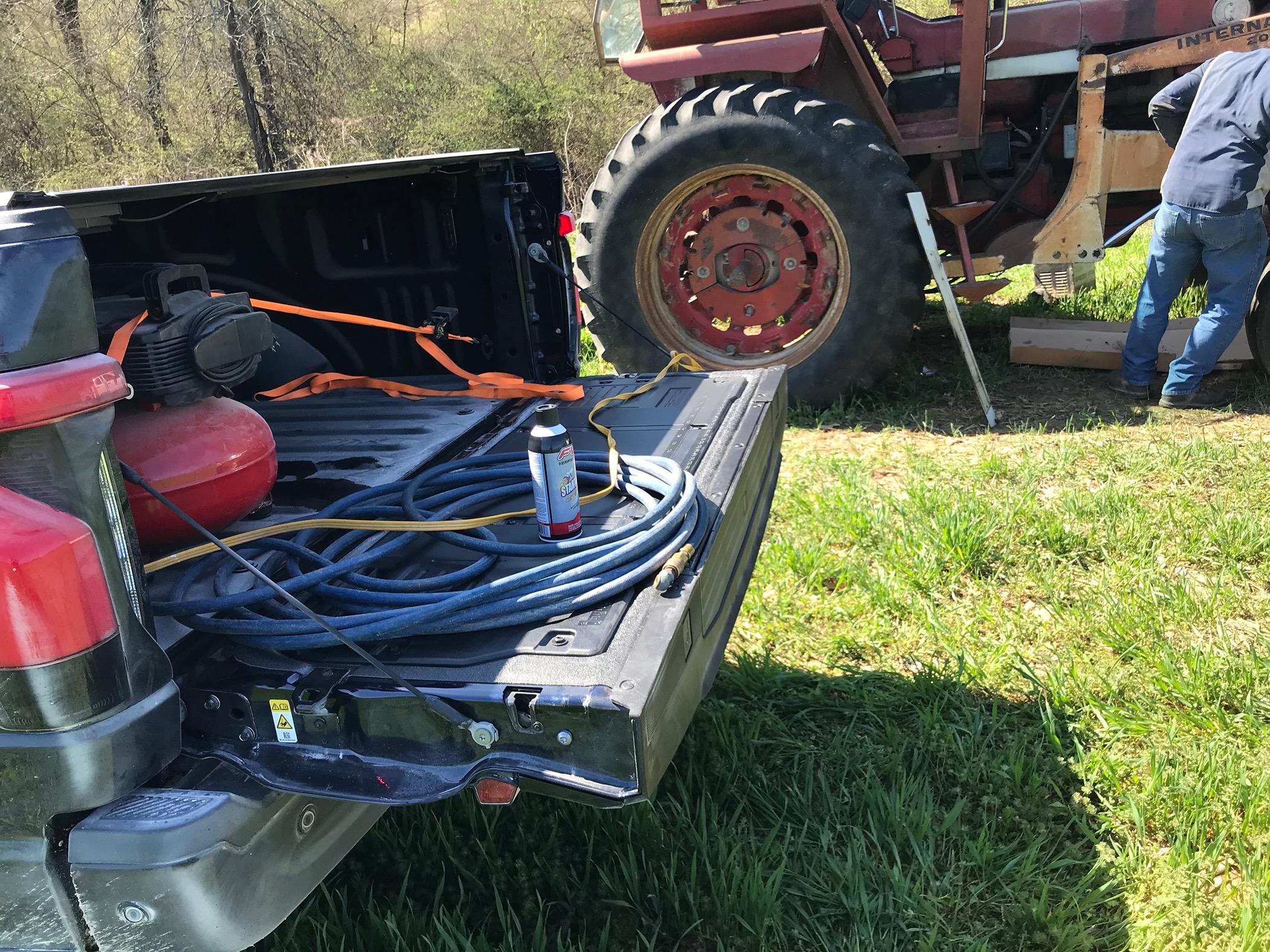

I run this Porter Cable compressor without issues.

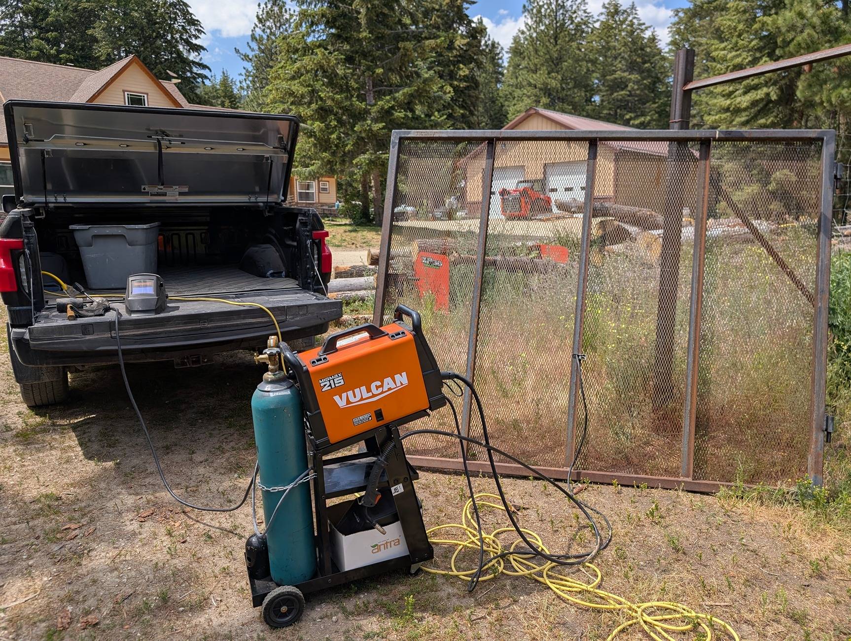

No problems welding a gate repair with 240v set to 1/4 steel.

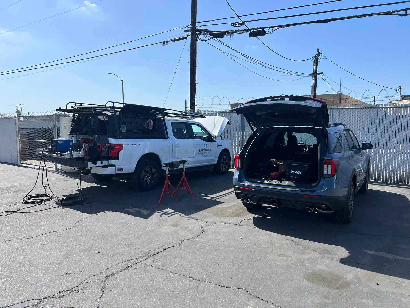

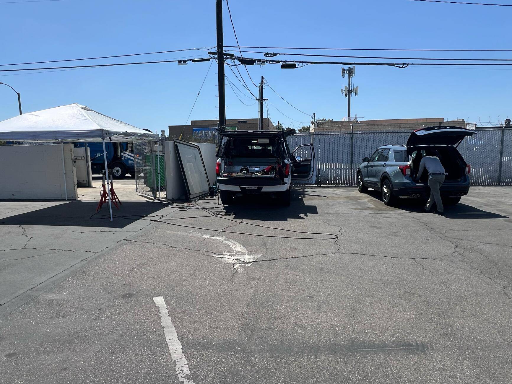

It will be fine for light duty use.
I'm about to update a post about an issue I've been having with my 220 v outlet while welding. Granted I'm a pipe welder and weld stick after stick non stop until the weld is done. The ProPower doesn't like that. Even though I'm only drawing 20 amps it will shut down. Ford engineers are scratching their heads. I've attached photos of them literally plugged in while I reproduce the issue. They still have no path to a fix. I've unfortunately had to start the Lemon buyback process. I've been dealing with this issue since December.

Stick welding is harder on a generator than MIG welding, due to:
Higher surge current needs,
More erratic load profile,
Higher amperage at similar thicknesses.
I'm disappointed your setup isn't working for you.
