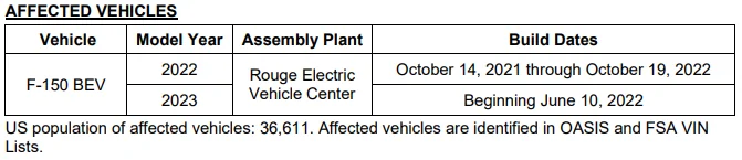

The 4% you are referring to is from this document and the specific wording is, " Less than 4% of the affected vehicle population is expected to require one or more high voltage battery modules needing to be replaced." (Page 9)
4% is 1464 of the 36,611 built vehicles, with either 6 or 9 modules (SR vs ER). We have seen a few folks having more than one module needing replacement (see the red highlighted lines in my spreadsheet (in signature below). Does anyone know the number of cells per module (and how many different module types...do the 6 SR modules have a different number of cells in their modules vs. the 9 ER battery modules?
