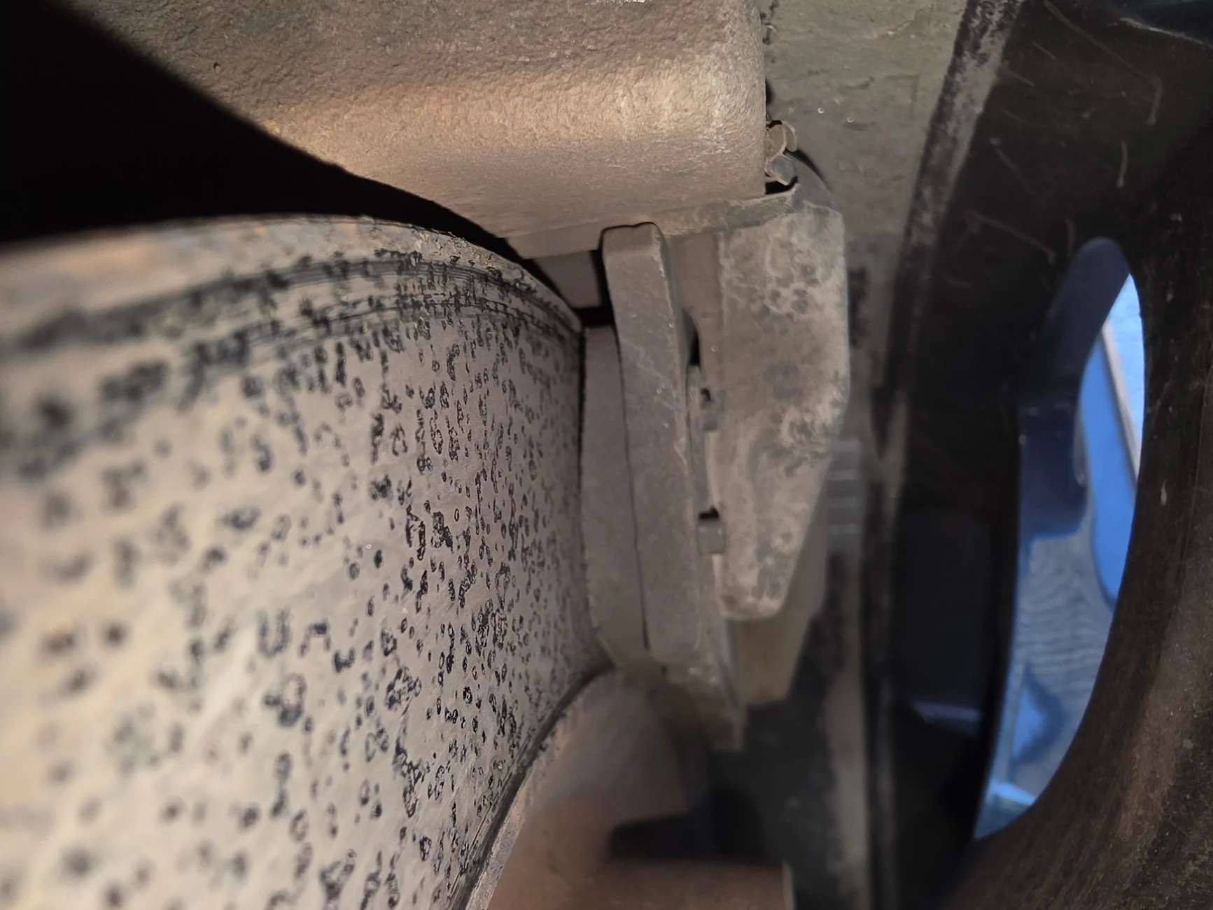

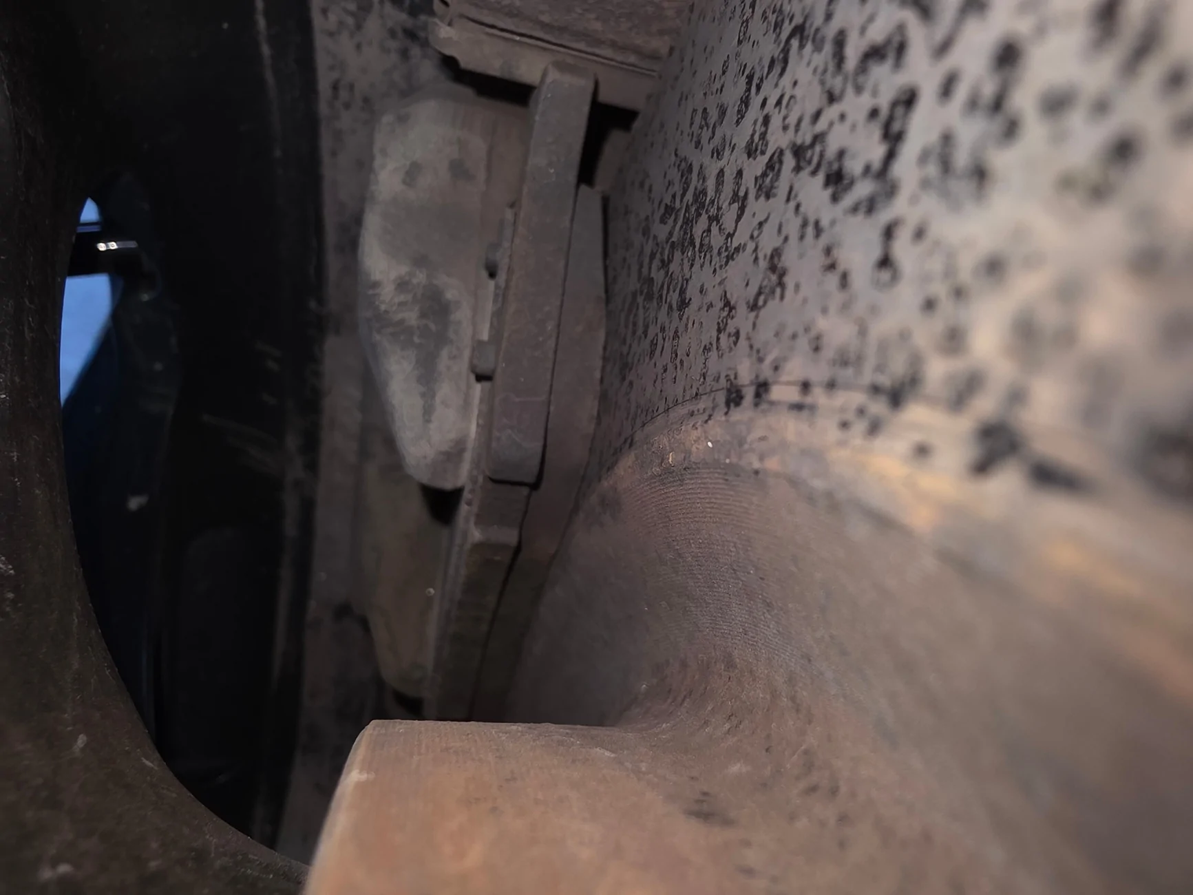

Just had my truck inspected (3 years+1 month old now, 34k miles) and the shop said "all 4 brakes" and "rears really low". We've used this place the past few years for inspections, independent shop and they haven't really tried to upsell anything before. I've replaced brakes on 4 of my different cars (6 total changes I think), but by all means not an expert so just want someone else to chime in here... the rear pads look like they have plenty of life (though appear to be wearing asymmetrically), do you agree? I can't get my phone into a spot that I could see to get a good picture of the front pads.
Upstate NY so we get a good amount of salt exposure in the winter. I'm not a heavy footed driver and strive to hit that 100% on the brake score (I don't know if I ever dipped below 75%).

That is a lot of pad left. Easy should get you another 34k.
Does your truck sit at times (like weeks months)? That level of rust on the rotors is odd even with Regen.
Well,, It looks like the calipers are not seating correctly(Hanging up somehow), as noted by the thinner top of the pad than the bottom, and Rotors have some pitting. BUT that being said, it looks like you have plenty of pad left.
