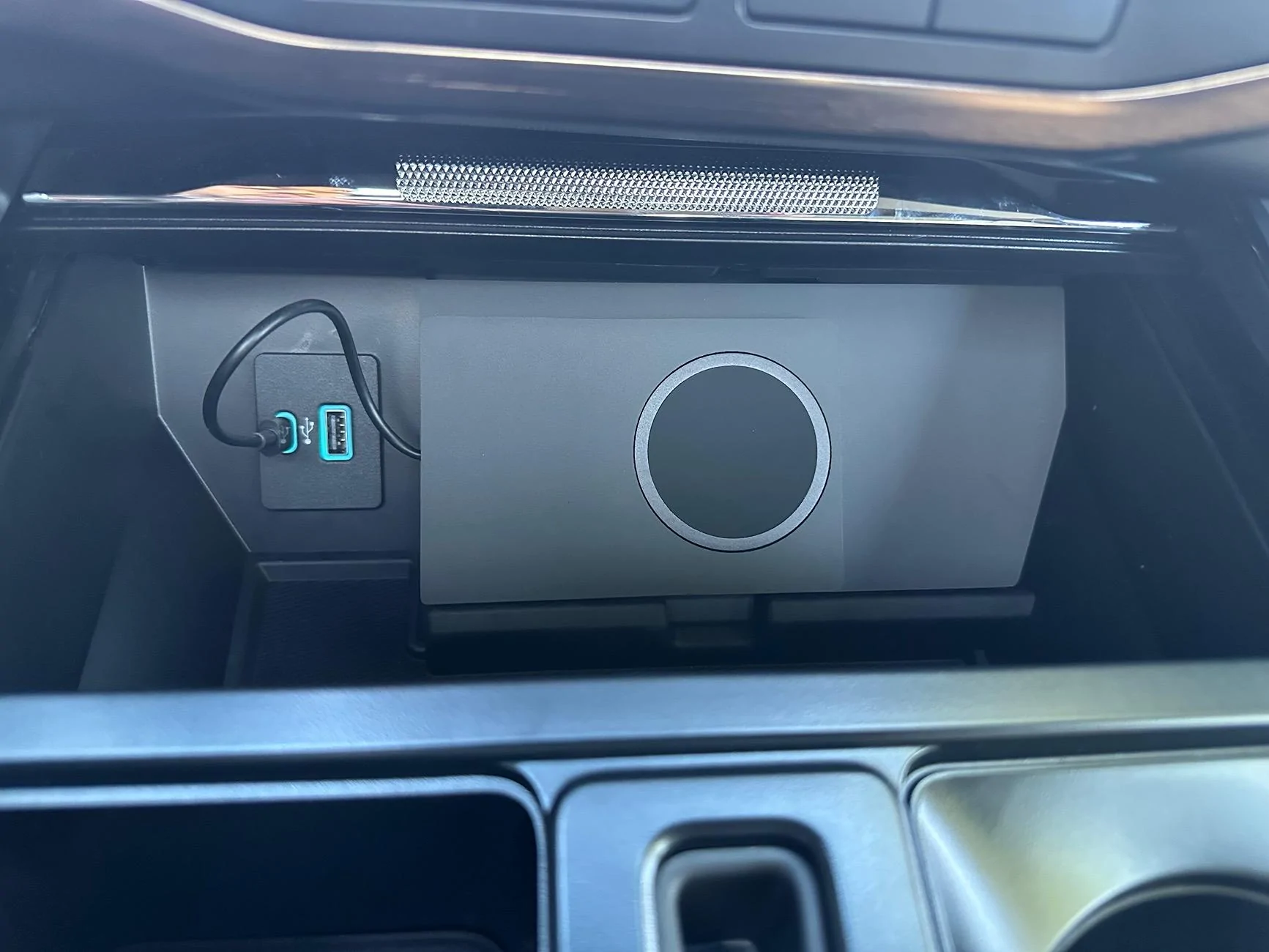

This is what the TWRAPS looks like
Ford F-150 Lightning Built in phone charging. IMG_4488
