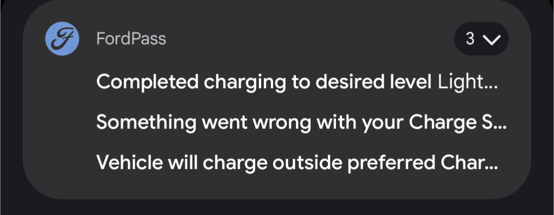

Well, things are definitely better these days, but not perfect. Plugged in about 1130 last night when I was down to about 50%. Target is 90 by 8am, still set to 80 amps. Not sure why it thought it'd have to charge outside my set hours (11pm-8am) to get from 50 to 90. Threw an error at 3am, but must have reset and kept going. Looks like it finished OK.

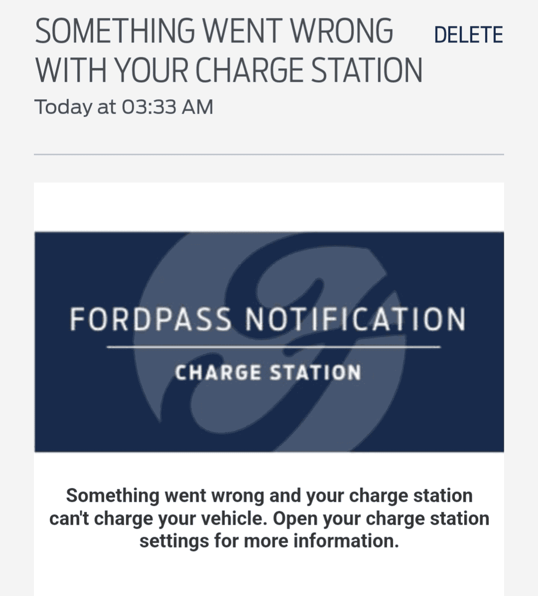

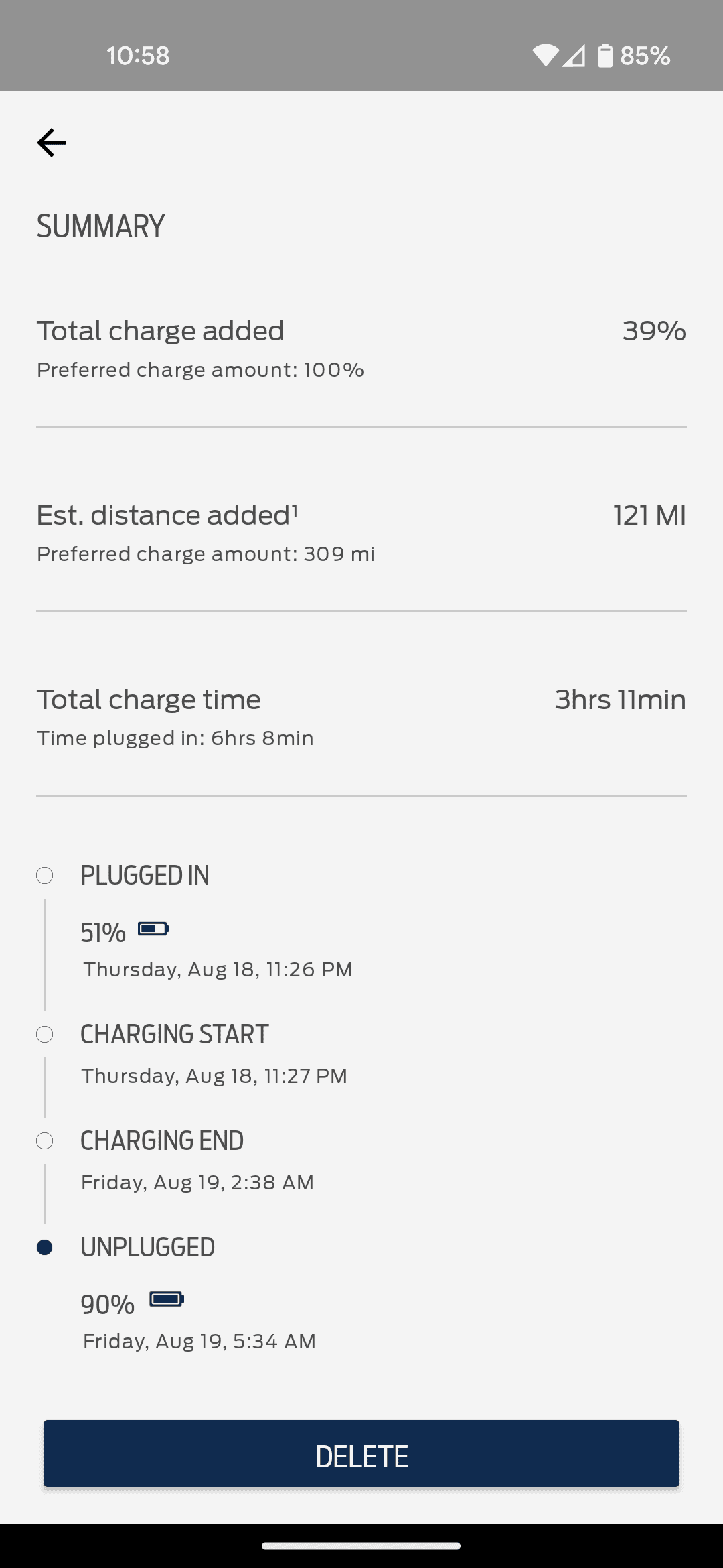

The mystery deepens... Looks like it finished charging to 90 at 230, but threw an error at 330? 🤨
