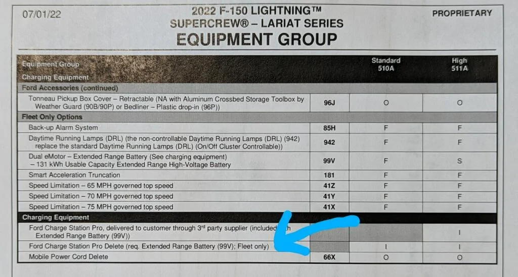

- I wish/hope that at some point, Ford makes the Charge Station Pro an optional purchase. It seems that a lot of peole are selling them online. If my ER model comes in, I will also be selling mine (for reasons stated below)
