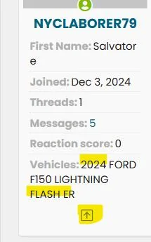

2024 FORD F150 LIGHTNING FLASH ER

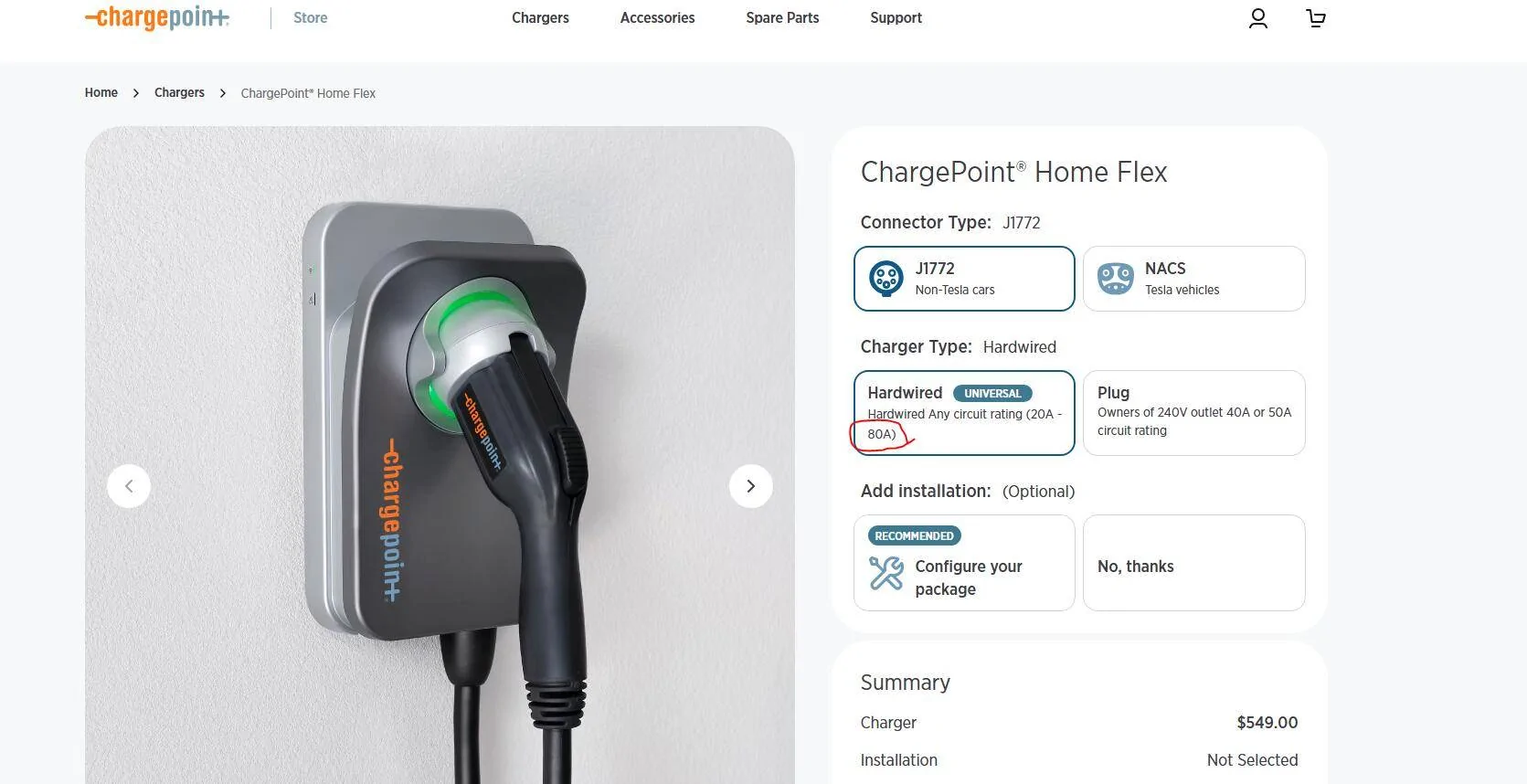

Chargepoint flex output is set during setup and maxes at 50 amps

Isn't the 20A-80A listed there the circuit rating? The EVSE still maxes at 50A

You have a 2024 lightning. Ford eliminated the 80 amp charge capability with the 2024 model year. Your truck can only charge at the traditional 48 amp max.

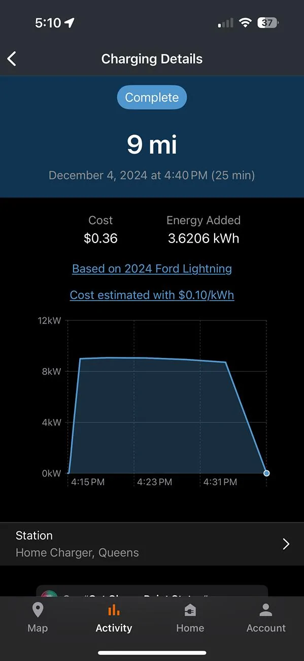

so update, i rewired the charger
6 awg thhn black and red
8 awg thhn green ground
60 amp breaker
Now i plugged it in, and im getting 45 amps/9.2 kwh
at this point i give up
60 amp breaker
Why would you rewire it?
Why would you think rewiring it would change anything?
And yet again, your truck won't charge any faster than 48a.

I have a ChargePoint Home Flex Charger hardwired on a 60amp circuit and 6 awg wire.
I get 48 amps and see an average rate of 9.5-11.5kwh per charge session.
Works great....
How are you measuring or determining the amps and KW?
