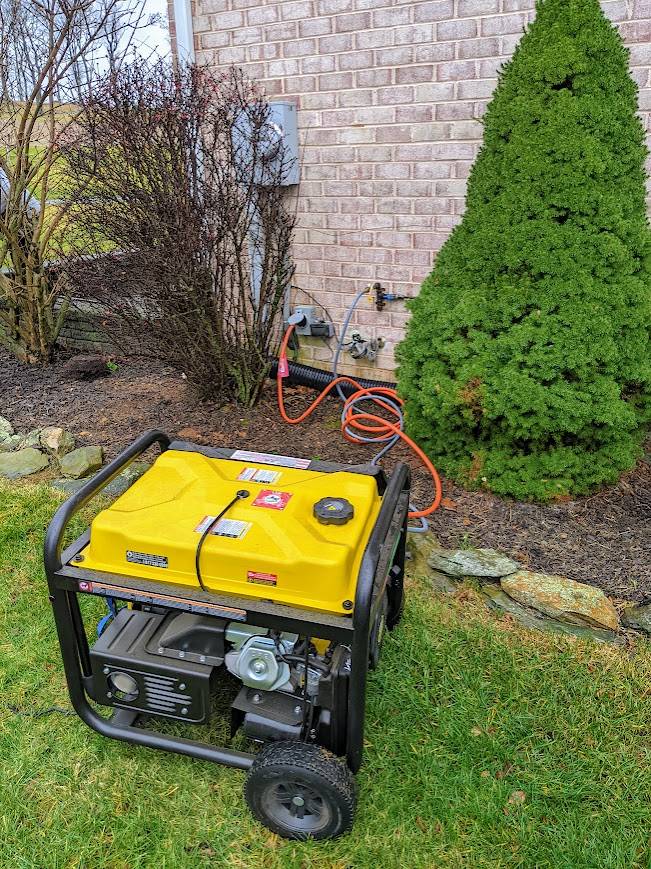

I've got a Dual-Fuel (Propane and Gasoline) 12,000 watt "portable" generator, that to date over 3 years I have managed to only run on Propane (purposely for reduced maintenance). So 2 fuel options, and then the Truck is option #3, with whole panel interlock kit.
Eventually I'll upgrade to a Natural Gas Standby which are pretty affordable in our area, at least in comparison to what I've heard others claim they cost in other areas of the country.

Meanwhile, plugging in ProPower to my generator inlet had my house up and running in 3 minutes. Which seems to be less time than it takes to do an upside down dance while facing west with the left turn signal on at high tide on even days between noon and 3pm in order to get the HIS working, maybe.

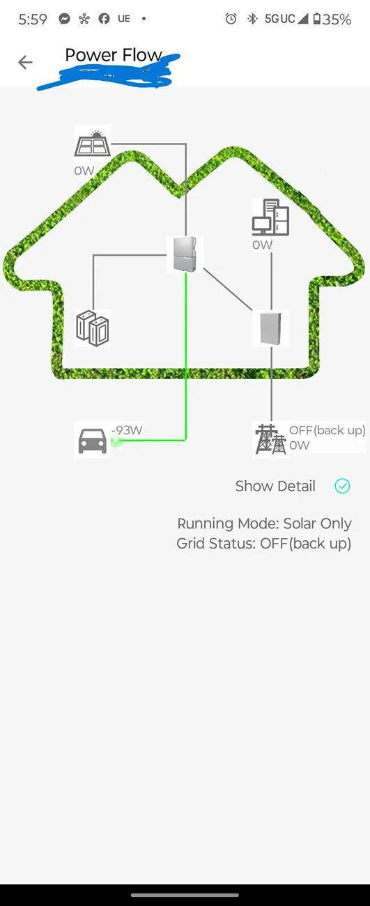

I am also having issue with mine. I can not get it to work. The best thing it does, is it sends power to the inverter and wont send power to the main panel (house). I just got ECG-24.2.5.6.2.2 updated this week. Do you know if ECG-24.2.5.6.2.2 will update the Bluetooth firmware?
holy shit this is exactly what happens to mine, i thought i was going crazy.
