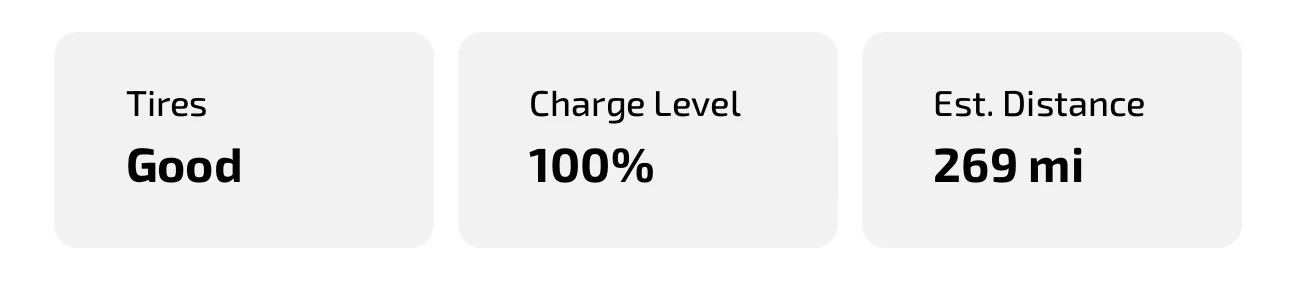

One or two others have reported it, and I just got a 100% LV battery SOC after charging the HV battery to 90%.
