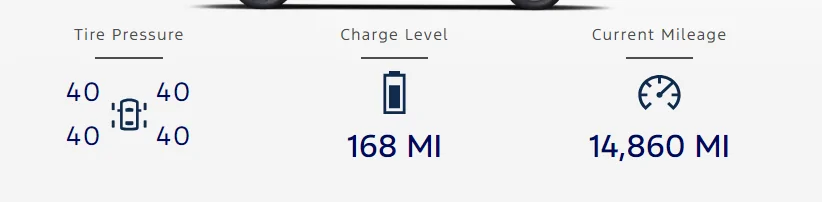

It looks like they took the 12V SOC off the vehicle dashboard page. Unfortunately it looks like they replaced it with the GOM.
Ford F-150 Lightning CSP-23B70 Certain 2022-23 F-150 Lightnings - BMS Sensor Replacement IMG_0315

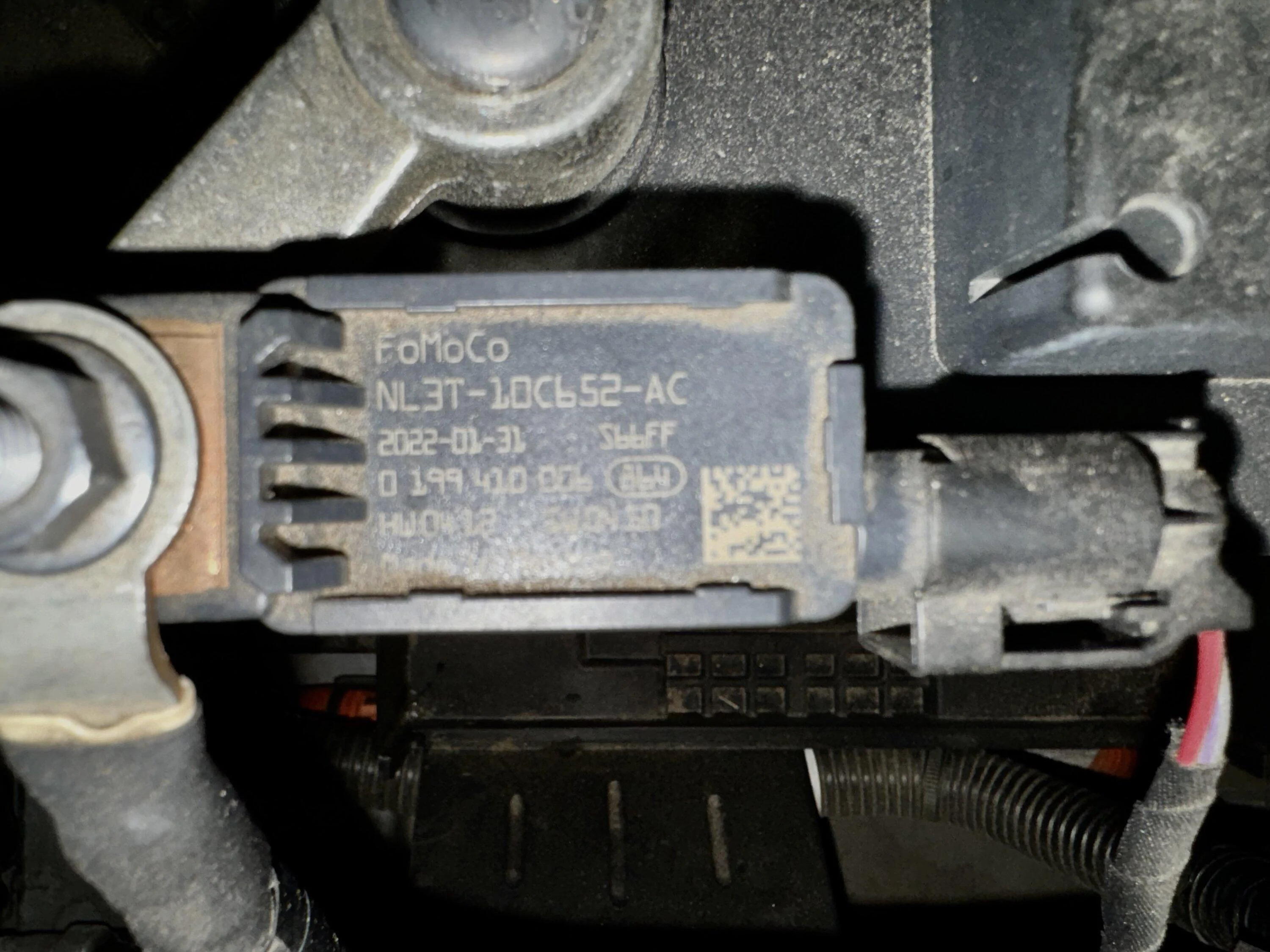

I have the affected part number 12v BMS. No CSP in the mail and no CSP tab in FordPass anymore for me. I may have the earliest build date of this BMS.
I regularly get OTA…but I drive a lot.
Ford F-150 Lightning CSP-23B70 Certain 2022-23 F-150 Lightnings - BMS Sensor Replacement IMG_5920

-AD in my Pro, module dated 2022-11-10.
Been regularly receiving updates, believe I'm currently on 6.8.0, only had update failures a handful of times but generally work on the next attempt. This CSP campaign appears in my FordPass, seems like a good excuse to try out Mobile Service.
