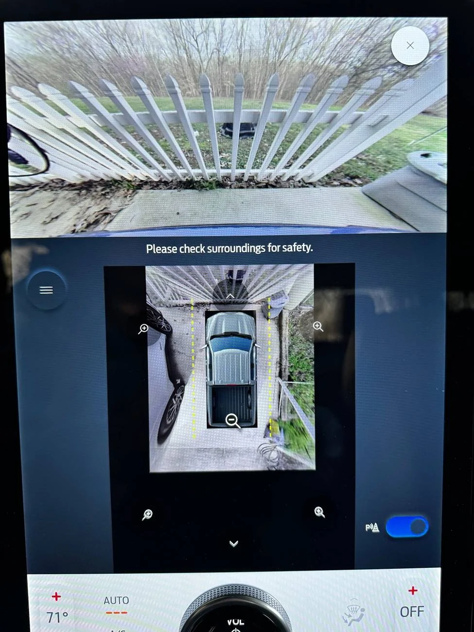

Here is my current 360 display. Do I need the additional update, lol? Feels like there is a lot of black space around the view that didn‘t used to be there. Many thanks for input!

Henry Ford
Dec 21, 2022
1,317
1,846
2022 F150 Lightning Platinum
Yes. See post #353
