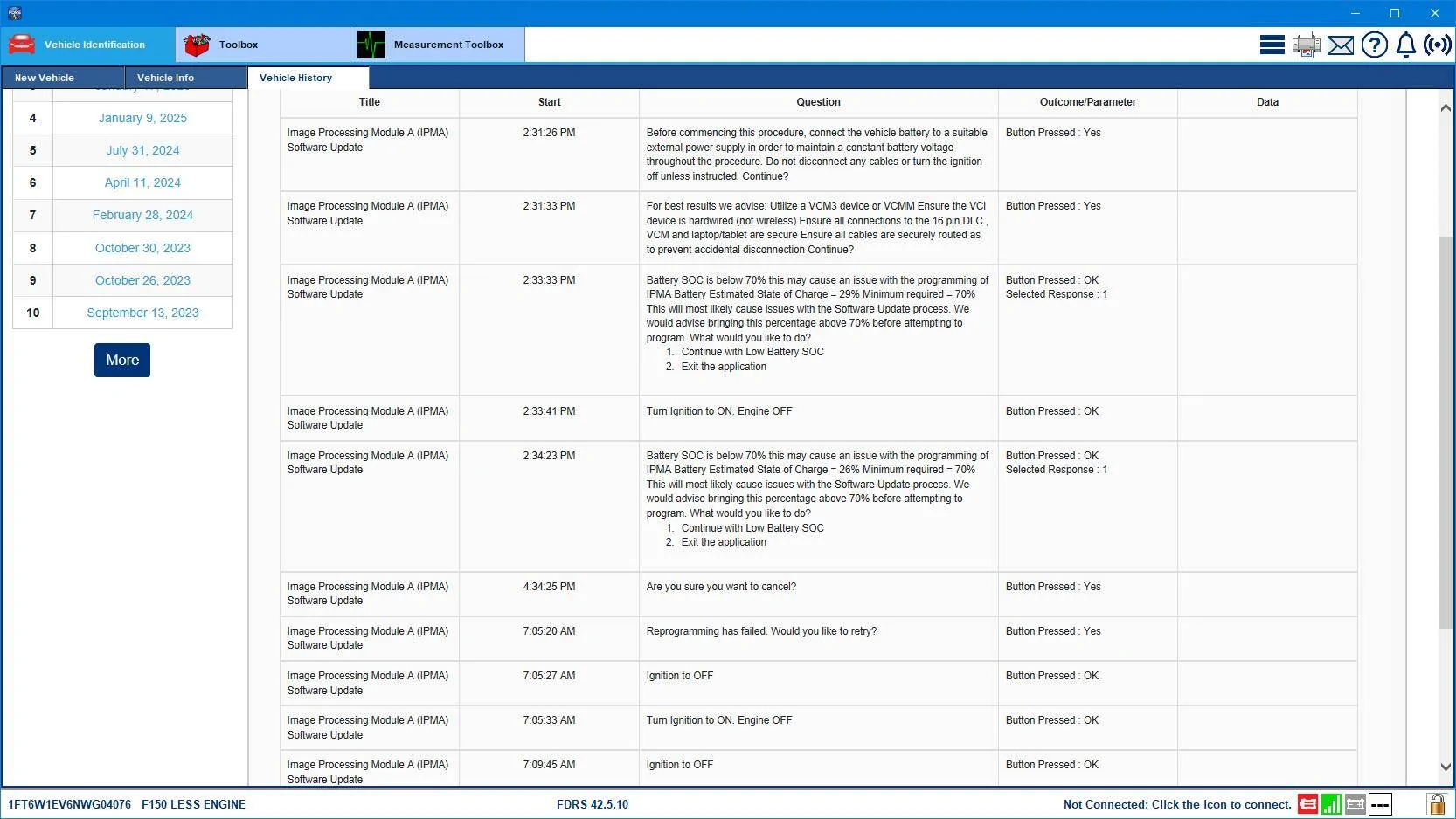

Well Sparky went in Friday to have the IPMA update ran (along with a few other CSP issues). They had the truck all day Friday and the update continually fails. Dealership called Saturday saying it was still failing and to check back Monday.
I really like my dealership (Cook County Ford) and have a good rapport with their service department. The last thing I want is for them to brick Sparky, especially with the cold weather storms coming in this week. I will rely on the truck if the power goes out.
What should I tell them to try next? I read in this thread to make sure the 12v battery is being actively charged and set correctly for the Lightning and to have them watch for communication errors when updating in FDRS. Also to run the IPMA Configuration tool in FDRS once the update is applied. Anything else? I also don't want to come across as an arrogant ass. I've been in IT for 30 years and know how finicky updates can be, and Ford seems to struggle in this area. Something is definitely amiss if Ford's own bulletins to dealerships include an additional 10 hours for failing IPMA updates or replacement modules due to failures.
Well, maybe they should try doing the programming when the 12V battery isn't at 29% SOC and use a powersupply. That would help. (Insert Ron White quote here).

Using a powersupply during CANBus programming is not optional.

29%? oof. It's amazing how clueless the techs can be.
Well that explains that. I'll definitely be calling them as soon as they open if not leave a message now before they do damage with something that will take longer to resolve. Thanks you @Mike G for looking into that and tracing the problem down.

Update: No updates 😑. Stopped by Monday and they charged the 12v battery to 80% and tried again. Still getting failures. They were closed on my way home today (Tuesday) due to the snow coming in.

I'm getting my truck back today after work. I have a strong suspicion they temporarily put in another 12V battery (on a charger) to complete the update, then swapped my original battery back in. I'm anxious to see if any issues come up after this.
As Joneii said about his truck, my truck is a 22 with 55k miles and I've had no issues with the 12V battery so far (that I know of). Who knows if OTA updates have failed or were left in a pending state for extended periods due to the 12V, but overall I think I'm current when I checked a few months back.
