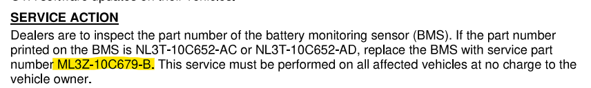

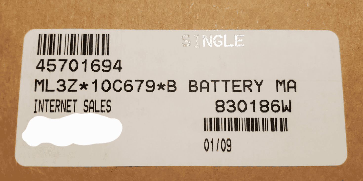

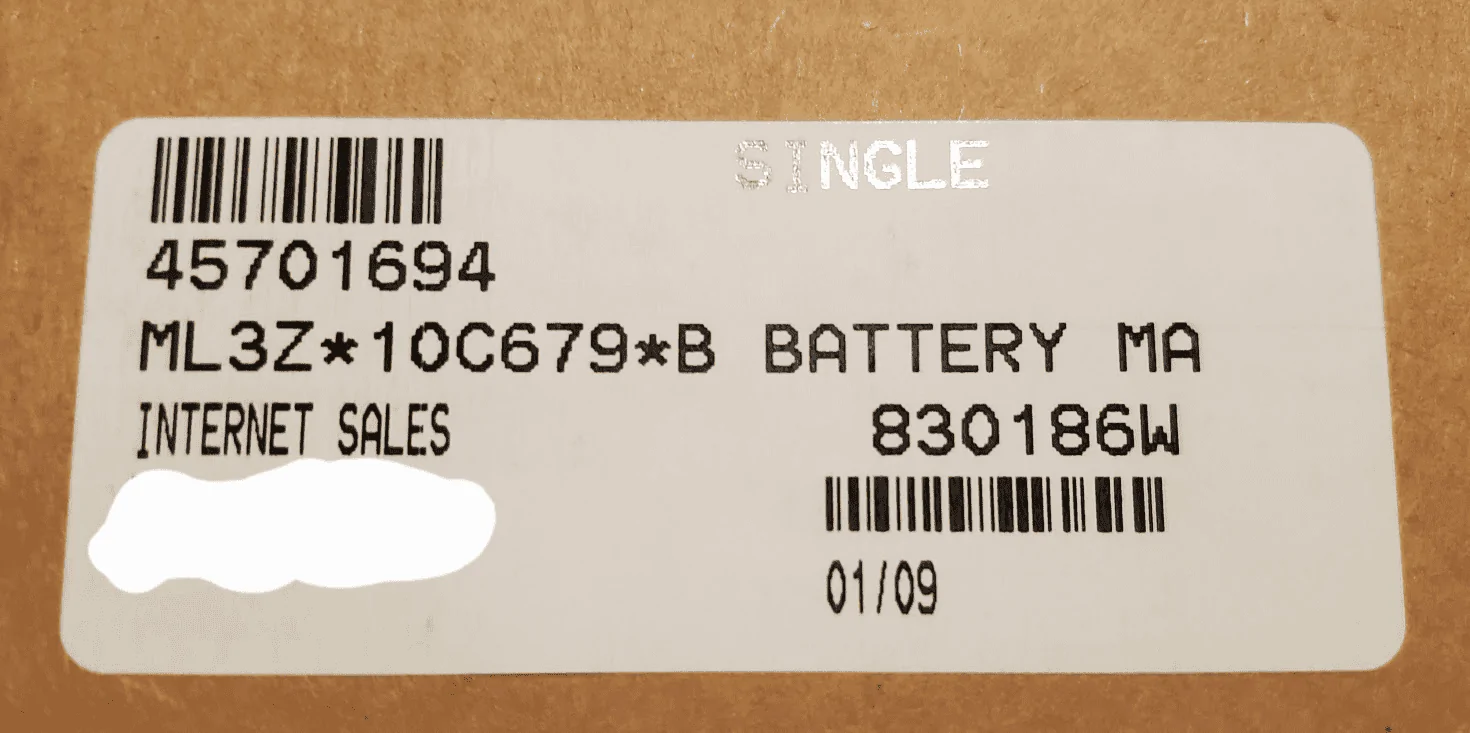

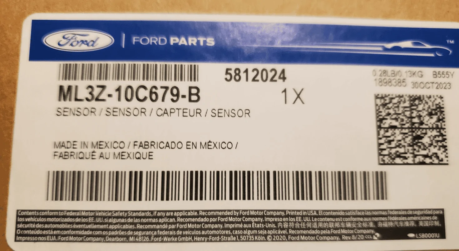

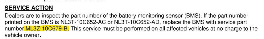

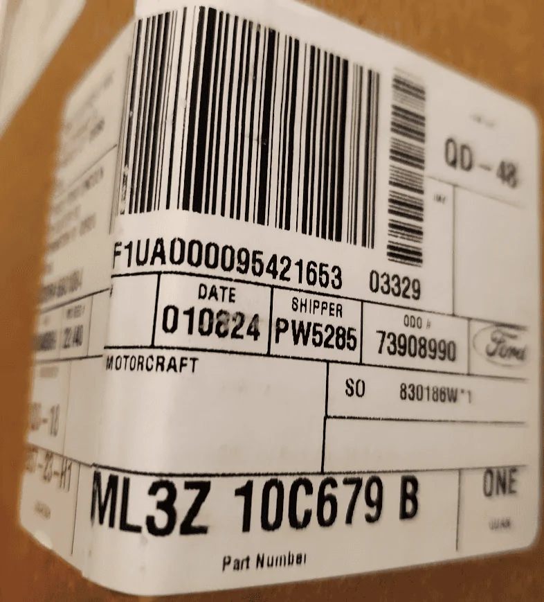

Thanks. Interesting that the part number on the photos show "ML3T" versus "ML3Z" to order.
Right.... This is the shipping box labels for the part I received.
Ford F-150 Lightning CSP-23B70 Certain 2022-23 F-150 Lightnings - BMS Sensor Replacement 1705098736970
Ford F-150 Lightning CSP-23B70 Certain 2022-23 F-150 Lightnings - BMS Sensor Replacement 1705098755635
Ford F-150 Lightning CSP-23B70 Certain 2022-23 F-150 Lightnings - BMS Sensor Replacement 1705098782020
3,113
4,455
According to this website, that 4th character in the prefix is the Design Responsibility Code:
T Heavy Truck Engineering
Z Ford Customer Service Division (Ford), Product Analysis and Publications
Edit: It is interesting that the basic part number (the piece in the middle) says 10C659 on the box but 10C652 on the part. I only glanced at the box my mobile tech had and just saw the -B. Didn't notice the other bits. But it is a later revision as evidenced by the suffix and the SW version.

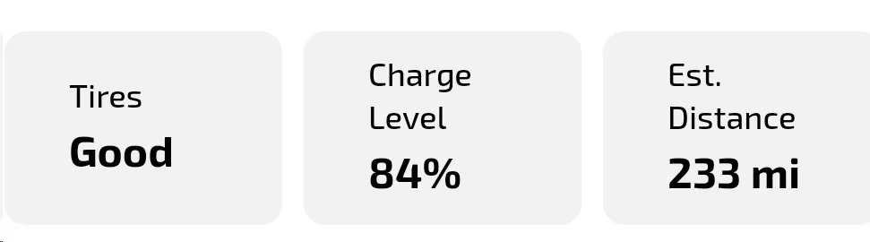

I've been idling the truck for ~5 hours now, the LVB SOC is at 84%
Ignition status Run [AUTOMATIC SHUTDOWN switched OFF]
Lights & E-Heat off
Cabin HVAC fan set to 7
