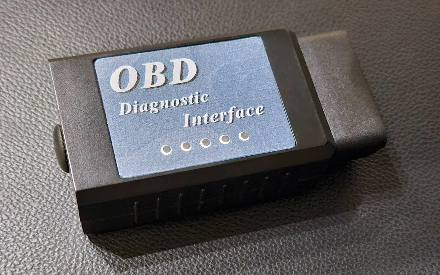

I think @rugedraw figured out the FORScan way here. Start here and let us know if it works:
https://www.f150lightningforum.com/...programming-guide-using-fdrs.8249/post-412933
The FORScan fix worked! And I was able to use my ancient el cheapo OBD reader over BT.
Ford F-150 Lightning CSP 24B56 - Inoperative Front Parking Sensor(s) - IPMA Software Update for Certain 2022-24 F-150 Lightning Trucks obdII
I did get a warning that it was slow and not all FORScan functionality would be available. It took a while to read all the modules but I was only going to edit the one for the fix which was a single character write so I wasn't worried. If I start doing more then I'll probably spring for a wired connection. Saved me a trip back to the dealer!
