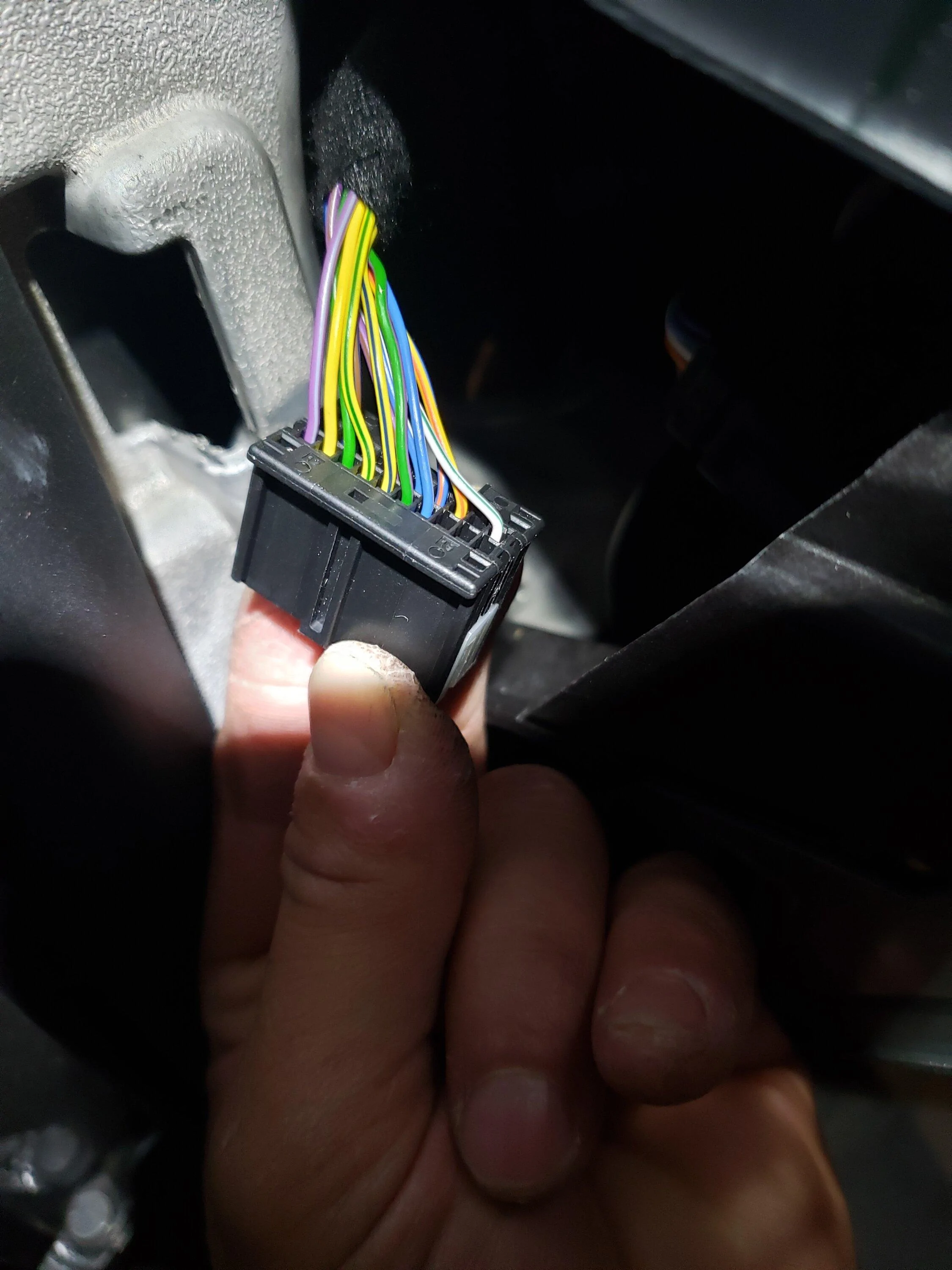

Just checked my IPMA connector and it's missing the four wires (pins 9, 18, 19, 20).
@KurtsRPMGarage, in your video you say that without these 4 wires in the IPMA connector, this mod is not possible. But couldn't I just add the 4 wires to the IPMA connector and go straight to the CCM or the C134 and just bypass the C265?
Yes not impossible I was just unaware. Over on the ice forums it sounds like some of those guys have dealt with this. Just like you said it sounds like you can run a custom harness straight to the CCM. That’s according to Superfordman here Link. This is all assuming you have all the hardware. Does your truck have the 360 cameras and ultrasonic front sensors. I believe those are a requirement. Someone correct me if I’m wrong.
Thank you! just checked out portions of that thread and Superfordman confirmed that the 360 IPMA is not needed for ACC. He was able to add ACC on a truck that only had reverse camera (basic IPMA). Sounds like all I have to do is make my own 4-wire harness from IPMA to CCM, which means I don't even have to replace the bumper harness. I'll just get the CCM pigtail and splice/extend the wires all the way to the IPMA. Does anyone have a part number for the CCM pigtail?
The other thing I'm wondering is whether the LKA feature alone can be added with just Forscan changes? From what I understand, LKA does not actually use the CCM, but rather relies only on the windshield sensor. Am I wrong? What do you guys think?
