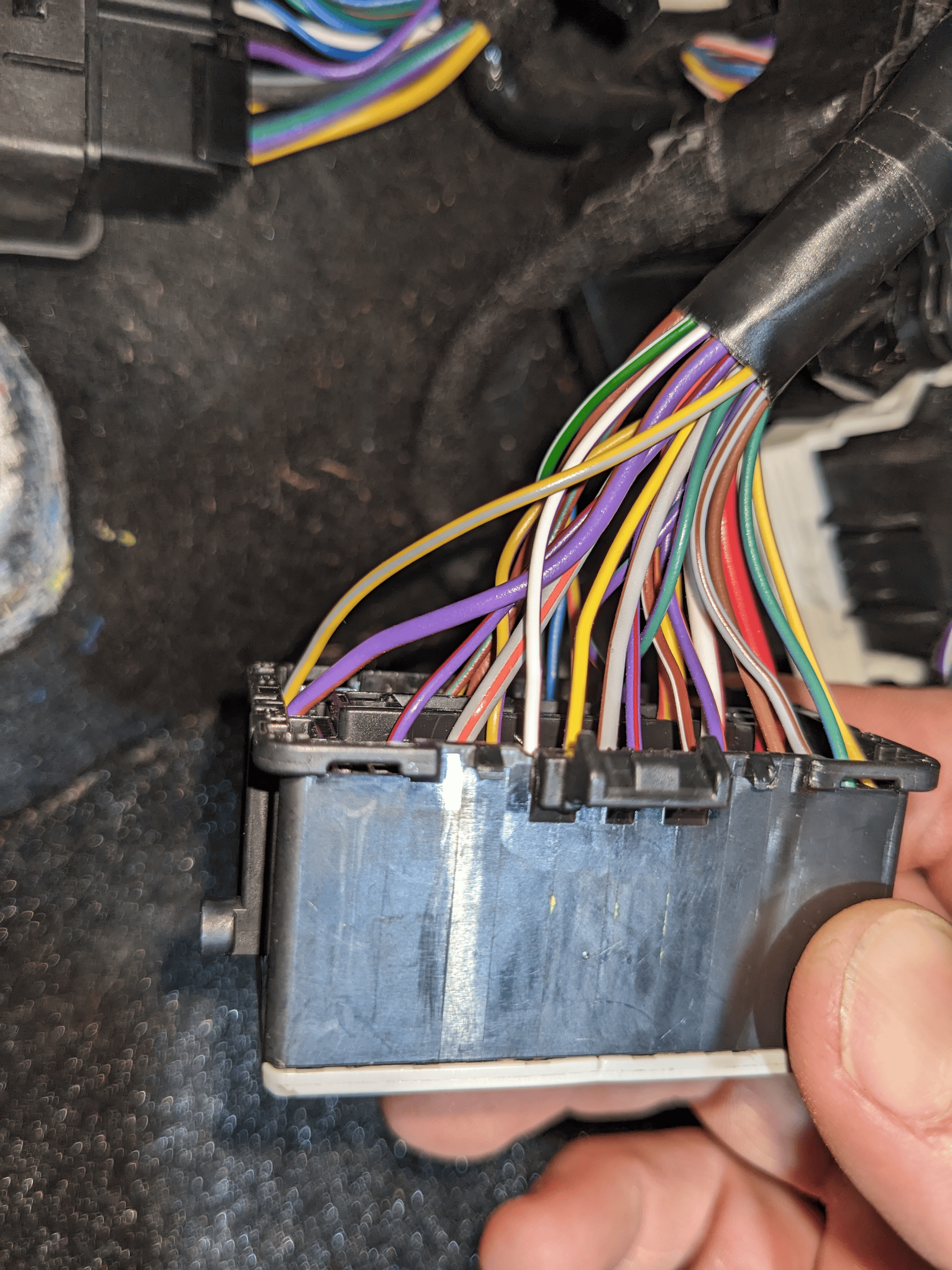

Hi any helpful forum go'ers: Can someone view my C265? connector and help me identify if I have the correct wires already?
I believe I have them, but I am a bit colorblind, and going mainly on location.
Image taken with connector still seated.

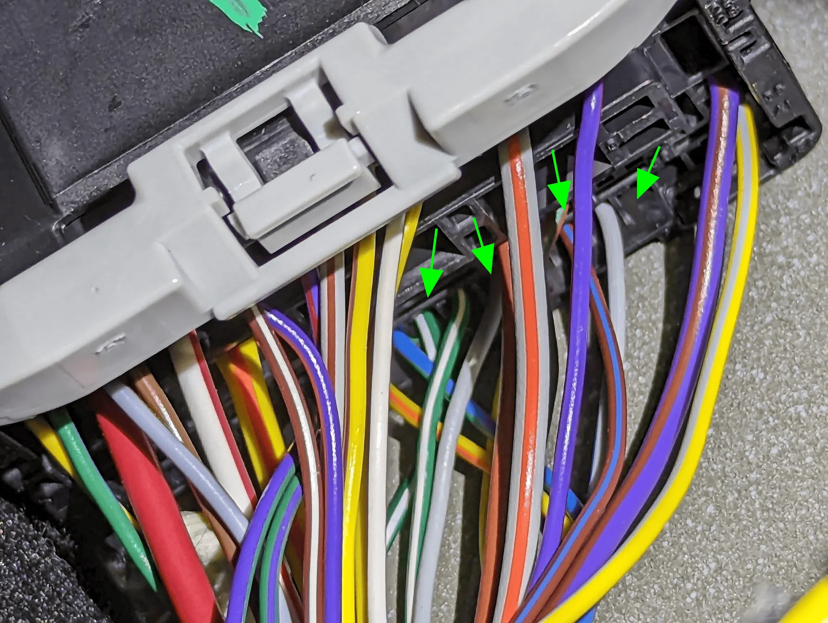

"A bit colorblind" is unfortunate. I can't really be sure of your tiny arrows, grab a friend or family member to review your colors to be safe.

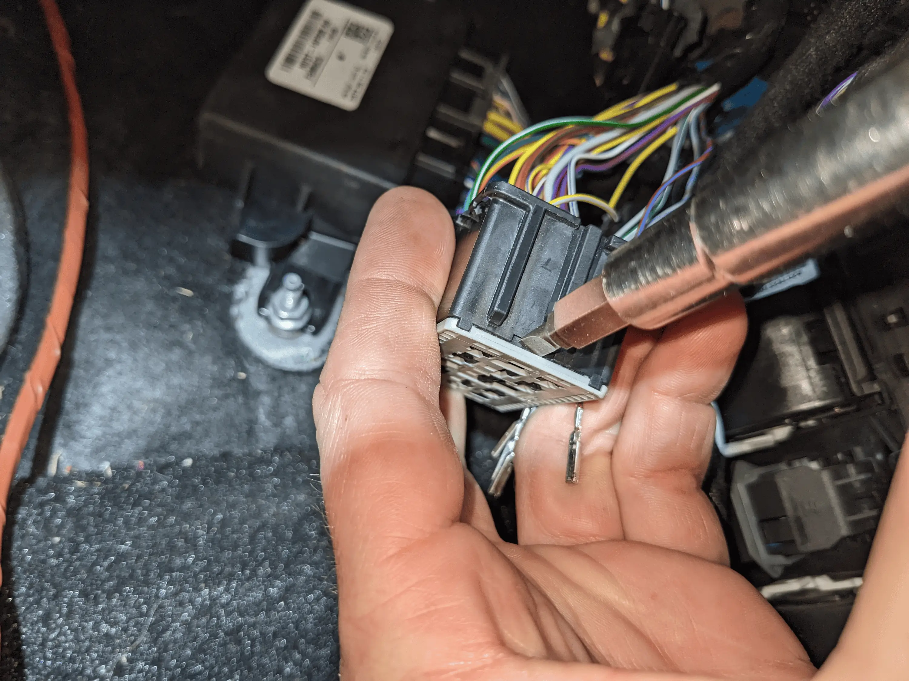

From a previous post
Ford F-150 Lightning DIY: Installing ACC (Adaptive Cruise Control) and LKA (Lane Keep Alert) to 2022 F-150 Lightning XLT 1681018109449-
Once you get this female end released you can pull it out and bring it down to have just enough room to work on it. You pry and release the retainer like this
Ford F-150 Lightning DIY: Installing ACC (Adaptive Cruise Control) and LKA (Lane Keep Alert) to 2022 F-150 Lightning XLT 1681018270260-
Once you have the retainer out you remove the pins with a pic in a very similar fashion to C134.

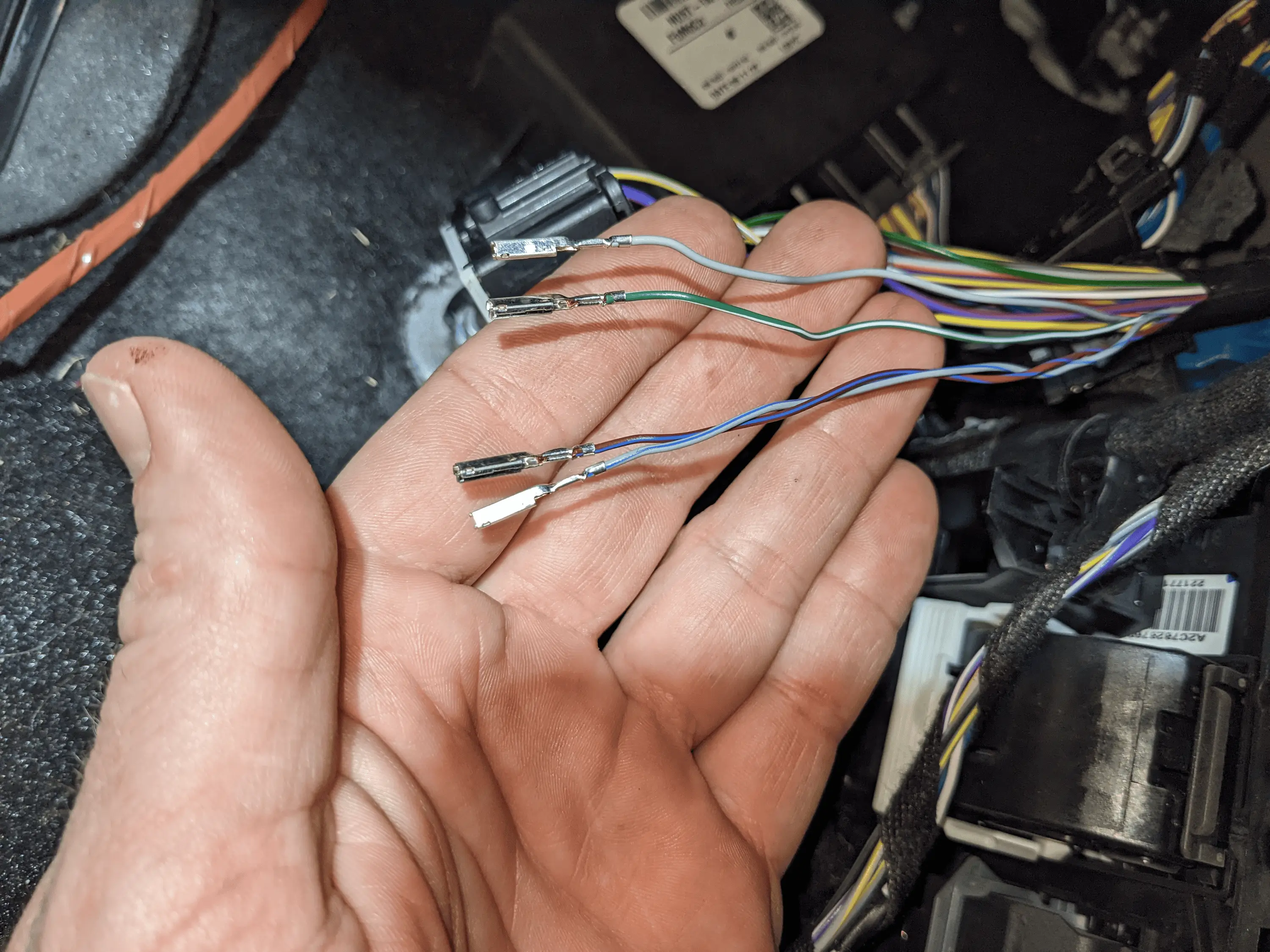

I left the factory female pins crimped on and simply inserted them into WAGO in-line Lever-Nuts
