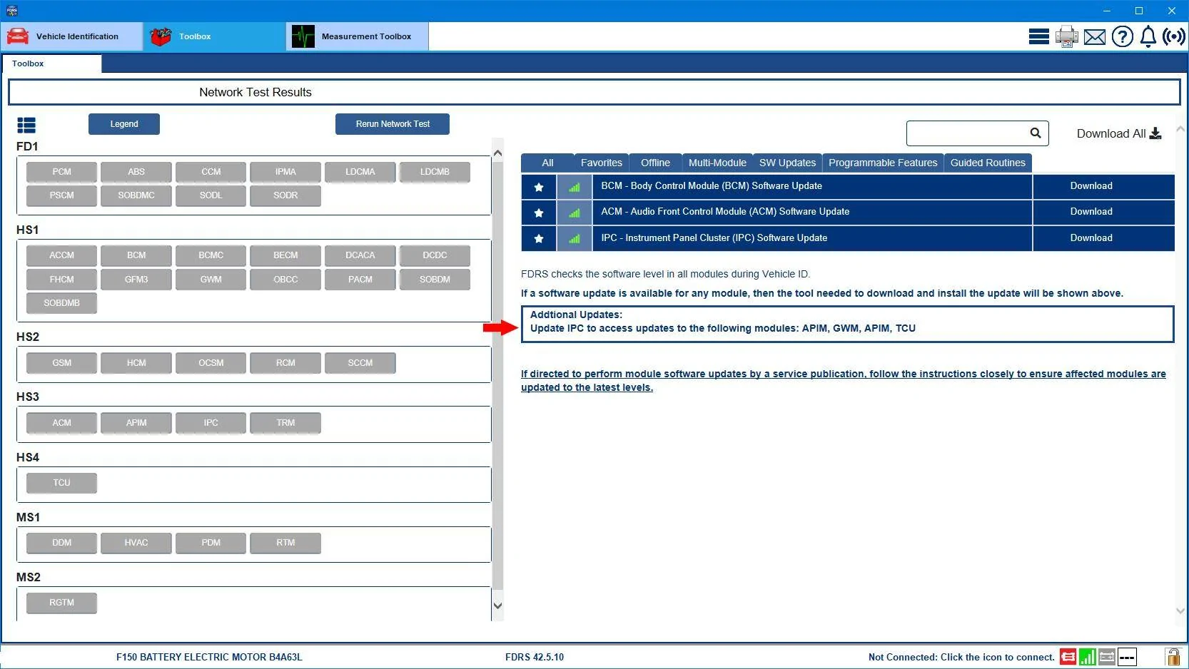

So for those who haven't updated to FDRS 42.5.10, there's a new noteworthy feature that provides 'dependency clues' for some of the updates. And it's pretty useful info.
Here's an example from a VIN I ran this morning:
Ford F-150 Lightning ECU module programming guide using FDRS FDRS_Feature
We can see from the note that doing the IPC will unlock other updates, that when performed in sequence will bring the Sync system current (in this case likely all the way to Sync 1270 which is the latest so far).
Much better than hiding these notes in random TSB's that don't get completely read. Probably the most useful thing I've seen them add them add to it in terms of pointing techs who many not know this in the right direction.
