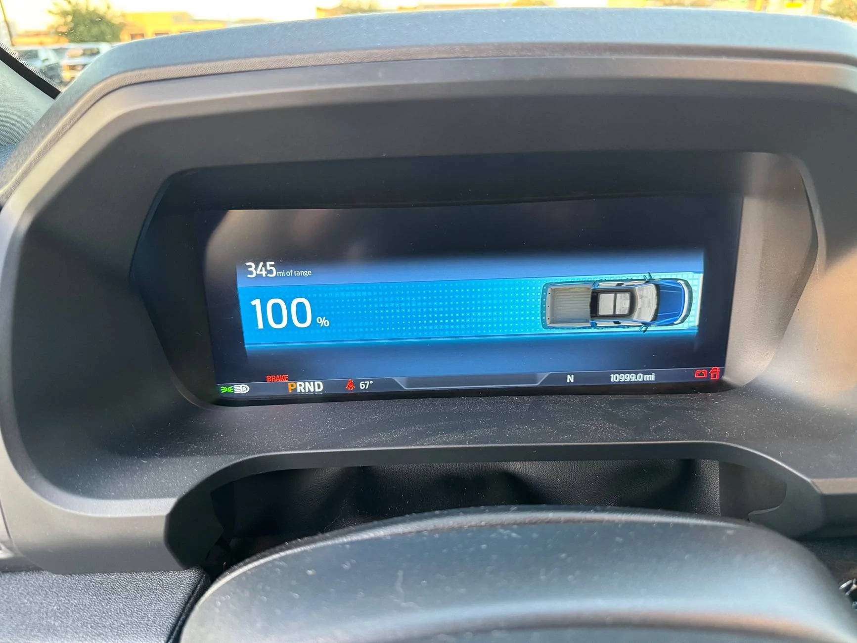

Just to make you feel bad🤣😂🤣
This was last week when it was about 75° for the high my miles per kilowatt hour were between 2.5 and 3. Cool front came through low 60’s high and today it was closer to 2.0.
If you go to your settings on your touchscreen and put it on this trip, it will tell you where your energy is being used. I.e. climate, driving, exterior temperature and/or accessories.

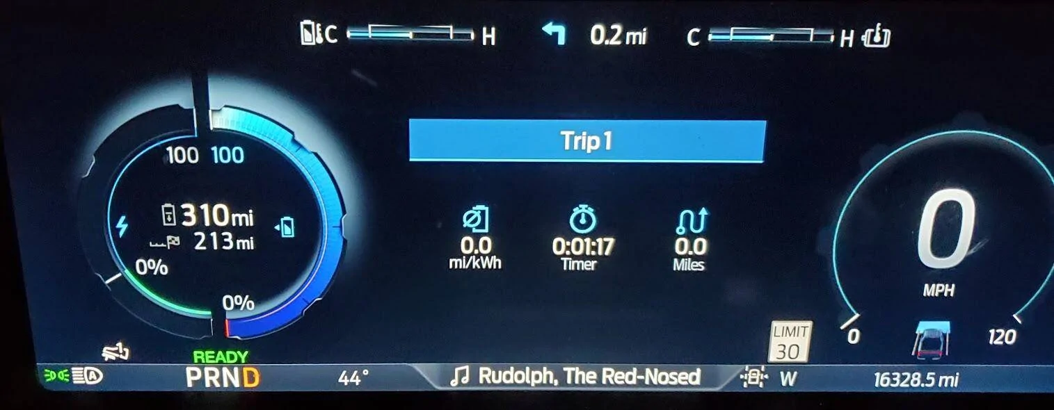

Here is a snapshot from 2/29/2024 when I was preparing my Lightning Lariat-ER for a cold weather road trip. This involved charging to 95%, then preconditioning the battery pack for long distance journey and topping the battery to 100% in the final hour before rolling down I95

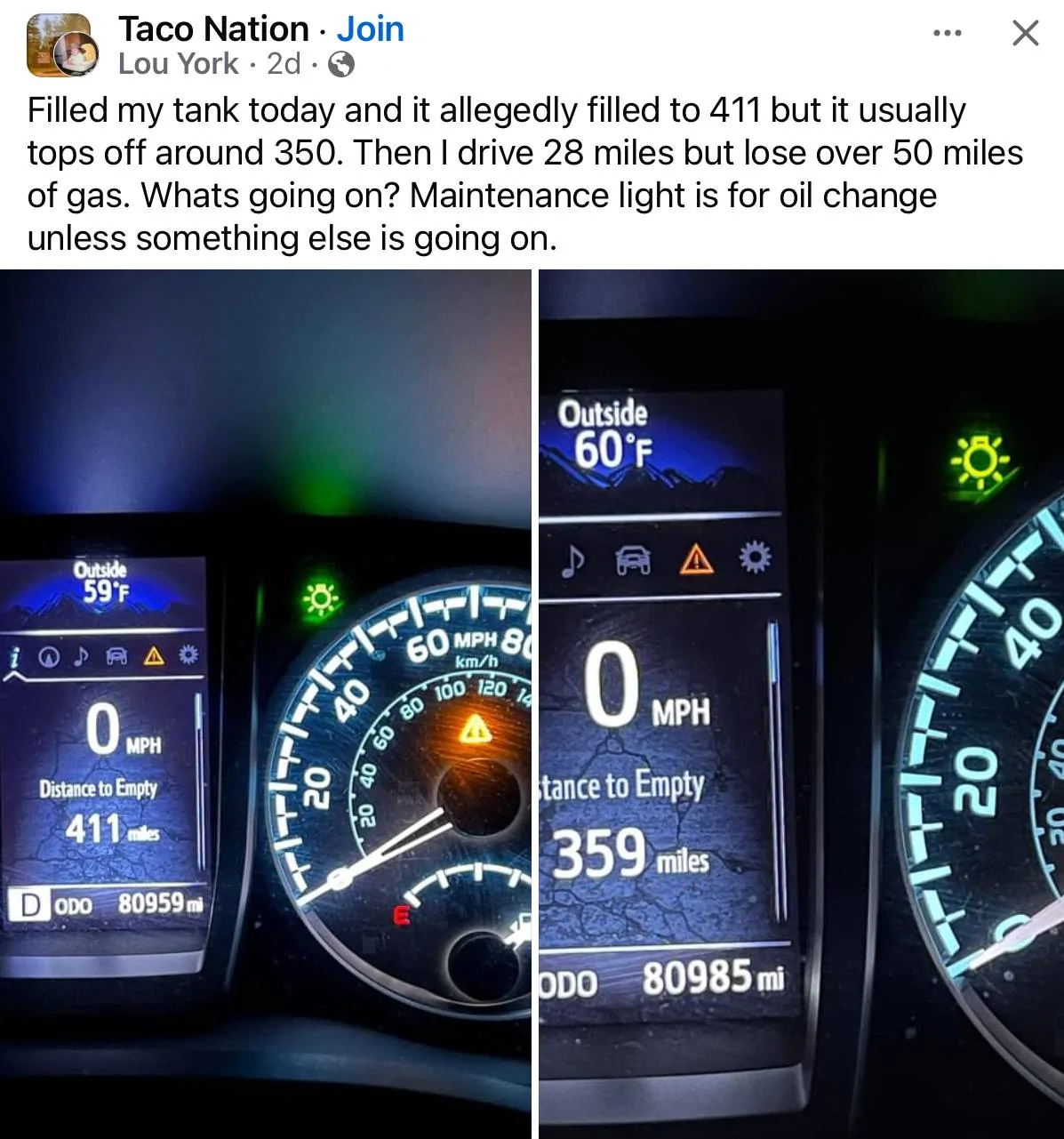

Yeah, my Ram didn’t get 15/22 either.
Only vehicle I've ever included the "tenths" in when I told people what I was getting with the HEMI... "Not just 11, that would be terrible, it's 11.6 miles per gallon". Don't miss that fuel bill.

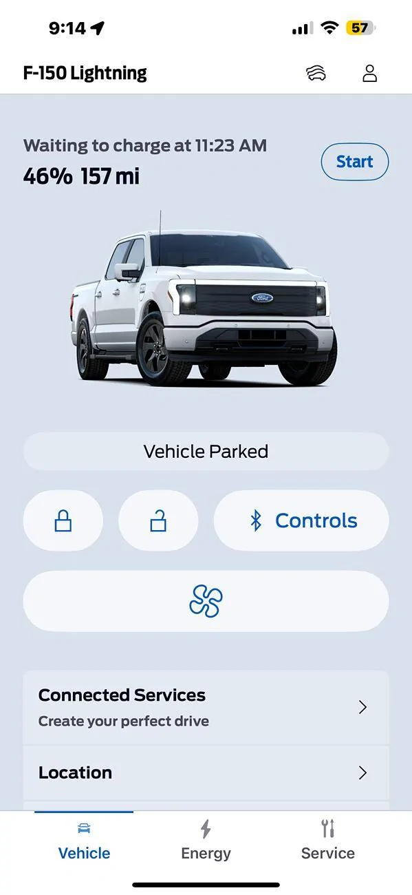

The result from 105 miles of driving in the last two weeks, ~50% of it at 60 to 65 mph. As @TaxmanHog suggested, you don't have to charge to 100% to get the GOM mileage. 157 mi/46% = 341 miles on a "full tank."
Ford F-150 Lightning Extended Range 320 Miles??? IMG_1117
As others have pointed out, it's the terrain, the temperature, and how you drive. I always gently accelerate, drive in 2PD mode with the standard drive settings, and strive for 100% regenerative braking. If you enjoy the power of the vehicle, letting it out and leaving others amazed, you ain't gonna get the 320-mile EPA rating. If I only do street driving, I get my GOM as high as 375 miles on a full charge (~2.9 kWh/mi). It's been 70° to 85° F here most of the last few weeks so that probably helps a bunch.
If you want to monitor how you're doing, set your dash to the My Trip view and pick This Trip for the view you want displayed. It will show you the computed kWh/mi for the trip in progress, and you can watch the rating go up or down depending on the various driving parameters, your acceleration, braking, etc. You can see if there's anything to improve about your driving style, preconditioning, etc., that way.
