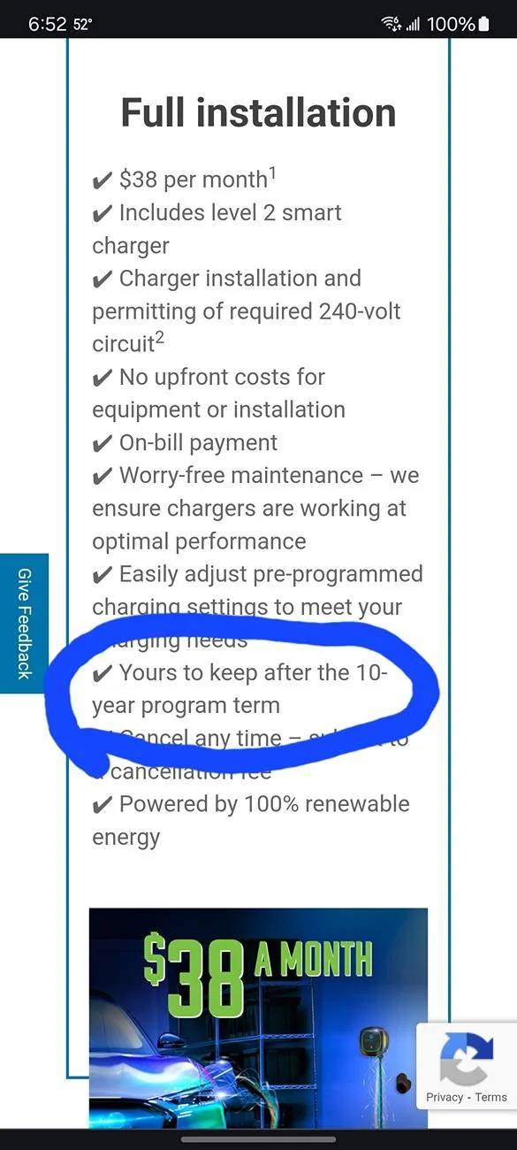

I missed the unlimited charging part. For the $38 plan the break even points is about 253kWh. Its about 206kWh for the $31 plan. Put another way, if you drive more than 500 miles/month it's a good deal.
I'm not from Florida so I'm getting my information from the FPL website. The screenshot below seems to indicate it's a 10 year program.
Can you cancel and send the charger back? The threat would be if you were locked in for five or 10 years.

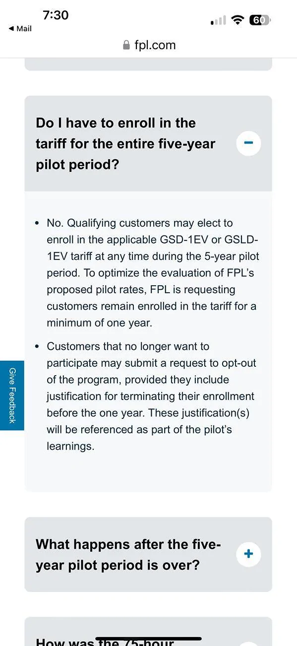

In my region it’s only a 5 year program. Perhaps in the other FPL region it’s 10, or it has been changed to 5 years?
You can cancel the program, but it seems to be decided on a purchase basis of one year.
I just went to fpl.com evolution website and looked at the frequently asked questions.
I’ve been using the program since December. Average kilowatt hour prices are about 15.5 cents per kilowatt hour if you don’t have the evolution program.
