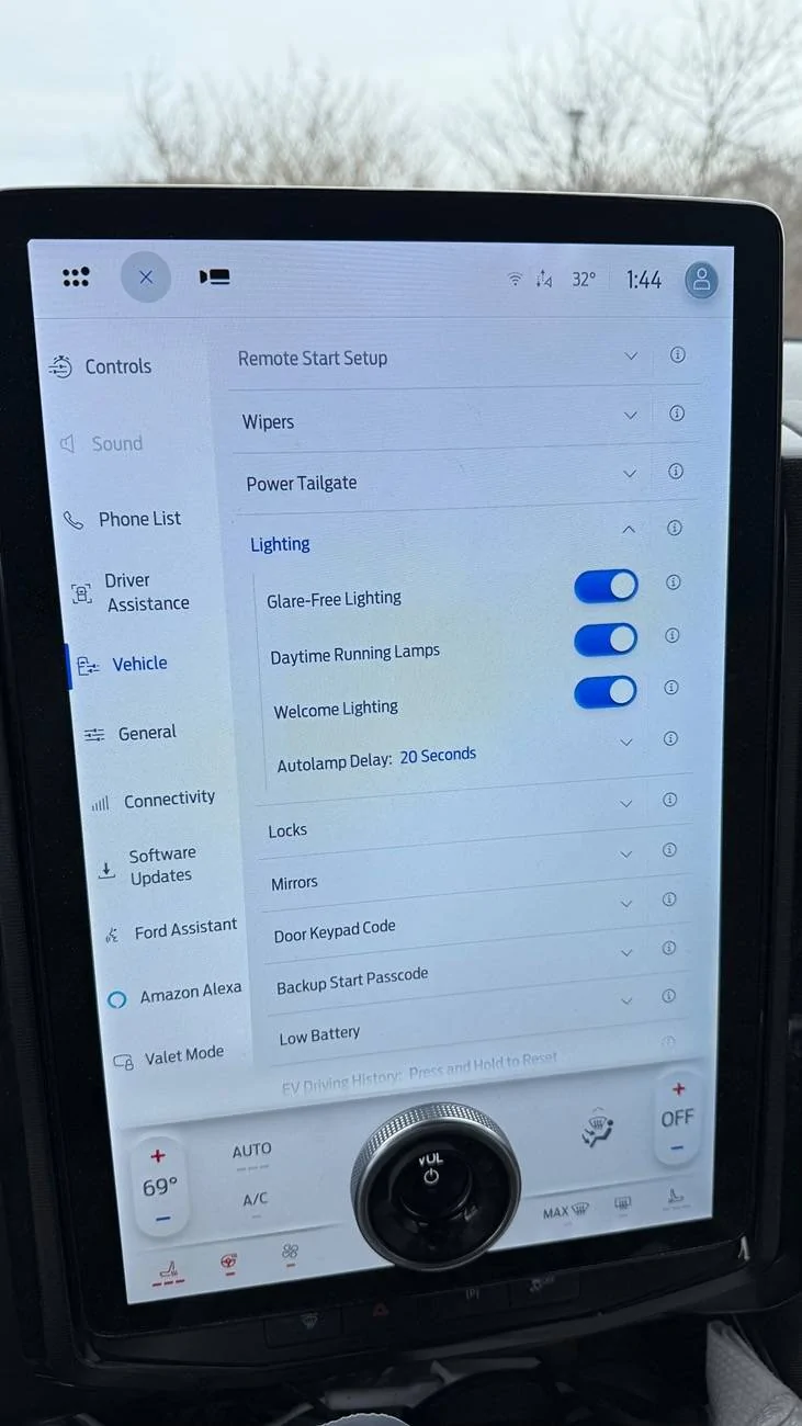

Forscan glare free mod resulted in losing "Sound" from settings menu. see before and after photos..... any ideas? thanks....
Your radio is off in the second picture. Turn on some music and then try. The sound menu is unavailable when there is no audio playing. Not a Forscan thing.
