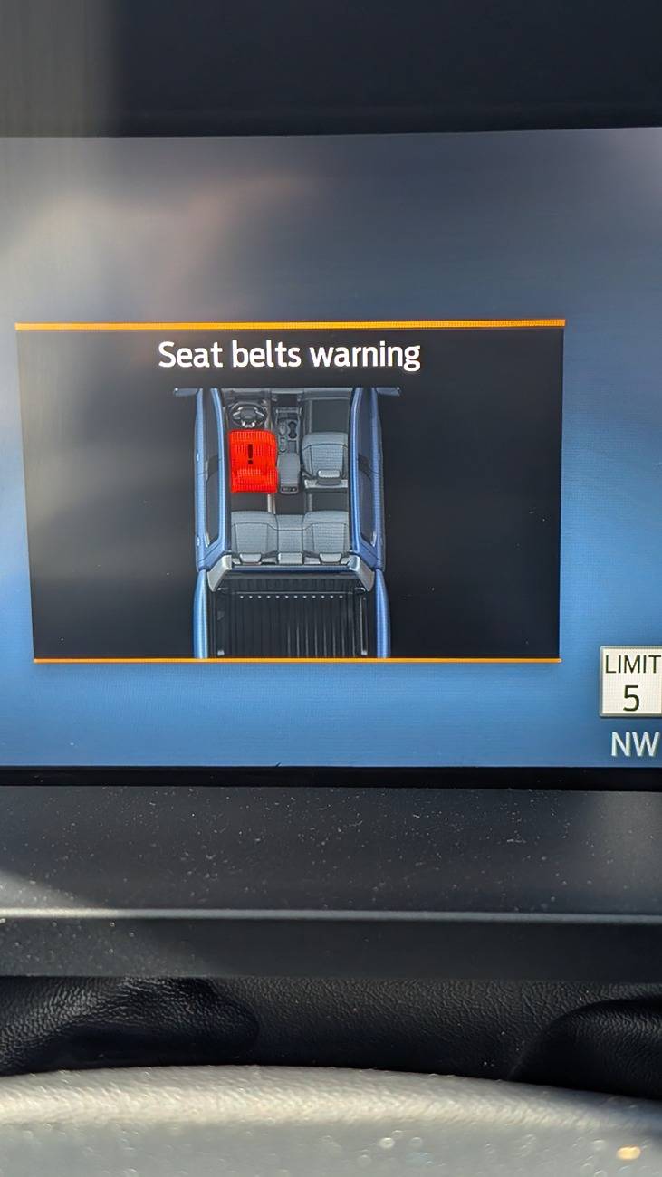

Hey guys I have a 2024 Lariat ER. Just downloaded for scan today. I started to attempt to play. The first change I tried doing was removing the seatbelt chime which was unsuccessful. I followed the code that is listed on the first page of this thread and it did not work.
Any suggestions? And to clarify this is the turn off the chime so that it never goes off even if you are driving right?

You don't need FORSCAN to get rid of the chime. There is a procedure to do it in the owners manual. And yes, you'll never hear the chime.

The issue with this is then you can't access any screen on the gauge cluster. Your stuck with just this screen.
Not true. I don't have that screen and my seatbelts have been turned off using the procedure in the manual since the day I bought it.

Okay I figured out how to fix this issue. You can use Ford's method to disable the chime. But now to disable that pop up and the blinking red seat belt light on your dashboard use the following code:
Before
IPC - 720-13-01
IPC - 720-13-02
IPC - 720-14-01
IPC - 720-14-02
Change to all zeros and let Forscan correct the checksum.
No light for driver or passenger.

So mine did go away after locking the vehicle and unlocking it. So yes you are correct but it did not get rid of the blinking red light which then I found the code for.
