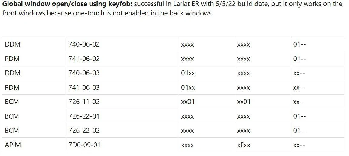

Hello, I have a quick (albeit probably dumb) question, just to make sure I'm doing this right. I have made the backups and changed a couple of settings but regarding the glare free forscan mod.
I know where there is an "x" you leave that value alone, and only change the numbers noted. example:
DDM 740-06-02 xxxx xxxx 01--
what about the dashes after 01, do we leave those unchanged as well? I assume so but just wanted to be sure. Thank you!
Yep, don't change those
2,896
4,119
Thank you! I literally just found another question on this forum just like mine! :)
Ha, if you really search you will find 10!
They are check digits and FORScan will automatically change them. It will give you a warning that the check digits don't match when you change something and hit save. But you can ignore since it will do the checksum math for you.

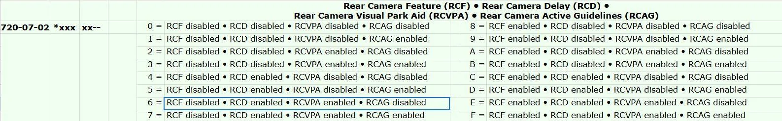

I'm curious though because I could have sworn when in Reverse, the backup camera had guidelines but I noticed they were now missing (I may be going crazy). Since it seems like you have the same "edits" I do I'm curious if you still have those guidelines as I may have messed up something along the way - or I'm imagining things.
PJnc284
Sep 30, 2024
923
997
Garner, NC
I still have my guidelines. I would check and make sure nothing was fat fingered. What do you have in 720-07-02 for the IPC? The first digit apparently controls the guidelines
