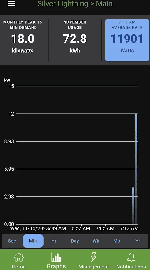

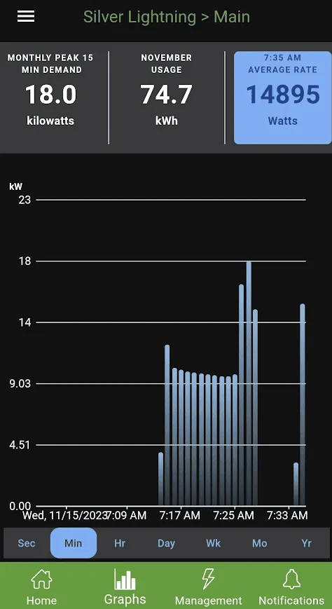

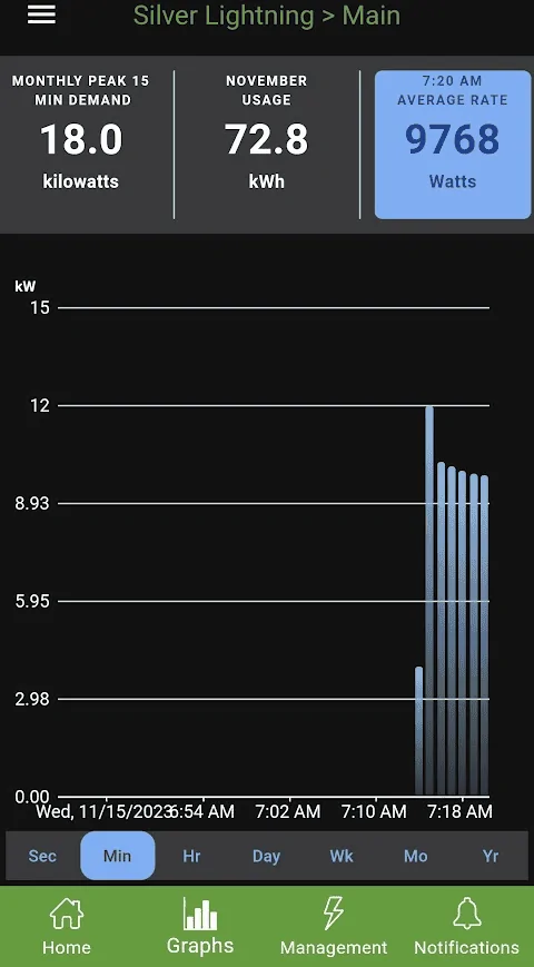

Expanding on this question, here is the results of my plugged in pre-conditioning test yesterday, at the time the outside temperature was ~30° I set the departure time for 8:00 am, the truck determined that it should begin the conditioning process at 7:14am at the time my SOC was 90% from Tuesday's charging session.
This is a screen grab at 7:15 am when peak energy was established at 11.9KW, soon after it slowed to apx. 9.8KW
Ford F-150 Lightning Ford's Important Tip For Driving Your Lightning in the Cold: Preconditioning / Pre-Heat Your Battery 1700150562154
Ford F-150 Lightning Ford's Important Tip For Driving Your Lightning in the Cold: Preconditioning / Pre-Heat Your Battery 1700150603455

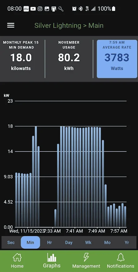

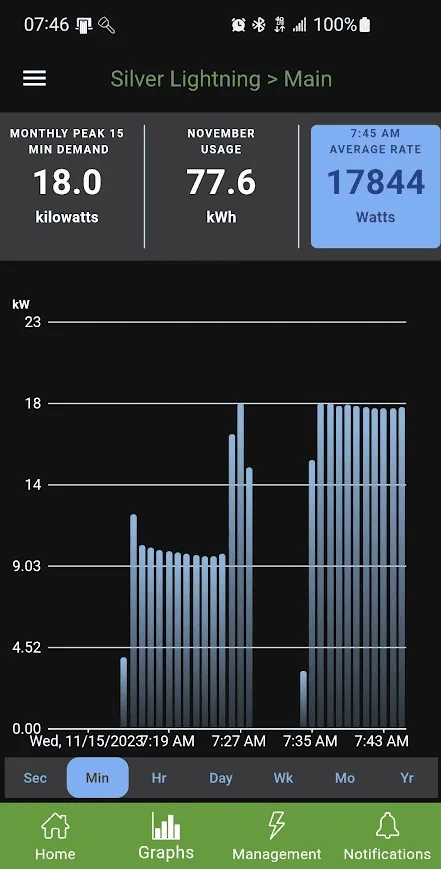

The initial session reached a peak of 18KW then paused for a few minutes, then started up again, the battery got a tiny [1%] boost to 91% during this period while the majority of energy was used to by the PTC to warm the battery earlier.

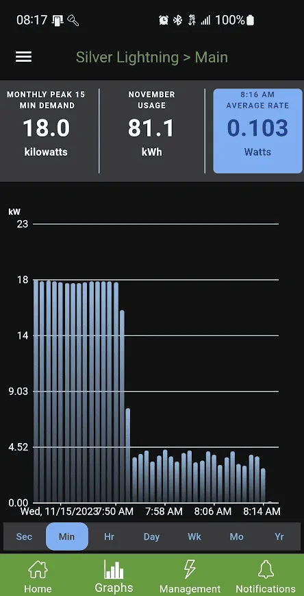

These shots are from 7:45 when energy was flowing at the rate of 17.8KW, then 7:59 just before departure goal is to be reached, note for several minutes prior to this point the rate of energy consumption slowed to 3.8KW, basically idling the PTC and running the cabin fans. After idling for 15 minutes the pre-conditioning phase stopped and the truck shut off ~8:16 am

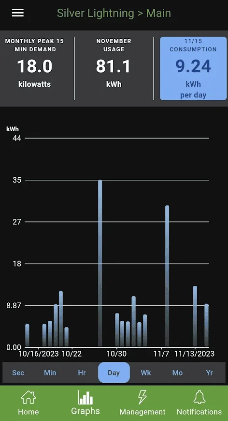

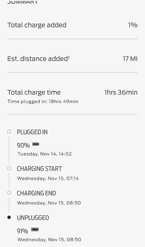

This is the total energy consumed to condition the pack & cabin include extra 15 minutes of idle time, 9.24 KWH, the SOC remained at 91% during this phase, but notice the extra range of 10 miles due to warmer battery.

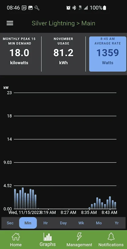

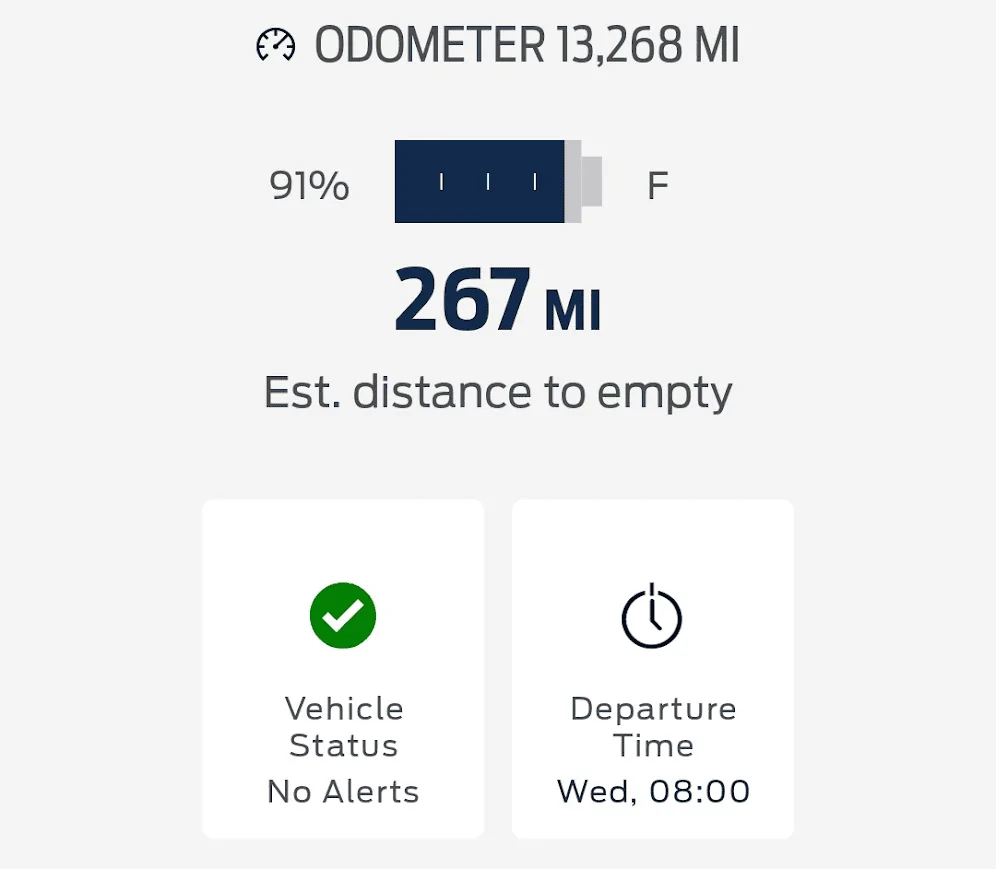

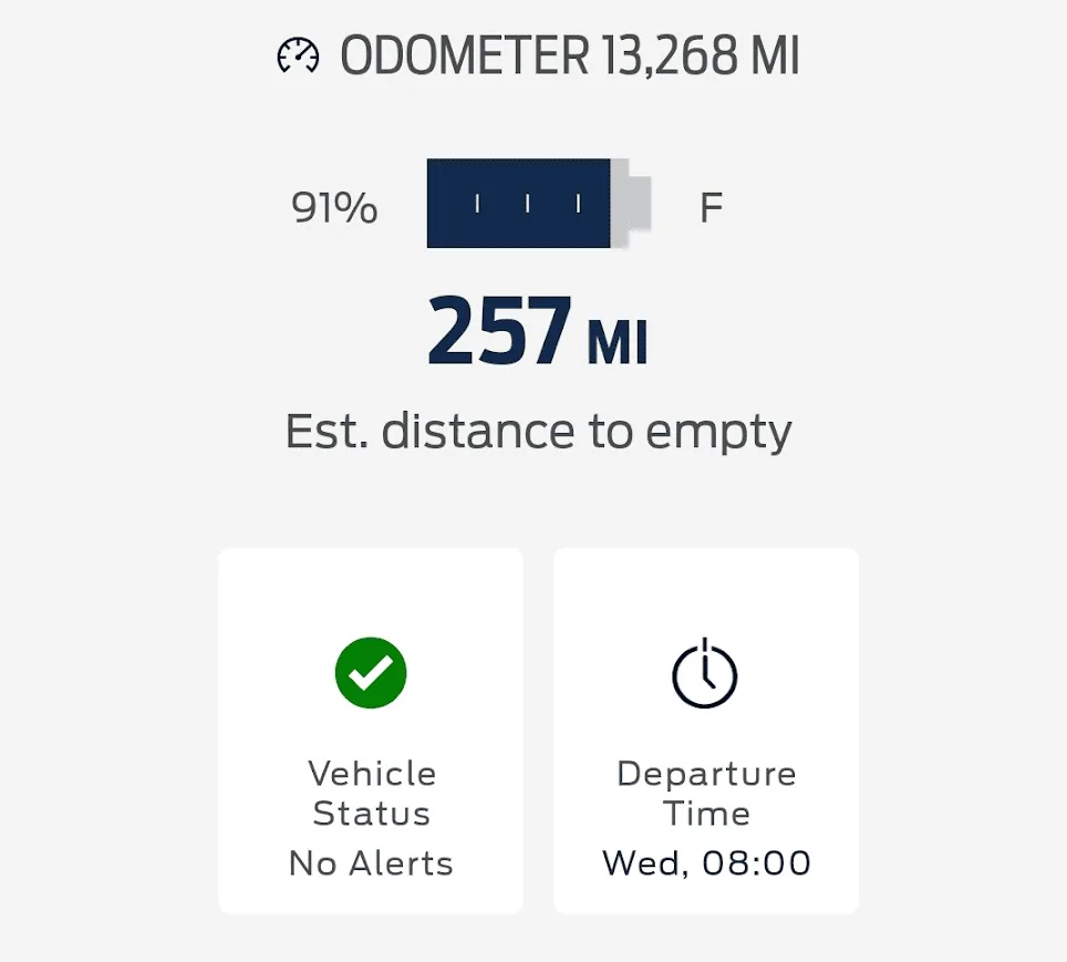

Our actual plan was to leave at 8:50 am, so I let the truck sit for 15 minutes, then initiated the Remote Start @ 8:35 am, to do the last phase warming the cabin, seats and steering wheel. After I unplugged the truck at 8:45, it reported I had consumed 9.7 KWH of energy in total for a cost of $2.90

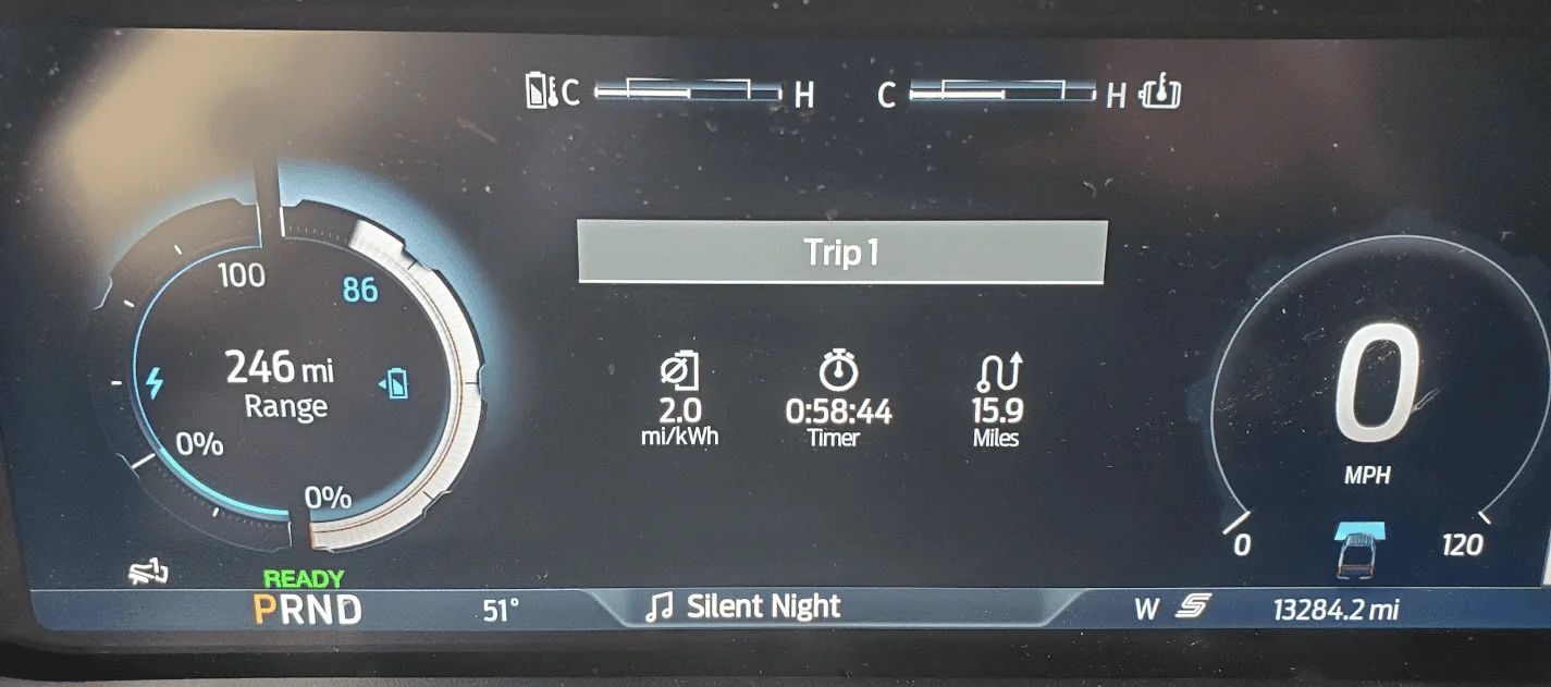

Our day of short trips, amounted to a whopping 16 miles on Wednesday, this was over 6 start/stop cycles as we made various visits, ending at 86% with a remaining range of 246 miles.

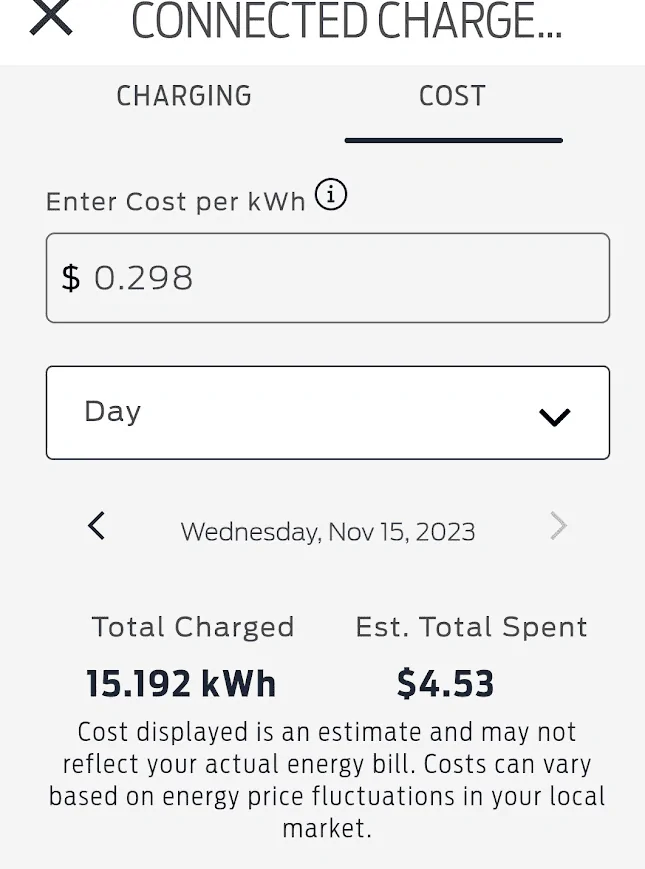

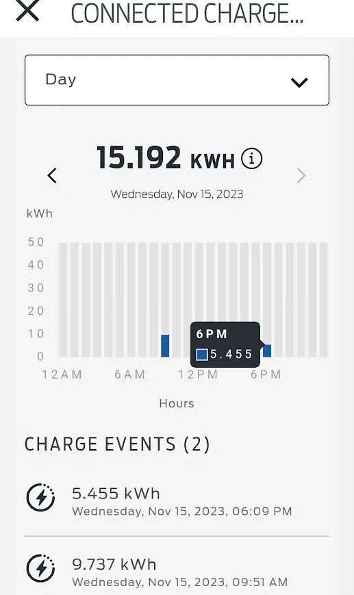

The replenishment charge at the end of the day was 5.5 KWH, grand total energy of 15.192 KWH or $4.53 to travel 16 miles at a rate of 28.3 cents a mile, about what it was costing me in the old PSD F250, so for SHORT HAUL trips, the battery condition effort is a huge waste of energy. A simple remote start 10-15 prior to leaving will get your cabin comfortable at a minimal hit to energy if unplugged and if plugged in preserving the minor range impact.

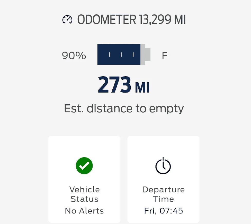

At the end of todays travels, I completely deleted the Thursday morning setting and built a new one for Friday morning in the truck, IIRC some folks have had better experiences creating it in the truck and not trying to edit it with Fordpass, technically we should be able to do that without issue, but I suspect something get's lost in the transmission, so I'm not touching it in Fordpass now that it's set.
While tinkering with the parameters for Friday (in truck) I noticed that once it's created and saved, if you try tweaking it (I forgot to set the WARM setting) that the save button remains disabled, so I cleared the settings and re input the time and condition values I wanted, saved and will leave it alone.
FIngers crossed for a good result Friday morning!!
