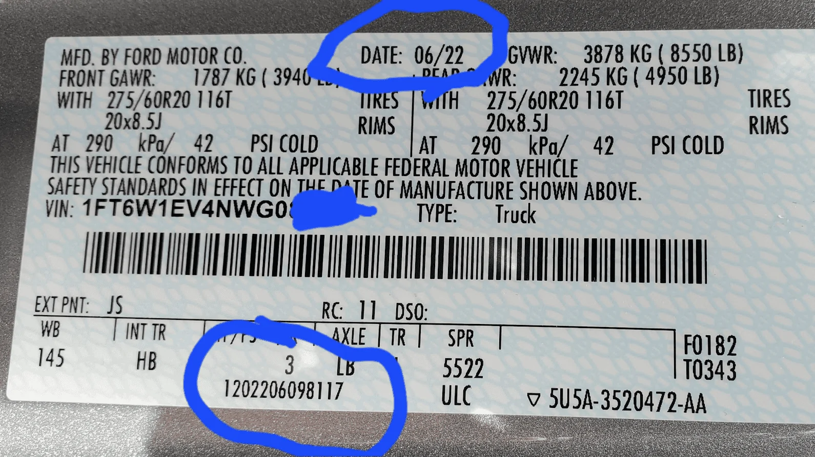

I didn't see any mention of tire pressure. Under-inflated tires have a larger contact patch and more rolling resistance, right? What is the ideal tire pressure for the stock all season tires?
183
13,701
14,734
42 psi
42 lbs. on my Lariat ER Max Tow with standard All Weather tires.
Itā€™s on the driver door frame.

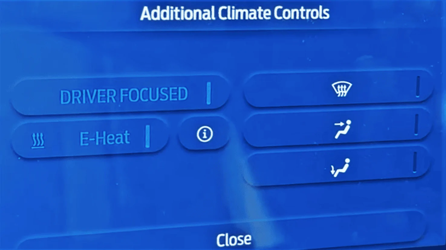

If "E-Heat" is turned off, does that stop Watts being used for heat? Ford info says e-heat is only source of heat!
additional climate controls showing e-heat for xlt or pro Screenshot 2023-07-30 221030.png
Yes, that is the only source of heat. If that is turned off, there is not heat and electrical usage.
