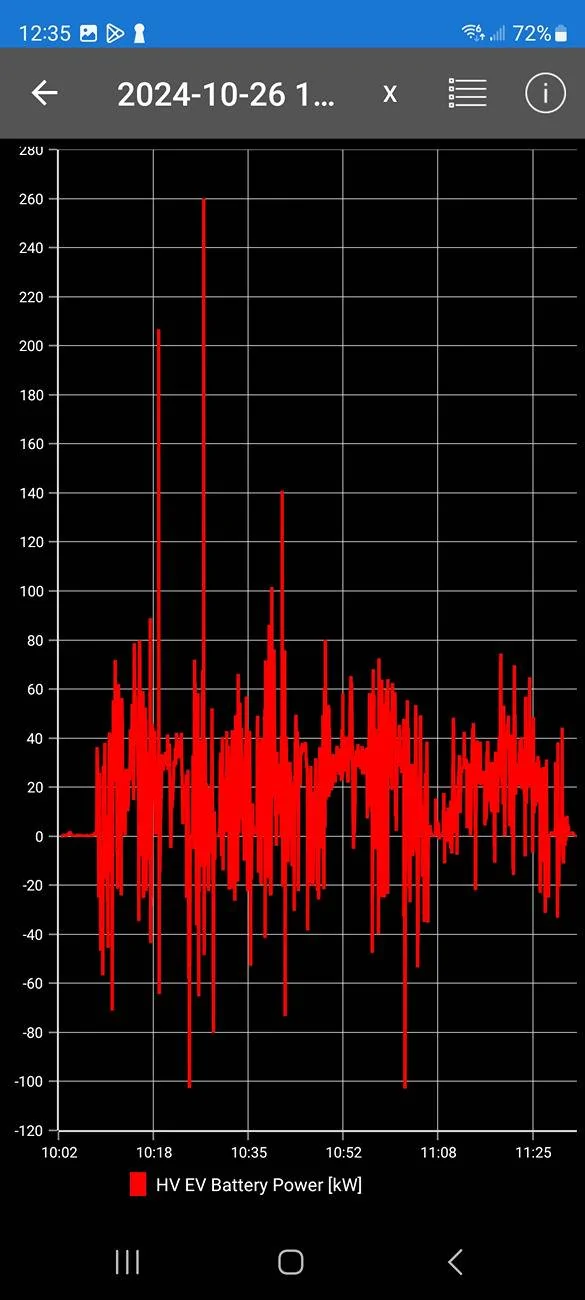

This is power going in and out of my battey in 1.5 hr drive on a warmer day. I don’t believe Ford limits any of these in cold days. You can see regen is like DCFC hitting 100 KW. and in one occasion acceleration pulled 260 KW. I don’t remember how much flooring it pulls. Just wanted to give you some numbers for reference.

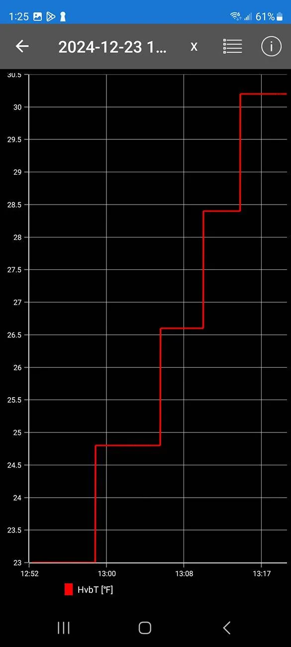

I just did a 25 min drive. I put a DCFC in the navigation and this is the change in my battey temp. I think a little rise may be due mostly to driving (acceleration and deceleration) not Navigation but I can't think of a way of knowing for sure other than repeated experimentation.

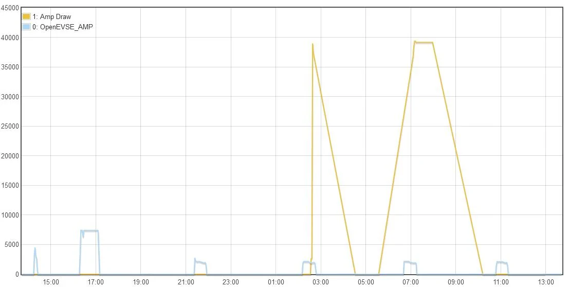

What I find fascinating is that different manufacturers have different guards in place. We have two OpenEVSEs, and I am able to tracks the power output. The F150L doesn't take a little bit at a time, it just warms it up at the full 30+Amps for X minutes and turns itself off. While my Wife's Bolt take a bit each time every few hours.
Outside temp ~5F.
The first jump is heating up the battery pack, while the second large jump is the pre-con.
EDIT: I just realized that some of my values are off regarding the AMP draw. Regardless, my Wife's Bolt conditions more frequently regardless.

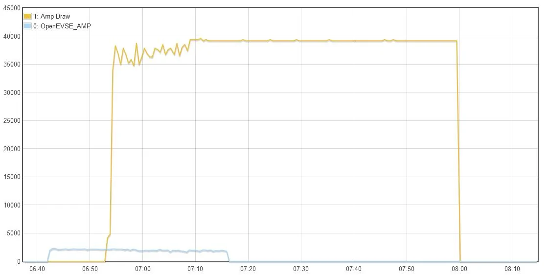

This is the pre-con zoomed in:
