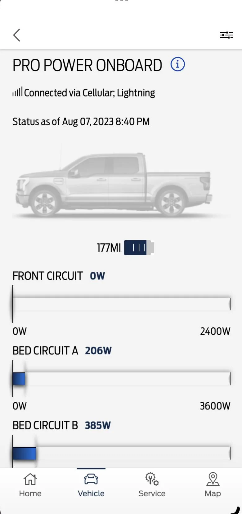

The thunderstorms that moved through the east coast this evening knocked out our power about 7:30. This is the first long outage I’ve had since installing the switch and it is working great three hours in. I forgot to turn off the auto shutdown timer and it is still on. Did one of the recent SW updates remove the shutdown timer when ProPower is active?
Our power came back at 4:43 am and I got up and switched back to the grid at 5:24. Wound up using just under 12 kWh for the approximately 10 hour outage. I did forget to turn off the auto headlights so some of the energy was wasted lighting up the garage. Plus my wife got a good laugh when she checked the security camera video of me wandering around the garage in my underwear this morning.
One other observation. The ground fault detection on this truck is super sensitive. The Generac uses a solenoid to throw the switch and it creates a fault almost every time that trips the breaker in the truck. I have to connect the cable, turn on the ProPower, switch the transfer switch, and then reset the breaker in the truck. It even trips it when I switch back to grid power.
