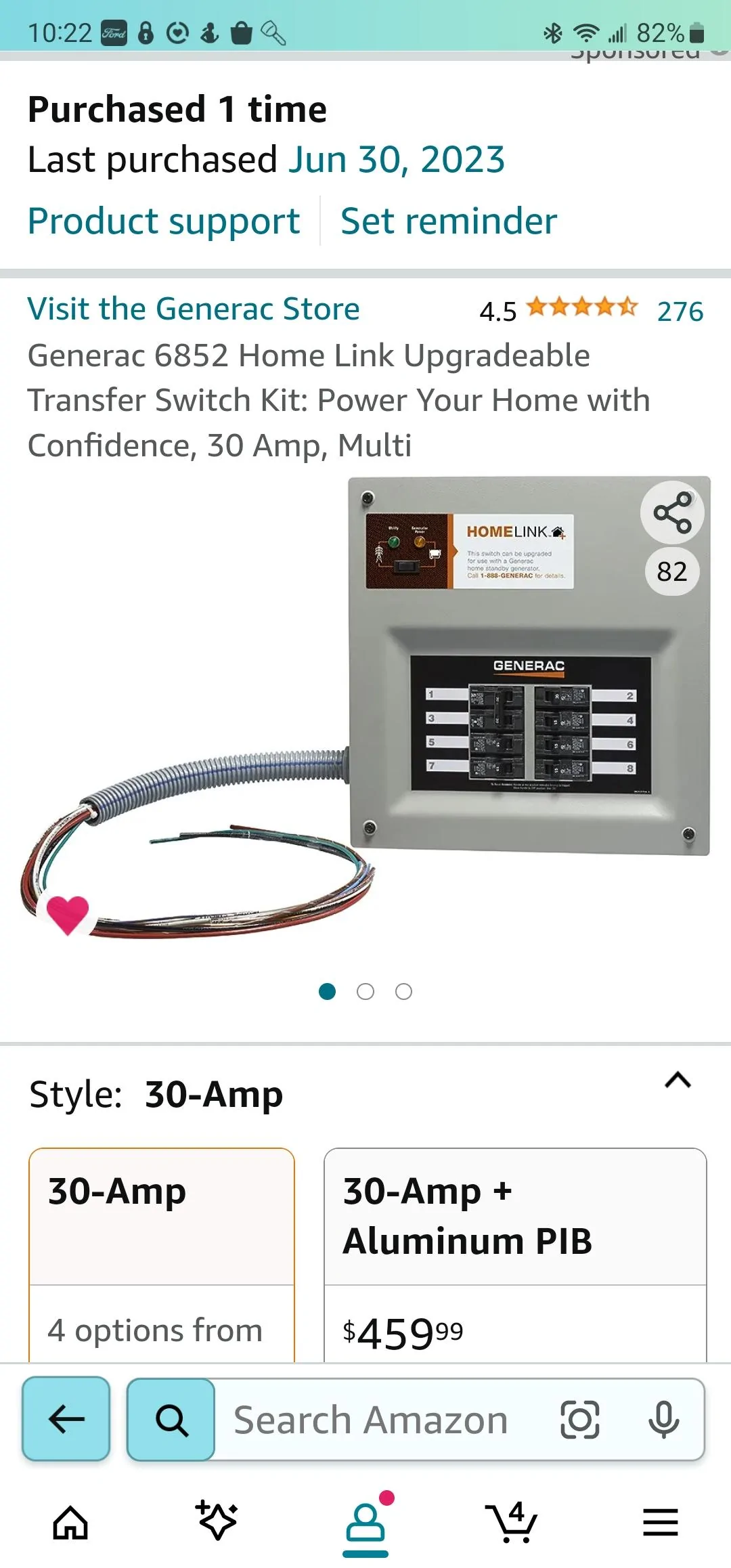

My electricians installed my Generac 6852 30A TS and I am getting the same results. The truck immediately faults when we go to use the backup feature. Someone on this site said that it's just a simple rewiring of the grounds/neutrals. I hope that they can just rewire it and get it to work. They are coming back out this afternoon.
Ford F-150 Lightning Generac 6852 Transfer Switch installed (to power my house from the Pro Power 240V plug) Screenshot_20230919_102258_Amazon Shoppin
Mine will often fault when the solenoid fires to throw the switch. If I reset it then it runs fine. It will even fault when I throw the switch to go back to grid power. I think the solenoid is inducing enough voltage on the ground to cause the fault. Have you tried resetting the ProPower after the switch is complete? If that doesn’t fix it then double check that you picked the correct neutrals to match the breakers you moved. I have two circuits that enter my panel through the same strain relief and when I trace them I picked the wrong neutral the first time. It can be confusing trying to trace out the white wires in a crowded panel.
