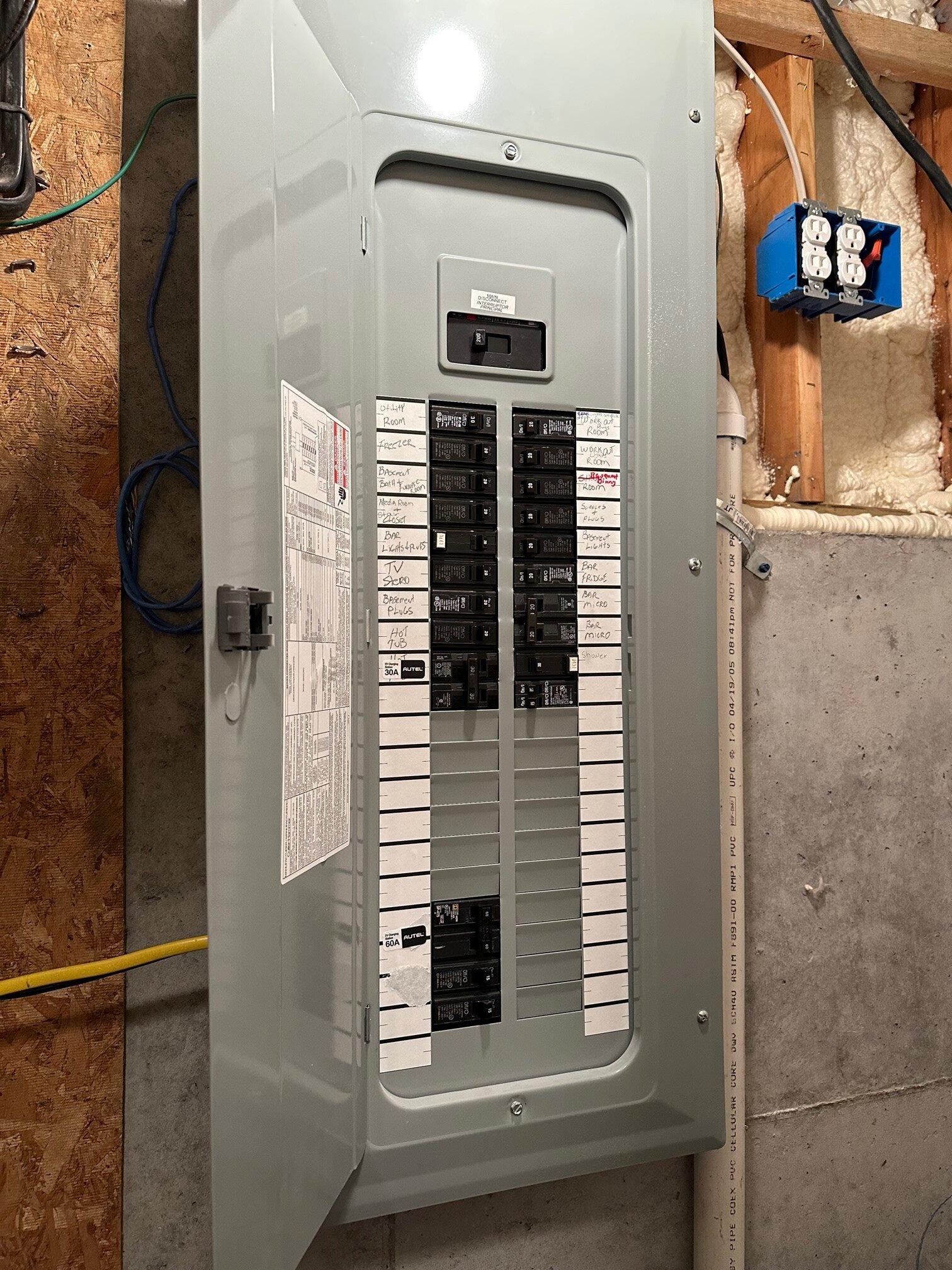

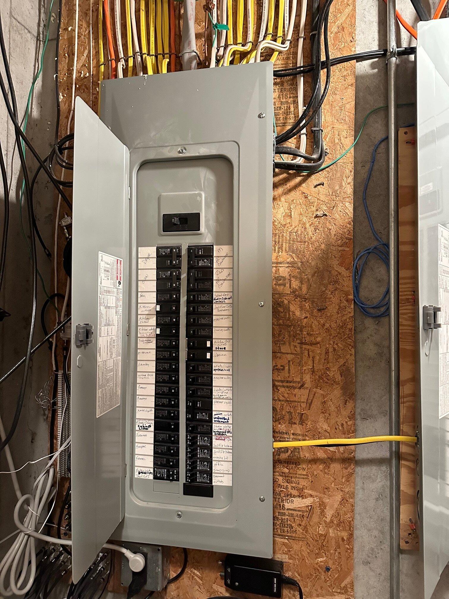

Ok guys. You have convinced me to rethink this. I have a 200a subpanel that is identical to our main panel. Subpanel was installed when the basement was finished and is about half full. It's right next to the main panel and I could easily install a 1" or larger conduit between the two. Subpanel is fed by a 100a 240v breaker in the main panel. Subpanel has the same 200a disconnect breaker as the main panel.
I was thinking of moving my critical loads to the subpanel and then installing a Reliance six circuit manual transfer switch for only the subpanel. My goal here is to be able to leave the main panel on grid power and power the subpanel with critical loads from the Lightning. The main panel would be completely isolated from the sub panel when I connect the lightning.
Any problems with this approach?

Not if everything in the sub will run on 30A even when grid-powered.

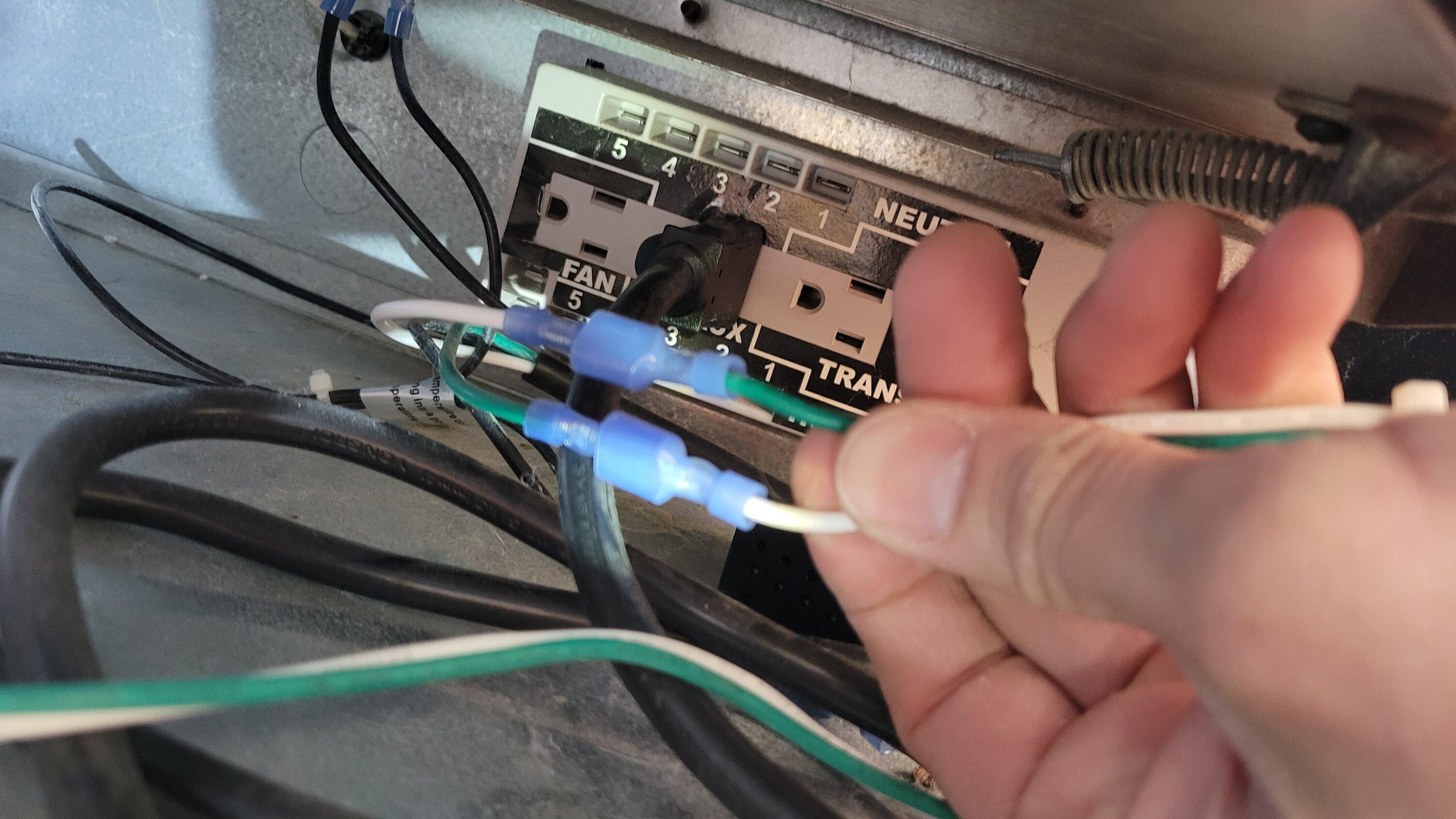

This is what was causing my ground fault issue with the Generac switch panel. It's the wiring for a fireplace fan I installed two years ago. I did way more troubleshooting than was warranted for such a simple mistake but I eventually figured it out. I'm hoping for a power outage soon!🤣
Was this a circuit one that you moved to the transfer switch? I’m also getting a ground fault and need to start searching. Would love to limit my search to just the circuits in the switch.
Originally thought it was due to shared neutral circuits I have but sounds like you have those as well but the system still works.
Yes. I was able to isolate the circuit by checking continuity between the neutral and ground at the panel. Once I figured out which circuit was to blame I figured out exactly which outlets where on the circuit and started inspecting them one by one. Eventually I figured out the fireplace was on the circuit and discovered the miswired fan.
Come up with a troubleshooting plan and methodically execute it and you'll eventually figure it out. It took me a while to come up with a good plan.
Start with all of the breakers off. Turn on one at a time until it faults.
It faults as soon as I plug in the cord to the truck even with all breakers off.
This has been extremely frustrating because the Generac documentation is very minimal at anything to do with troubleshooting.
Does that TS switch the neutral? If not, that’s your problem.
