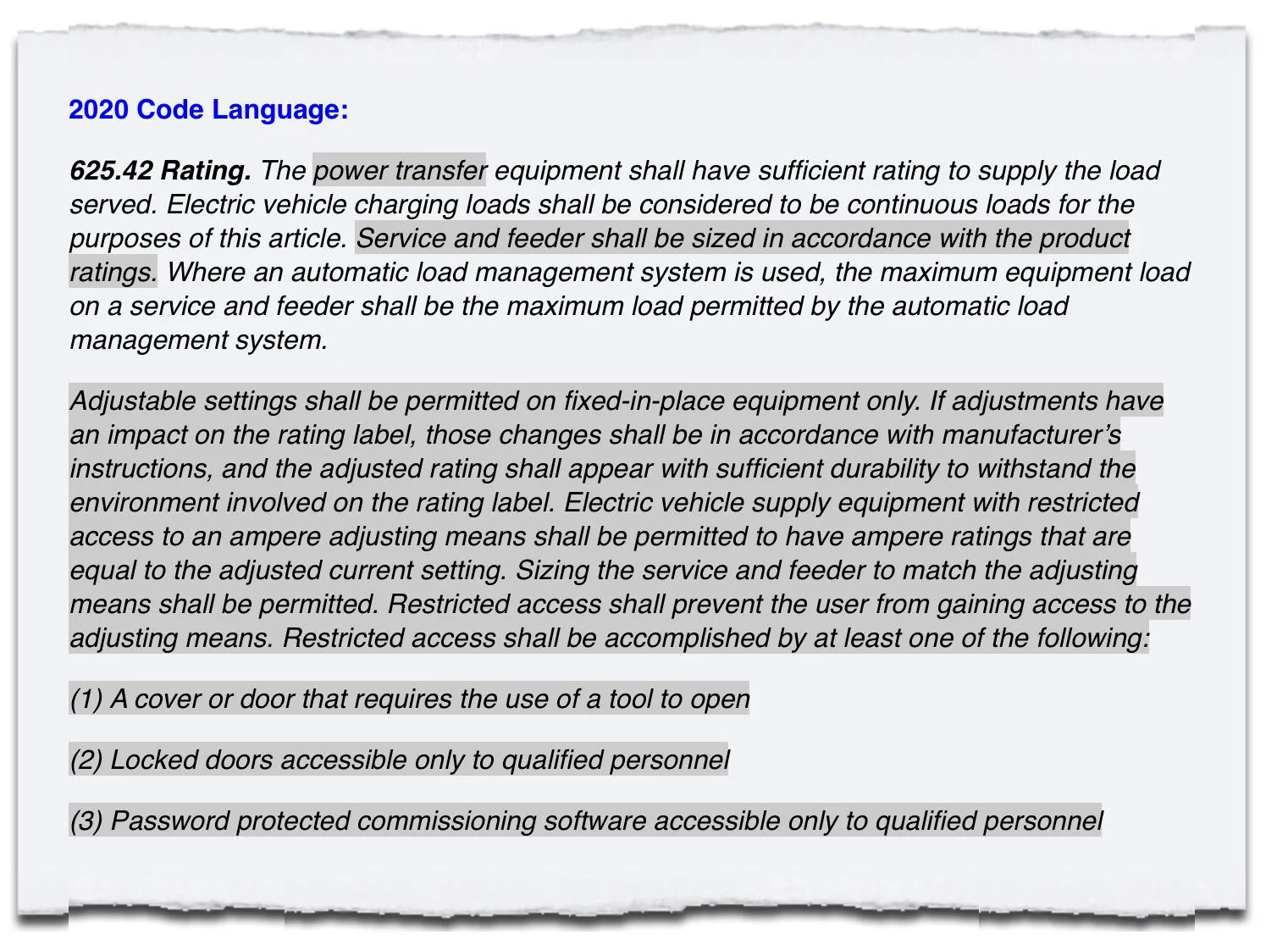

" ChargePoint Flex allows me to easily adjust amperage from the app too."
I think the NEC stopped that. Too easy to over current the install unless there is some other dedicated limit that software can't override.
4,193
5,559
Prior to the 2020 NEC, this wasn’t really addressed. Here is the new language for 2020:
Ford F-150 Lightning Get ready to charge your F-150 Lightning™ -- email link from Ford 88459BEA-BFB3-4520-906B-36B0BBF56DD7
It basically means that the highest user-selectable software setting must be hardware-limited to the associated circuit ampacity. If an EVSE isn’t capable of a hardware limit, the circuit must be capable of the maximum rating. It does not outlaw software control.
Only a handful of states have adopted the 2020 NEC.
