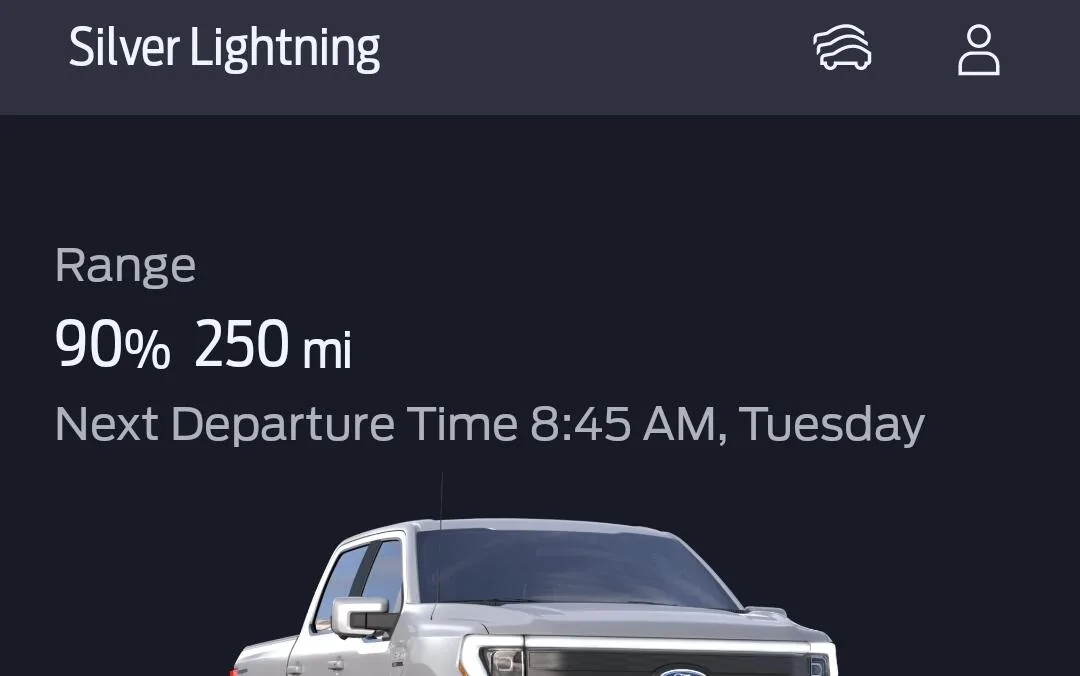

So I feel like this may have changed recently. When I charge to 90% and it's been in the 20's to 30's at night, my truck will say my range is between 265 to 270. I have a Lariat ER so that equates to less than 300 miles. I remember when they did the 'feel good' mileage change to make people feel better. Almost feel like they did a compromise now, better than it actually is in the cold, but not full EPA. I'll have to see what I get next time I charge to 100%, see if it resets to 320.
Agreed, lately the feel good value above 80% isn't as optimistic as last year.
This is today, after topping up to 90%, the past 48 hours I've done a lot of inefficient warm idling and off plug cabin warming sessions so the recent historic efficiency has plummeted, as I expected.

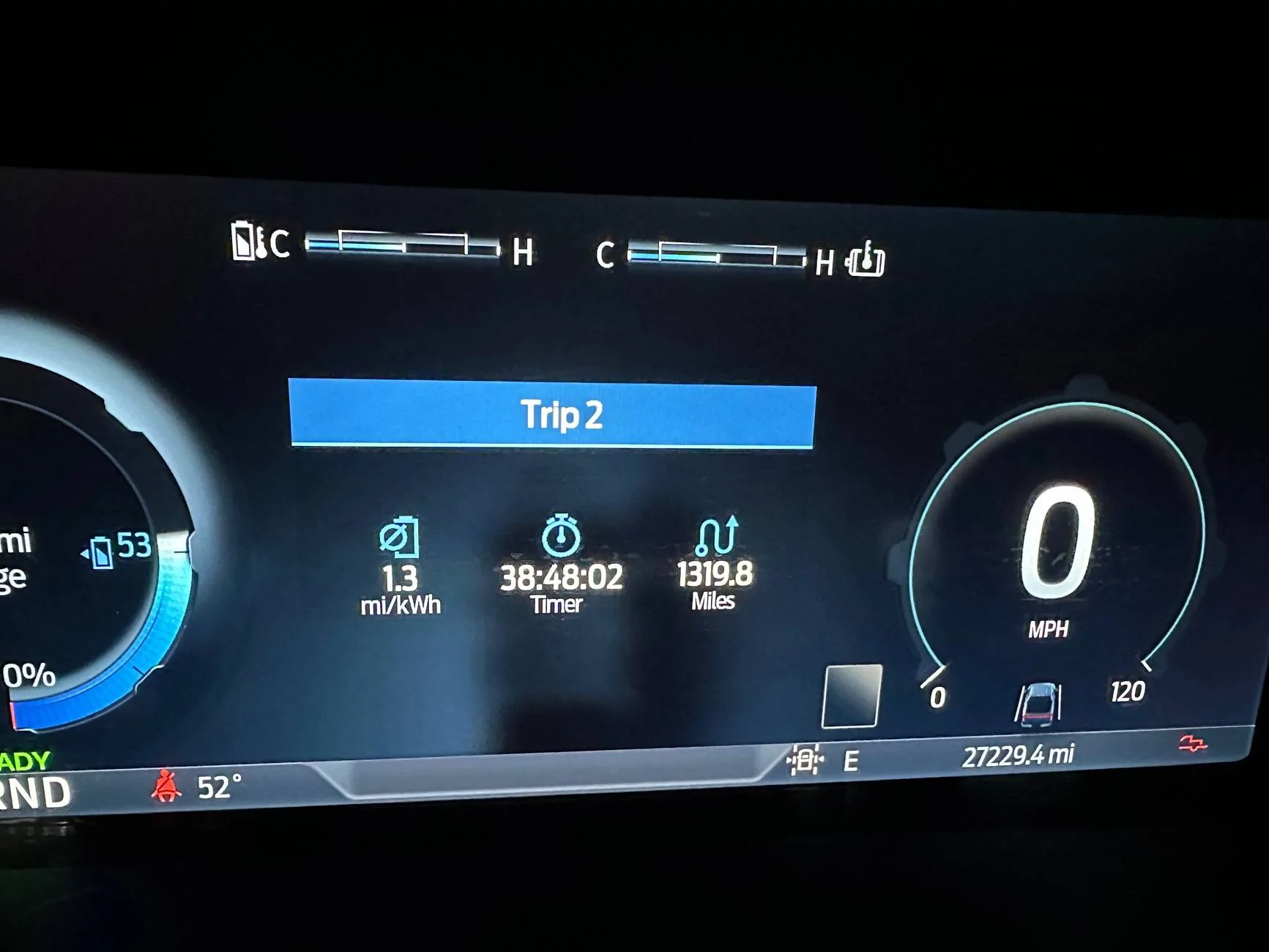

We just did a 1320 mile trip from Kansas City to Red Lodge, Montana via Fargo and across I-94. Coldest temp we saw was -7 on Saturday night. Without the supercharger access and the Level 2 hotel charger in Bismark I believe the trip would have been impossible.
Average for the trip was 1.3 mile per kph and we did the speed limit for the most part. ABRP using live data from our OBDII reader was indispensable for giving me the confidence to not charge past 80% for most legs and to go the speed limit.
Ignore the total trip time as we left the truck on overnight to power our 12 fridge/freezers
