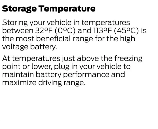

I downloaded the manual from the ford website, but still didn't get great answers. It says to plug in to maintain maximum voltage. What does that mean, so the battery doesn't slowly drain in my garage when not in use?
So to the crux of my question, is there any reason I "should" plug in my car and charge it to 90%? Or am I just supposed to plug it in at night without having it charge just to keep the battery warm? Does it even matter since I park in a garage and it rarely gets below the low to mid 40's inside our garage even in winter?

I haven’t seen “plug in to maintain maximum voltage.” That sounds really strange.
Here is what it says about plugging in (other than when charging):
Ford F-150 Lightning Ideal Charging Practices ? 3E35F1A0-491D-4719-8814-0C7B237428E5
You shouldn’t need to plug in other than to charge given your warm garage.
