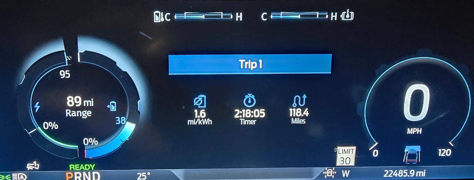

The road trip last night was uneventful, no codes, wrenches or poor performance, with the well conditioned battery and cabin, the first half of the trip ran efficiently at 1.8 MPK, speeds were 65-70 mph mostly highway, as the evening concluded my ride home averaged 1.4 MPK under colder conditions 25° along the reverse route.
Round trip average 1.6 MPK

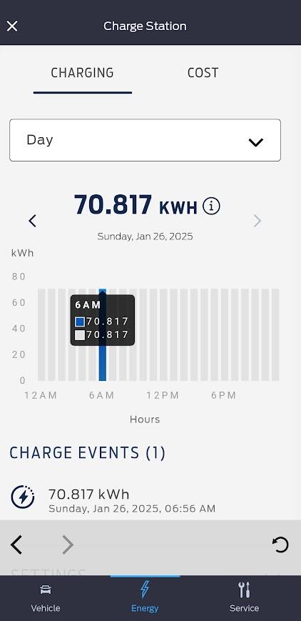

Sunday morning woke up to 30°, it got milder overnight, the battery was plenty warm enough from the charging for 4 hours to get to 90%, I didn't need the extra 5% I loaded just in case my consumption rate was below 1.4 MPK.
The charge session had typical efficiency with the heat in the pack at a perfect balance to the cold outside, while driving home I targeted a DCFC, but didn't go there to charge, just to make sure the pack temp was optimized for slow AC charging.

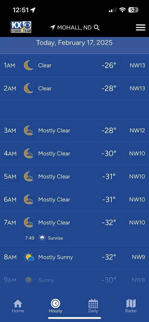

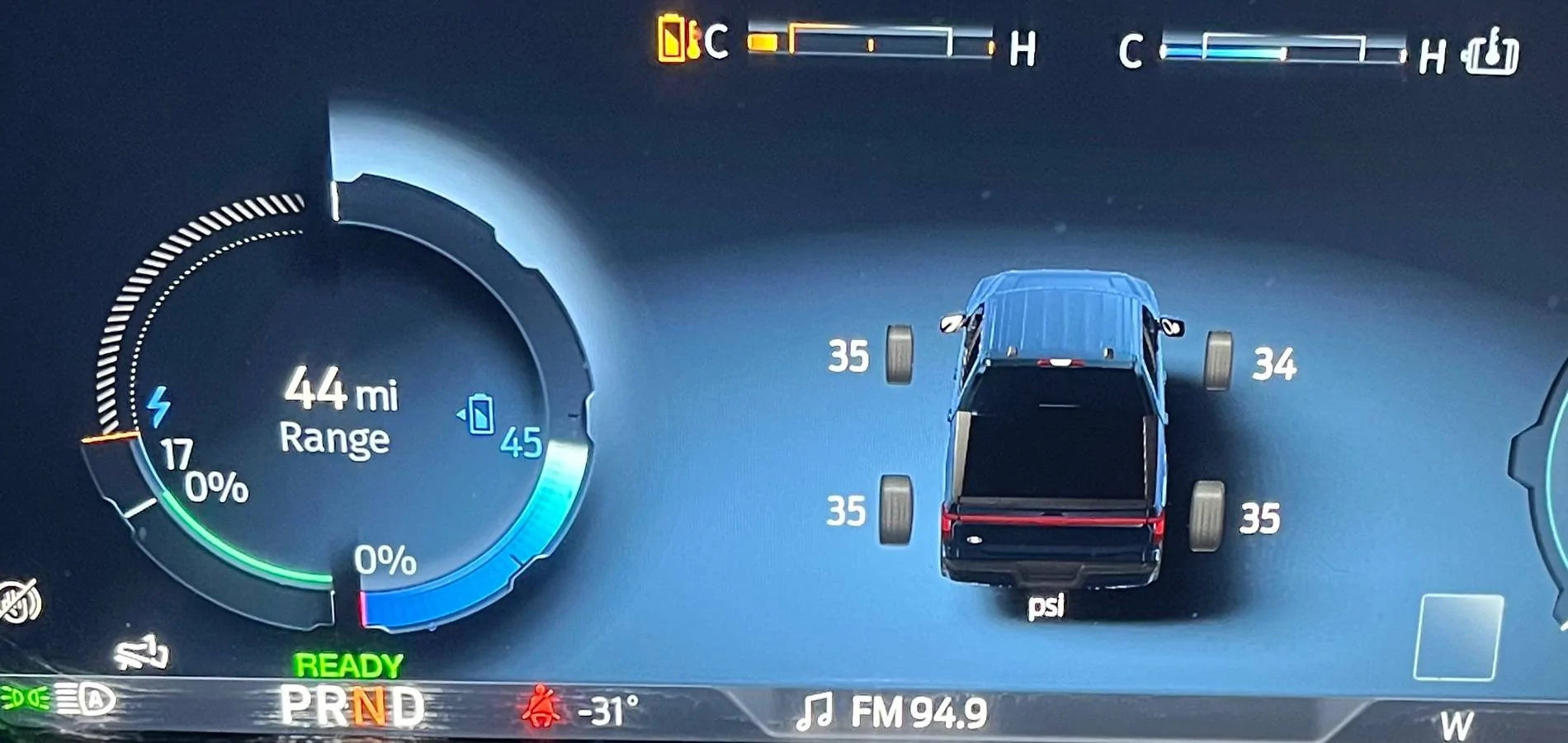

Extra cold tonight ?
less than 1 mile per% of battery ?
since my fpc keeps erroring out due to the temps, she’ll be cold soaked to -32. I’ll update in the morning what it shows.

Woof. Too cold for my blood. I would've been packing my bags and selling the house once it got below 0. :crackup:
Wow inferred 0.6 MPK

Welp…..she was not a happy ev this morning. Started remotely and warmed up the cabin. 17% power available but only in town driving to work so not a issue. Only “trouble” I would say it had besides the obvious power and range lose was steering was a little stiff. Motor temp still an enigma to me…

Welp…..she was not a happy ev this morning.... Motor temp still an enigma to me…
Brrr !!!
You might just be the first to ever see the battery temp gauge change color (at least due to the cold).

Good to know it still drives outside the battery temp range. The other day she sat in -7 degree (air temp) weather while I was at work. When I left battery temp was right on the lower end line. Wondered what would happen if it dipped below....glad to know it still runs!

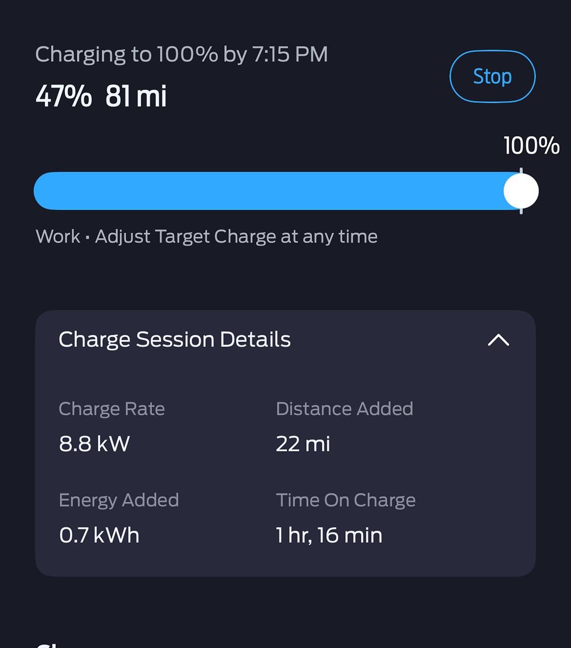

Having a hard time taking charge at these temps. Charged for 1.5 hrs and went to check the mail. Battery was almost to the center line. Came back and plugged back in but looks like most all the energy still going to heat the pack.
8.8 charge rate, only .07 added to pack in 1.5 hrs
My heater makes at just under 8kw so yeah, it's all going into heat

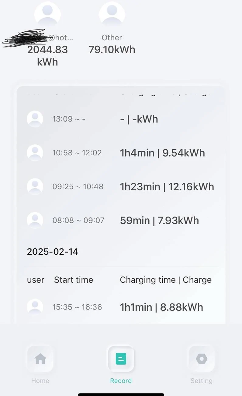

It'll be interesting to see your total gross energy consumption when it has reached 100%
With normal AC/DC conversion losses I would expect ~78 kWh, but with the initial energy going to the heater, it's going to much higher, do you have a direct energy monitor or do you use an FCSP where you can view the insights log after the charging session is completed (unplugged)?

It’ll maybe get to 100 sometime tomorrow when I’m charging lol (Prb not tho). As far as data this is as much as my power supply gives me.
