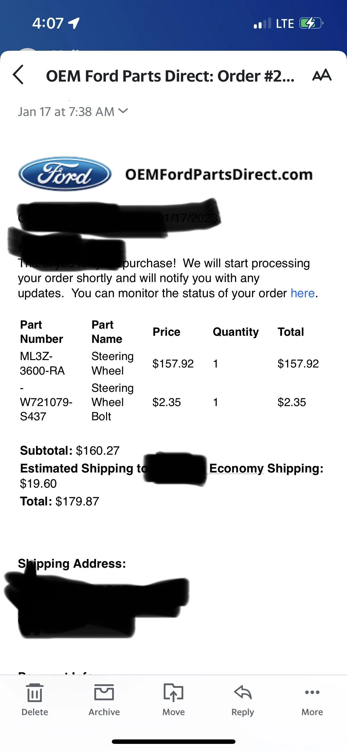

@jallen do you mind sharing the part information & how much this steering wheel ran you? I have a pro and have pondered this. I'm just not super hands on so I just wanted to get a sense of cost/part as perhaps I could ask my ford dealer to do the work for me.
Here you go!
Ford F-150 Lightning Leather Steering wheel Mod on Pro - Help! F0312133-53AF-4094-8A63-CFE7FDBF9FBB
