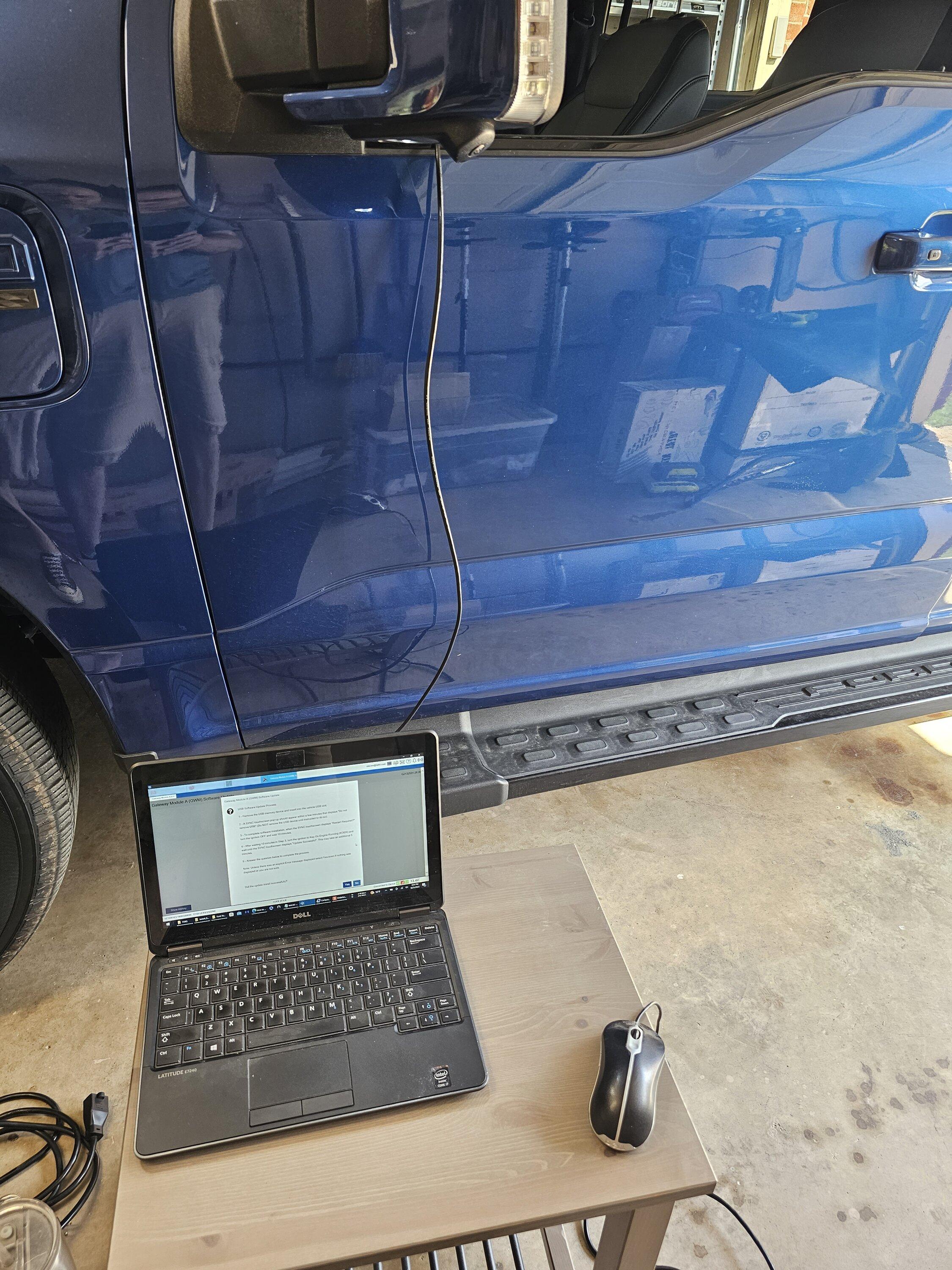

I'm in the middle of my updates following the order Mike provided earlier. Is the general consensus to install all available updates?
I can honestly say that the only one that ever caused me a problem was that DSP update. The rest were no problem at all. No reason not to do them all.

I can confirm on a 22 Lariat ER, I installed every update available in FDRS as of last week and saw zero regressions or issues.

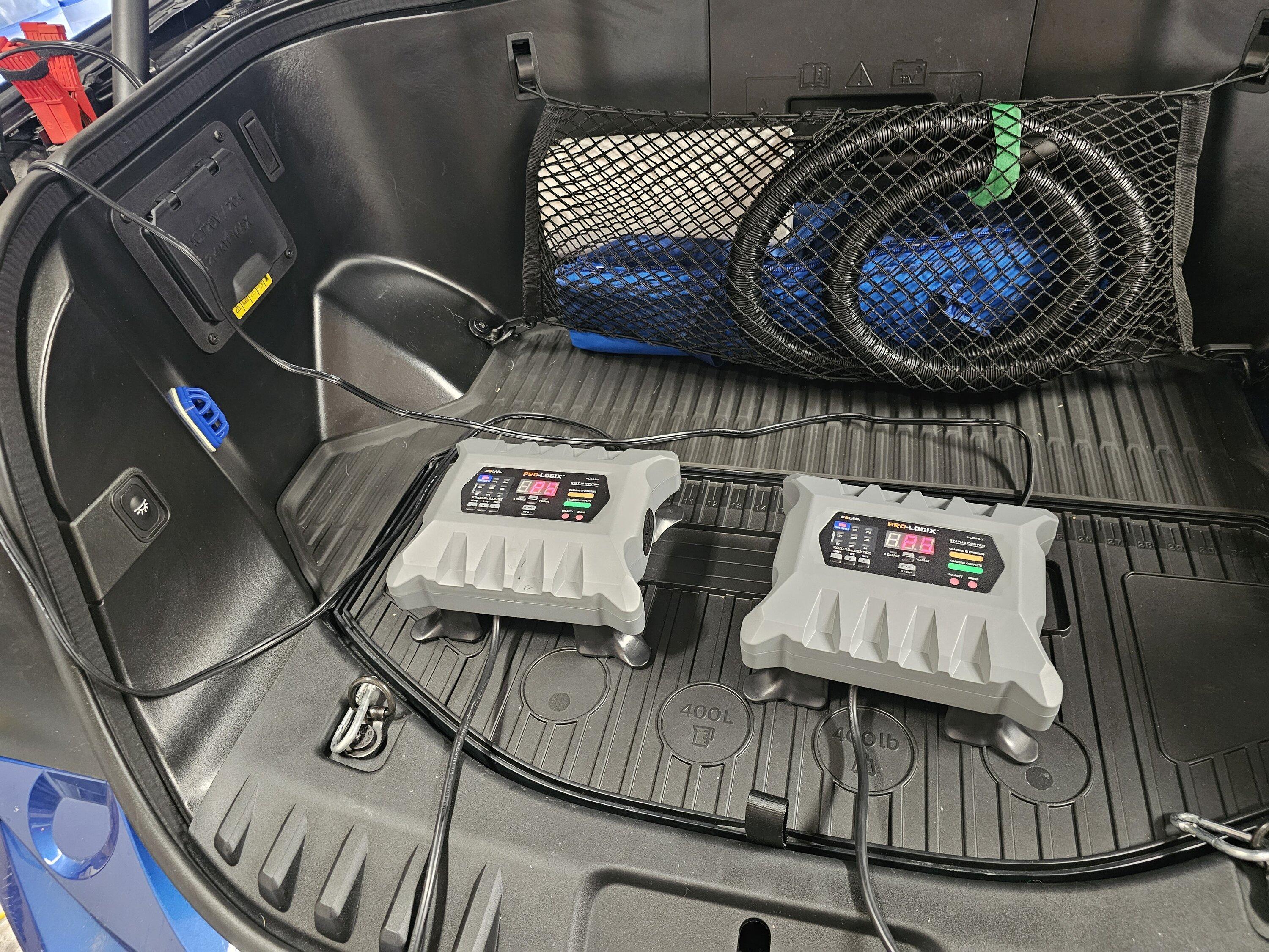

Finished all my updates last night and had no errors during the process. I did get nervous when the voltage dipped down to 12.1 at one point, but the dual PL2320's did well overall. Thanks MIke for the help with this. Got my PaaK setup and all my other settings stayed through the updates. I will drive it today to see if there are any issues. I'll check FDRS tomorrow for any new updates before my 2 days expires.
I'm now able to remain calm all the way down to 10.5V.....
But thankfully I don't ever have to do that again!

I've seen now multiple mentions of two PL2320s set up like this? I only have one and have done all my updates with just one. Am I at risk of something by not having 2? I'd really hate to buy another cause this all I use it for.

Thank you for documenting your update so well. I consider this option every so often (using the mongoose loaner option) but it would be nice to get by with just one Clore. Do you think if you would have spaced the updates out and allowed the Clore to charge the battery to 100% in between updates this would have worked? Are you able to monitor amp draw and voltage well enough to know you would have needed 2 even starting at 100%? Hope these questions make sense. EDIT: Posted at same time as Matt above, same question roughly!!

FWIW I was able to update fine for about an hour using a single 20A Clore. I would recommend, if you’re doing that, to have it charge up your battery with the truck off in charging mode first until it’s 95% or more complete. Then switch it to PS mode.
And during programming keep an eye on the voltage drop. If it gets into the 10.x volt range, take a break and recharge the battery again before the next set of updates.
