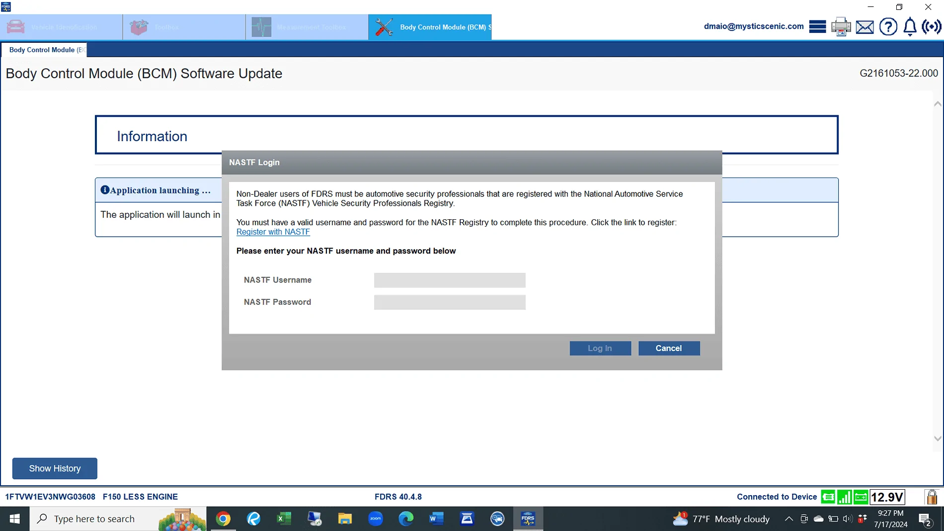

Looked around and found a screen shot, this is what I was getting when trying to perform the BCM update in FDRS:
And this is what I saw if I tried to log in with an NATSF account, which didn't work:
Are you able to update FDRS and try again and see if it works with your NASTF login?

I am still unable to do the BCM update, and from what I found from Ford I am not sure non-dealers will be able to unless you are a NASTF Professional with is impossible to get unless you have a business that is legit and you can prove it. Ford basically recently increased the security measures for non-dealers to harden security and it is basically what is causing the problem. Kind of sucks and maybe I am wrong but I do not think it is a bug.
PS I was informed of your role and did not know. So yeah basically from what I could tell reading NATSF forums was that it was a change to BCM updates in April or May. And basically since then I have not been able to do the BCM update, I started using FDRS in May. I think it wants a professional NATSF account not the free account.
