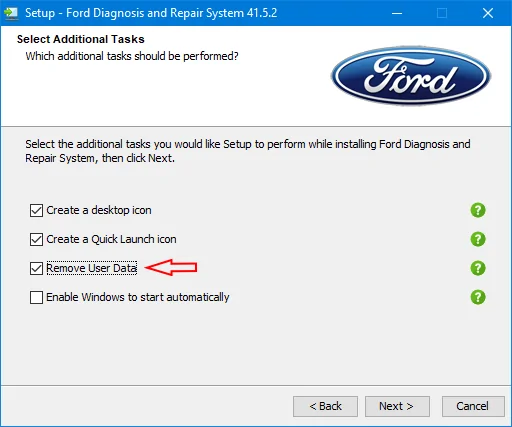

New version of FDRS out this morning:
Ford F-150 Lightning Lightning Software Updates using FDRS FDRS_41.5.2
Download here.
Anytime they release a major revision it's a good idea to let setup Remove User Data because of potential changes in HTML page formatting within the program. So look for the checkbox to delete user data and make sure it's checked during setup.
Ford F-150 Lightning Lightning Software Updates using FDRS Remove user data
Download here.

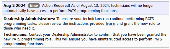

While we're on that topic...even techs at dealerships will have to have their dealership grant them permissions to do PATS functions with FDRS after 13 Aug. Right now any of the techs authorized to use FDRS at the dealership can do PATS functions, but they are now going to start limiting who in the dealership can do it going forward.
Ford F-150 Lightning Lightning Software Updates using FDRS PATS

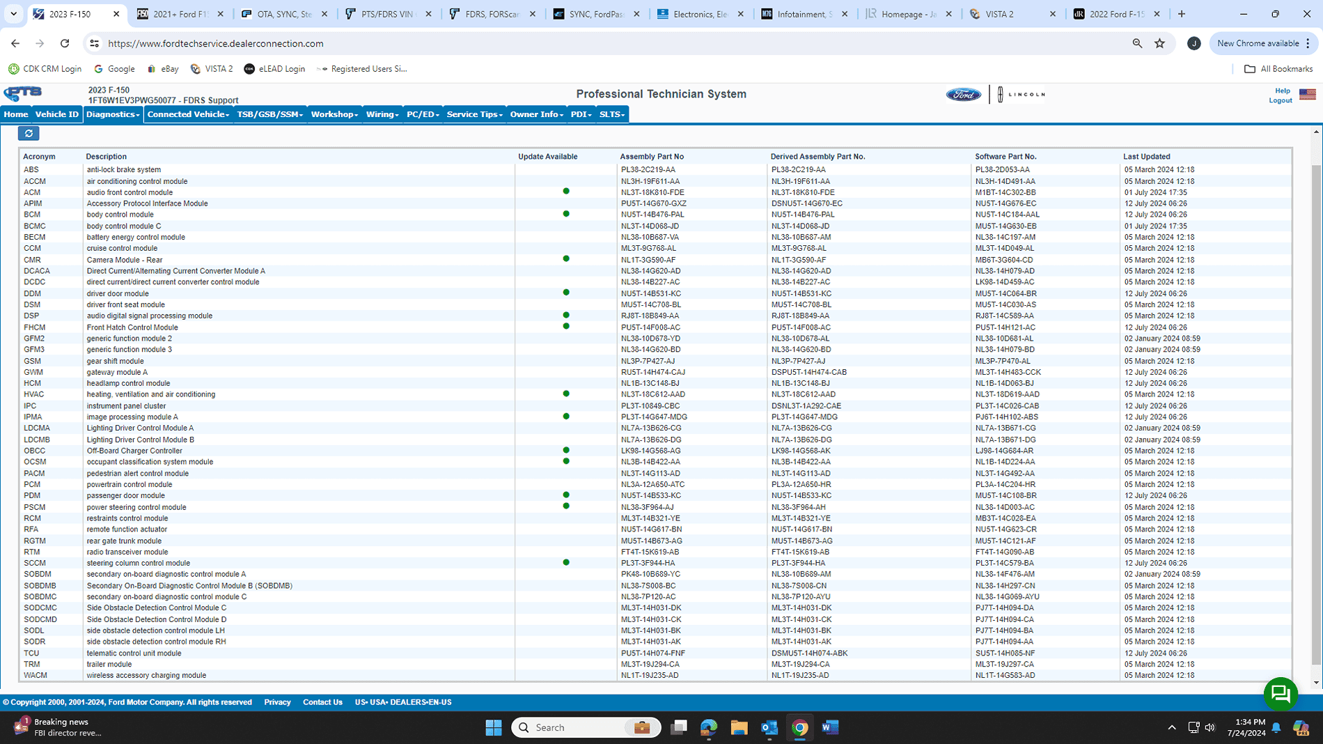

Would I be good to perform all the other updates without being able to perform the BCM update? Attached is the updates available for my truck as of a couple of weeks ago...
Ford F-150 Lightning Lightning Software Updates using FDRS 1721842738845-5q
Yes. That's what all independent FDRS users have been doing for about a month or longer now since password issue first came about.
