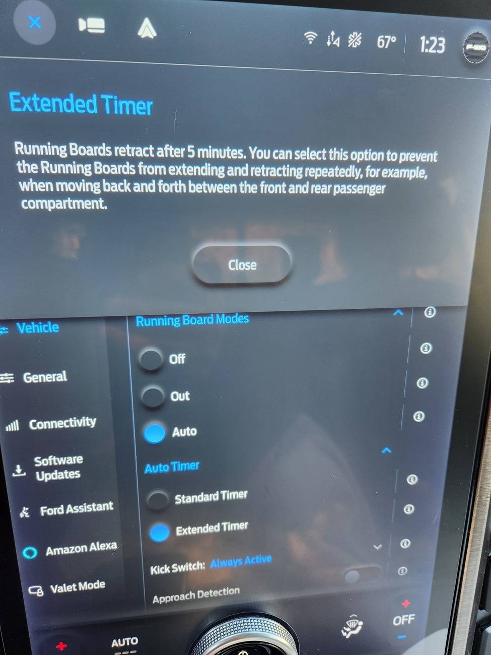

I have the oem steps. Found out that the behavior varies depending on which door I open. If I open and close the driver's door, steps retract, mirrors fold and truck locks all in about 8 seconds or before I can even walk around the front of the truck. If I open and close the passenger door, the steps retract at about 8 seconds but it's another 10-12 before the steps redeploy, mirrors fold and truck locks. Then it's an additional delay until the steps retract again.
I believe in your touchscreen settings you can adjust the time the running boards stay deployed. It can be done with FORScan, but I'd really have to dig in to see how you do it. I was looking into this for someone the other day and it's a lot to go through:
On the DSM tab, look from 744-42-01 through 744-46-08.

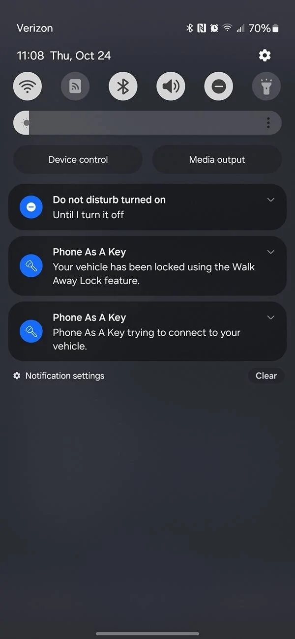

yeah there's an extended timer (5min) that I have it set to now. Standard is 25sec. I was previously just using PAAK but noticed that if I'm just using the fob, the truck does the same delayed lock when I close the driver's door. Sure it's probably programmable somewhere but the extended timer prevents the steps from deploying unnecessarily which is what I was looking for.

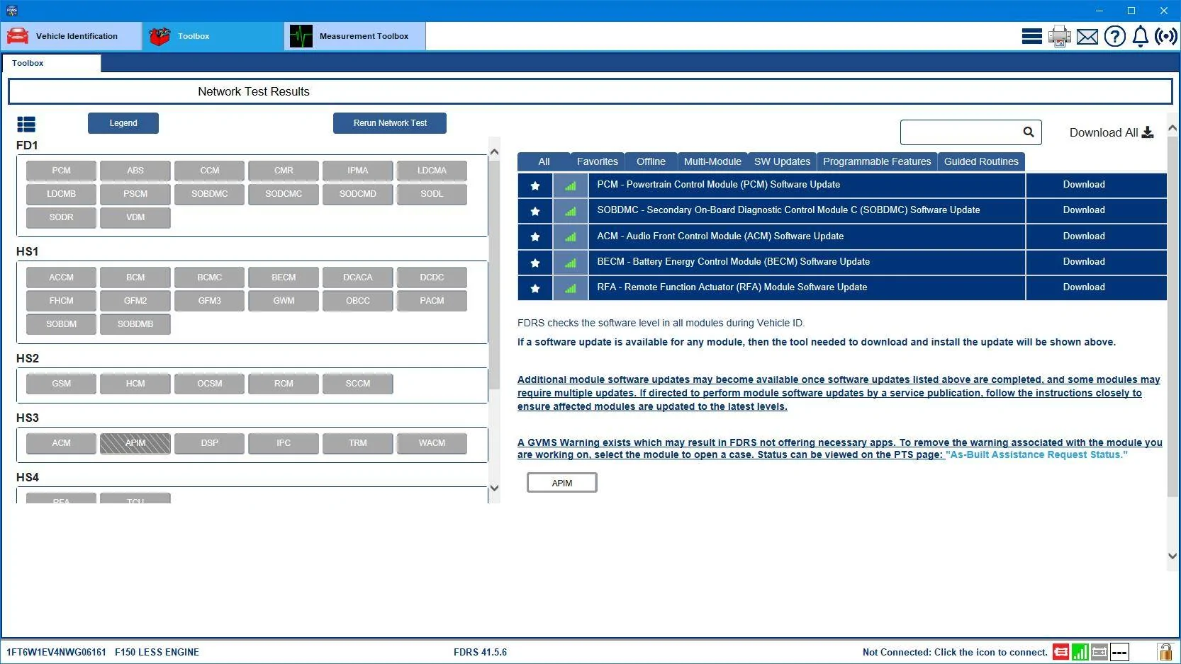

I have a GVMS block on my Lightning's APIM this morning. I wasn't in any danger of having to do an APIM update anyway. And on my '23 MME GT, I have a GVMS block that showed up on both the APIM and the TCU as well. Again, there weren't any updates pending for either of those modules. And both vehicles are running the latest APIM (Sync) 1270 flavors without any issues. So...I don't know what they're up to 🤷‍♂️

And now today, on a Sunday (🤷‍♂️), I've got a subset of the powertrain updates that showed up overnight.
They weren't there when I discovered I had a GVMS warning on my APIM yesterday.
Of course, the ACM and RFA are still with us....
Ford F-150 Lightning Lightning Software Updates using FDRS Lightning_Powertrain_10-27-24
EDIT: Updates done. PCM, SOBDMC, and BECM in that order (scripted). From 0826 to 0833. So not long. Minor weirdness when the BECM started...it immediately said it had failed, and did I want to retry? I said yes and it went right through. No issues beyond that.

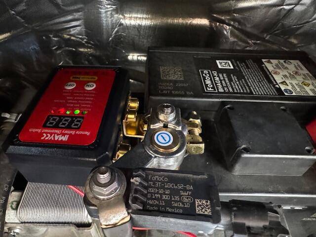

I've been thinking about doing this. I have a Naviks HDMI interface module running through my APIM which tends to get locked up in a funky state every now and then and the only way to kick its ass back into gear is disconnecting the battery.
I know there are plenty of ways to do this, but what did you to yours?

Props to @rugedraw on his choice of battery disconnects. I bought one and it's far easier to configure it so that you don't have to stretch the negative cabling around to fit the disconnect. The terminal posts are right next to each other.
This thing is perfect, and the remotes had batteries in them and worked as soon as the power was connected to the cutoff circuit. Completely brilliant.
Gonna get one for the Mach-E because the LVB location on the car is a lot harder to get to, and it's possible you wouldn't be able to open the frunk to disconnect the LVB on the MME anyway. So this is definitely going to be the next small thing on the car's todo list.
Couldn't be happier with this purchase.
Standby current draw is .004A. So I don't expect any significant drain.
