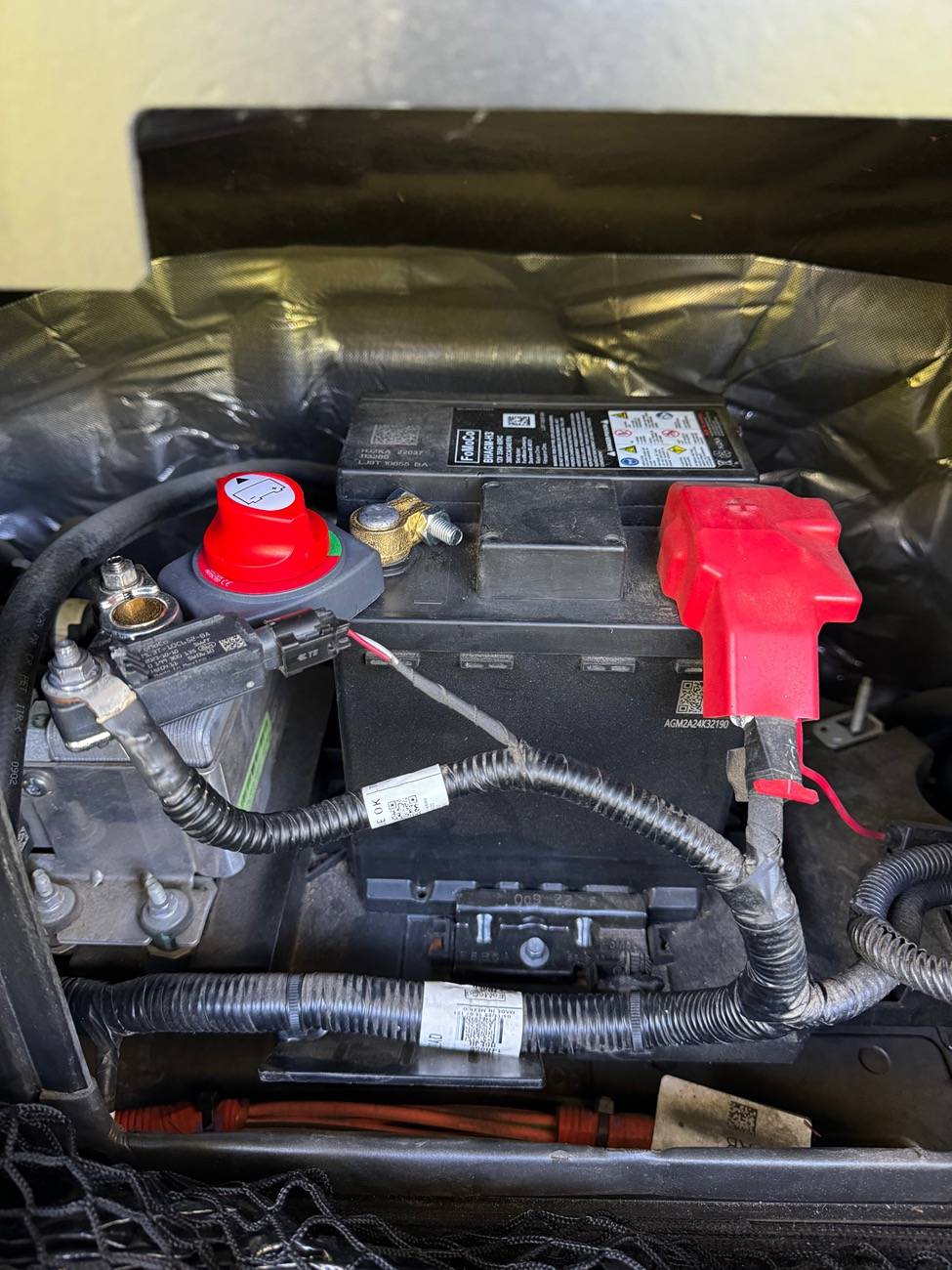

Perfect! I like that and the articulated ratcheting end will be beneficial. Good catch!
Well, several of us with Mach-Es sprung for these after the recent "lockout" software issue so we could disconnect the 12V battery. So I put the ratchet one in the MME and the other one in the Lightning. But I'm about to install a battery shutoff switch on the Lightning anyway to make that one even easier to reset.
