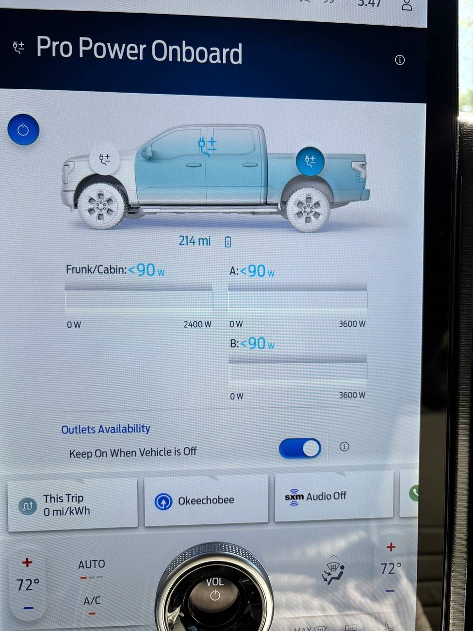

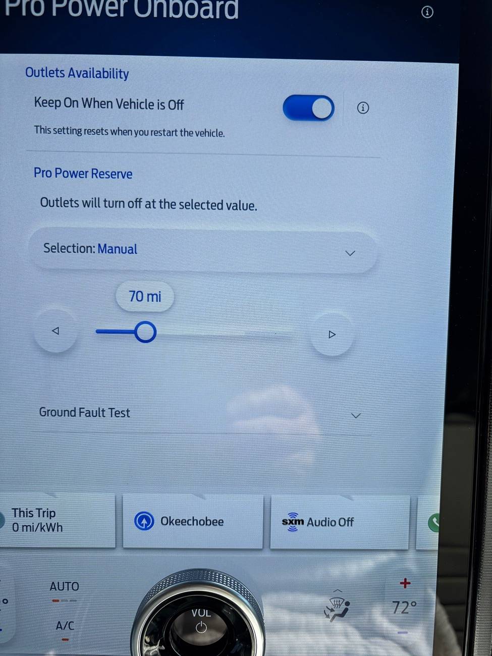

I absolutely agree with Karlo. I have my truck set to turn off the outlet when range hits 70 miles

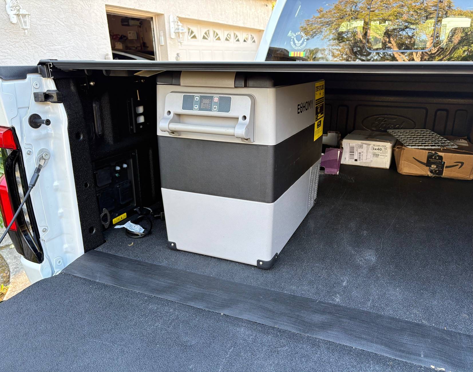

I always pre cool the powered cooler in my truck bed before filling with food on a trip. On the past i would run an extension cord from the house to power the cooler before a trip. If I stop to get something to eat I would like to not have to leave the truck powered on just to keep the cooler outlet alive.
Ford F-150 Lightning Power outlet are timing off after 6 minutes! IMG_0472
power when range hits 76 miles. When I power my truck bed cooler to pre cool it before a trip it shouldn’t turn outlet power off when cooler hits target temperature

The main shut down timer appears to be set at 30 minutes and will turn off the truck if you inadvertently leave it on. I did disable that anyway , even though it is shutting down in 6 minutes. There is another protection that shuts the outlets off at an amount of predicted mileage that I can adjust according to how near a charger I might be. The default is 102mi (weird). I have it set at 50
I believe the default is based on a percentage of battery left. It translates to miles, but it actually percent of battery life.
