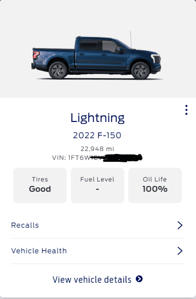

Interesting to see the discussion about what is visible on our Ford.com account. So how do you explain this?
Hate to say it, but delete the record and add it to your profile again, but be forewarned you might need to do a lot of reconfiguration work on the mobile device!
When you originally added the VIN to your FORD.COM account was that prior to actual production??
I honestly don't remember when I added it. It's possible that I did it before production.
I think at this point I'll let it be since that screen provides little useful info that I can't get elsewhere. I see my LVB SOC on my OBD and that is quick and easy.
