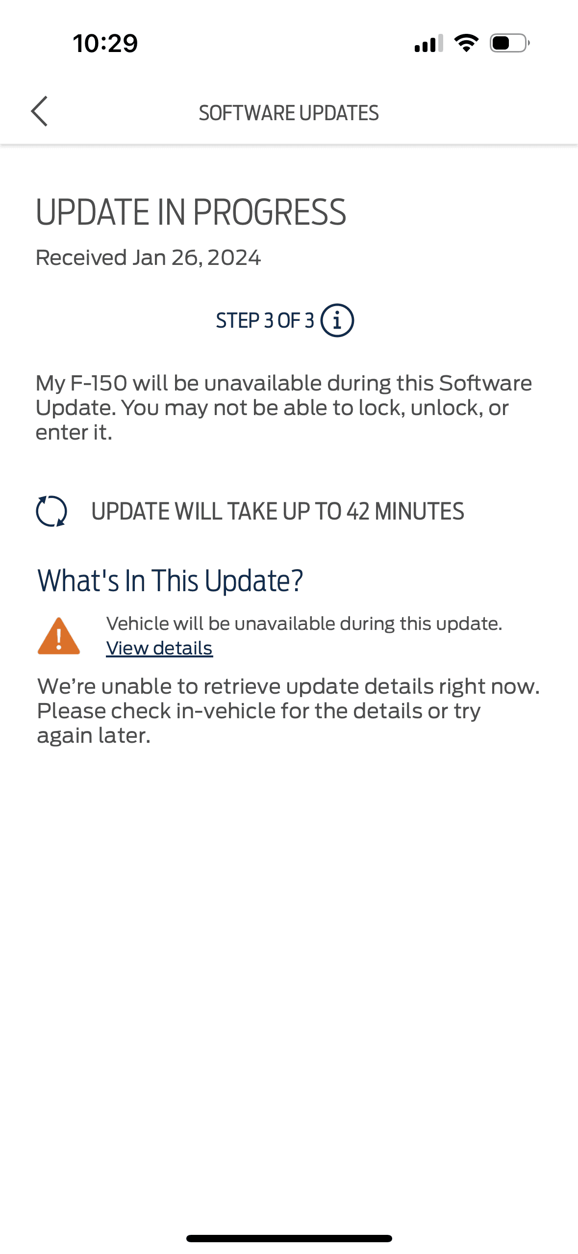

Don't hate me but after successfully installing 6.8.0 two night ago my truck is installing another "Smart Changes" update that it says will take 42 minutes. 6.8.0 was described as only taking 11 minutes. Could I be on my way to Blue Cruise 1.3? I've never seen an update take anywhere near that long.
There has been mention of this one taking ~42 minutes to process.
