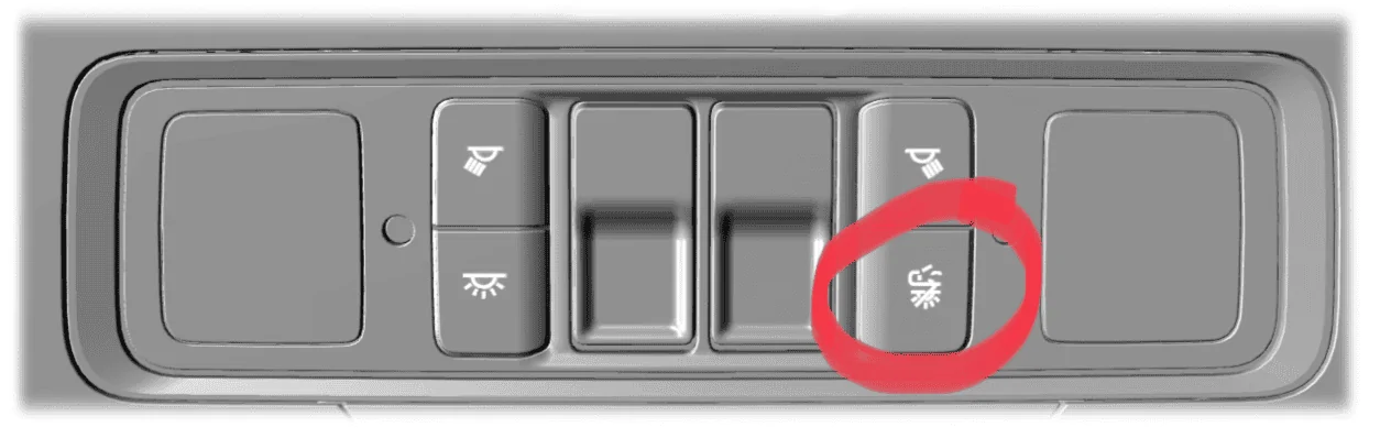

That and turn on and offf the damn inside lights when I open the doors!
There is a button in the overhead area that enables/disables entry lighting. I have accidentally turned off entry lighting trying to open the moonroof cover.
Wearing bifocals it’s hard for me to see the icons for what each button does!

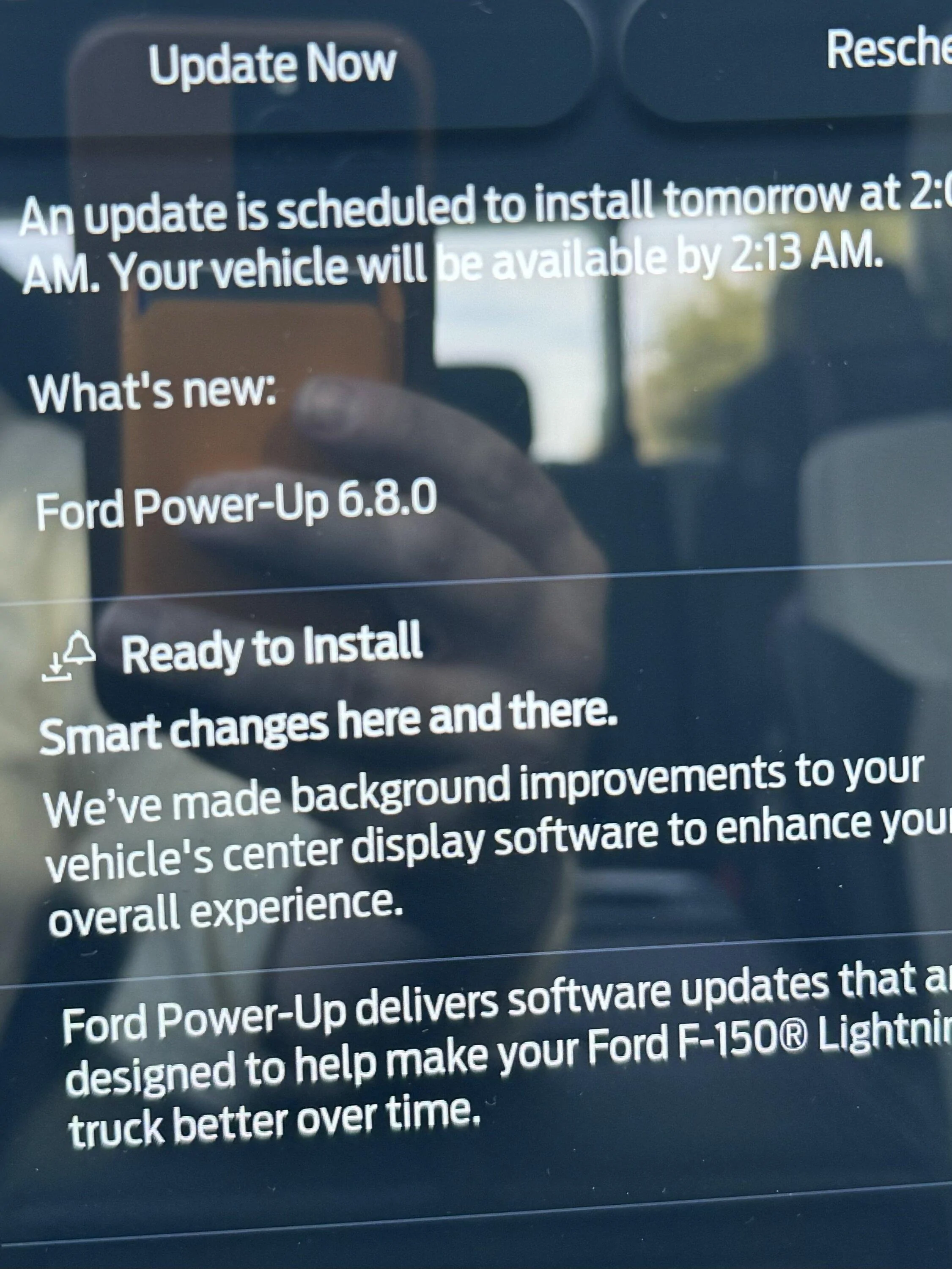

Just received 6.8.0 tonight.
Minor glitch after a successful install, my navigation was trying to route me home while I was parked in my driveway. Went for a short drive and the nav still wasn’t updating and not allowing me to cancel the directions. Tried cycling power a few times, same issue. Had to reset the infotainment/sync which fixed the issue.
