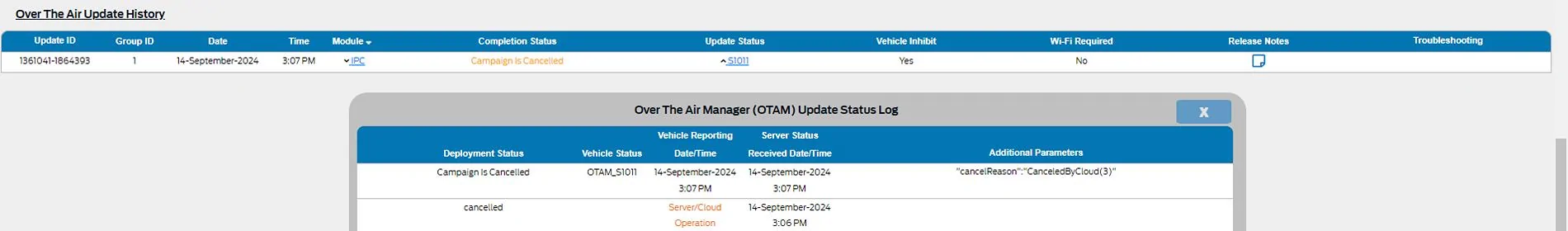

Unfortunately my 6.8.0 update didnt come through. Instead I received a “Not Completed” status. Does anyone know when the truck will try to reinstall the update? I would love to know what happened but it seems like Javier doesnt have access anymore ?
215
15,798
17,722
It will retry per your schedule until the package expires on the server, 7/14/30 days not 5/7/14 days.

And if the package expires, does it never push again?
Runaway Tractor
Jan 25, 2024
690
1,143
Yes
I got it back. In your case, the update was canceled on Ford's side with no reason why provided. Nothing you did wrong.....this happens a lot.

Same thing happened to me (not completed). It hasn't re-tried in the last few days. What does the 5/7/14 days mean? If it doesn't happen within this time period how long until does it wait to re-try?
TIA
OTA triggers have several time-related criteria they must meet before they time out and expire. Depending on which stage of the OTA process the update is in and whether the update requires the vehicle to be inhibited or not, the timer is 7/14/30 days that the update has to ping the server back and then download/install the update.
If the update fails completely, there is no set time frame as to when it will be resent. It could be days, weeks or months before it is resent.
Thanks Javier!!
