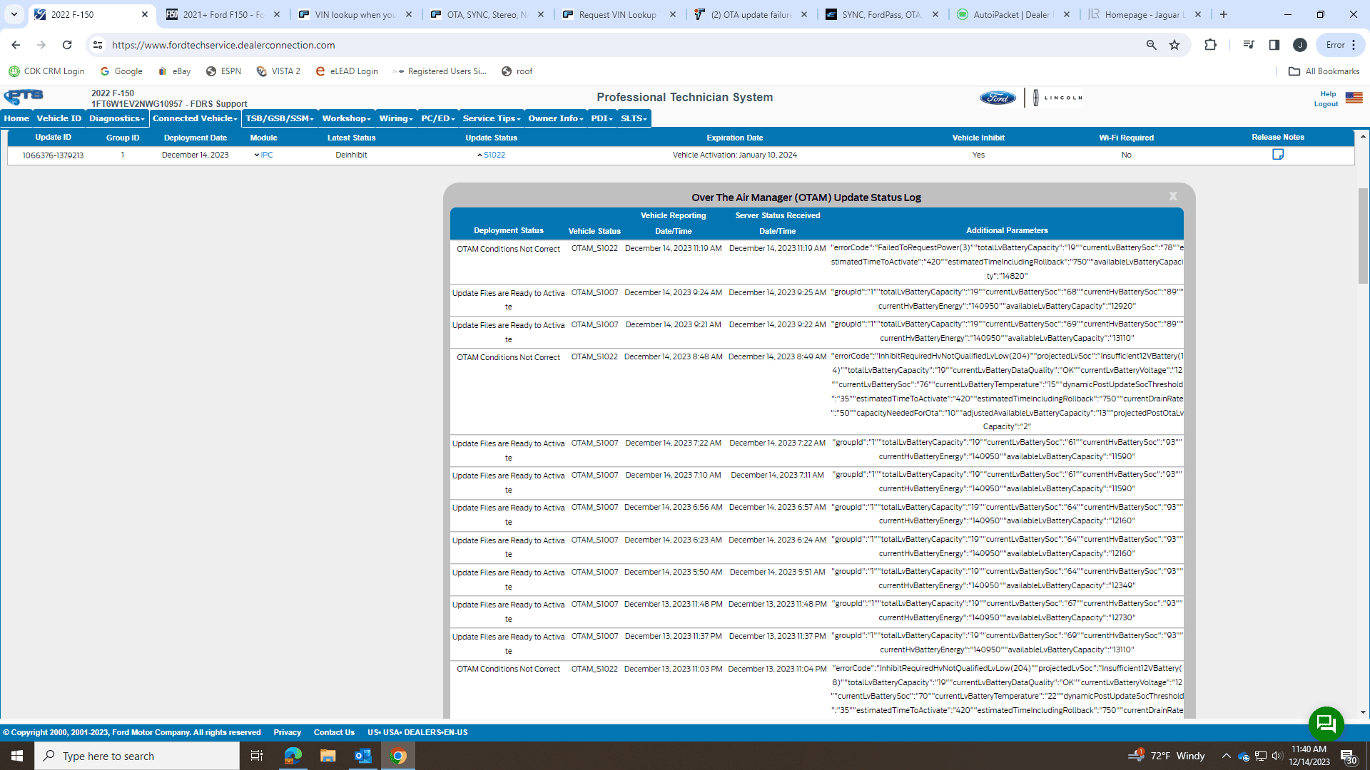

@rugedraw and you have access to this system? I would bet almost anything it's due to 12V SoC, despite being relatively high... And it also could be due to weather since it is getting colder in my location.
I do. Just need the VIN.
Lytning
520
820
Georgia
99% of the time time, OTA's that require vehicle inhibition fail due to low battery SoC. I can confirm with your VIN, but I'm confident that's the reason.

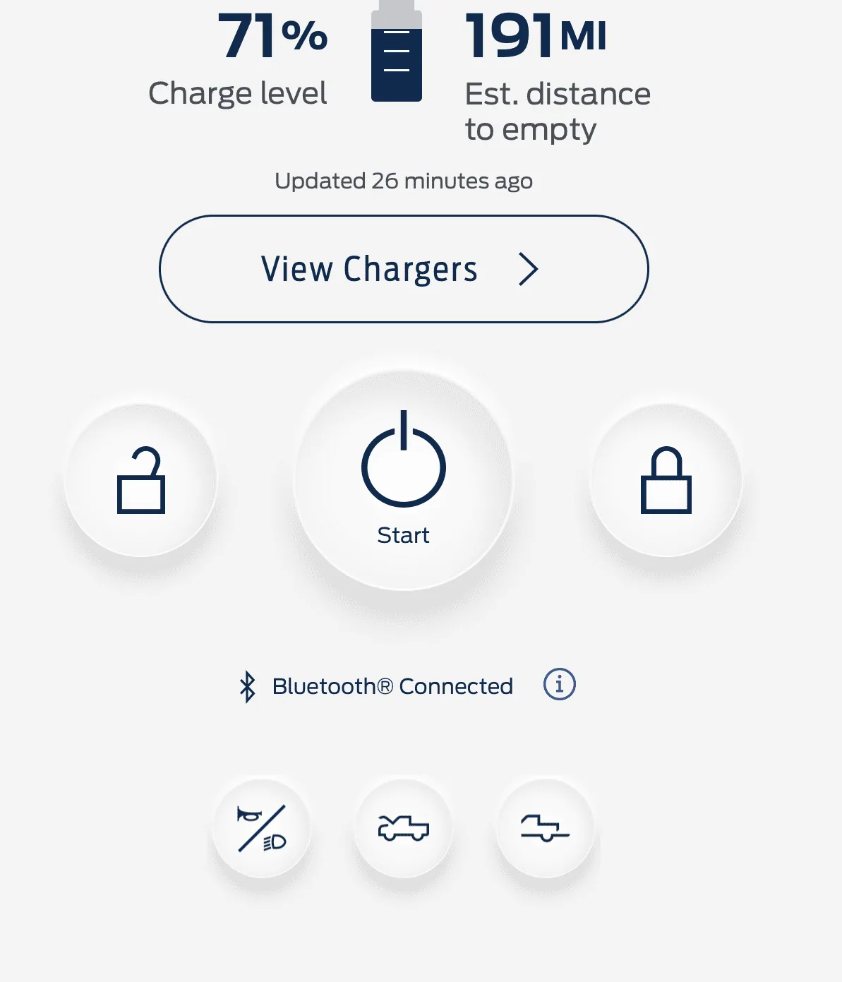

So, my LVB SOC is a little anemic at 72%:
I'm pretty sure this is HVB not 12v. My battery is at 13.8vdc and shows 73% on this page. My HVB is at 72.5% (OBD) and shows 71% on Ford Pass. I think there's a data age issue when Ford is binning this data. I'll charge to 80% and let it sit and see what happens.
Well I'm totally lost now, charging, HVB increasing, 12v still at 13.8VDC and this just dropped 4% to 69% ⁉
I'll agree with you that some of the data on Ford.com is stale, especially the Vehicle Health Report section, wrong mileage on mine.
My trucks current HVB SOC is 89% and the LVB initially showed 72% but later dropped to 67%.
At the moment I'm idling the truck with all accessories & HVAC shut off to see if I can increase the LVB SOC, it's been "running" for 60 minutes and no increase yet, might need to go lower before the strategy & conditions are met for the next boost up.

@ziptbm See below, VIN blacked out for your privacy. It's failing mostly due to low battery capacity; SoC is not being recorded as very low. SoC was at 89% this morning, but battery capacity is consistently low at 19%. I know some are not fans of BMS resets, but in this case, I would recommend fully charging the battery and resetting the BMS. No need to panic; the OTA trigger is good for 30 days, so you have until 1/11/2023 to get it to go through.
I also suggest you and everyone here to take the time to read through this post by Mach-Lee over on the Mach E Forums. He is very knowledgeable and has some good ideas to get the LVB to a good state for OTA's.
https://www.macheforum.com/site/threads/how-to-get-failed-otas-to-install.29749/page-4#post-727968
