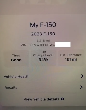

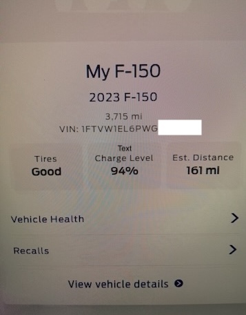

It’s definitely the 12V battery.
Yep, I was skeptical too, but it matches what the Home Assistant integration shows for LVB SOC and CarScanner. All three showing 89% while my HVB is clearly at around 83%.

I logged in and love seeing that on the ford.com. I haven't done the leg work to see if it matches my true 12v battery SOC, but I can tell you it doesn't match my HVB SOC. The number of miles do match though. So I'm still really wondering if it is LVB or HVB.
However, this could take the cake for one of the dumbest things Ford has ever done.
I wonder if they realize we are even driving an EV? You put the "Charge Level" front and center on a web page where I log in, of course I think that has to be the HVB SOC. The HVB SOC is what 99.99% of EV owners talk about. I've never heard a Kia owner or a Tesla owner worry about or talk about the LVB SOC. Only Ford owners, like us, because Ford can't manage it and install SW.
To say the least - who puts that anywhere without clearly labeling that is the LVB/12V SOC.

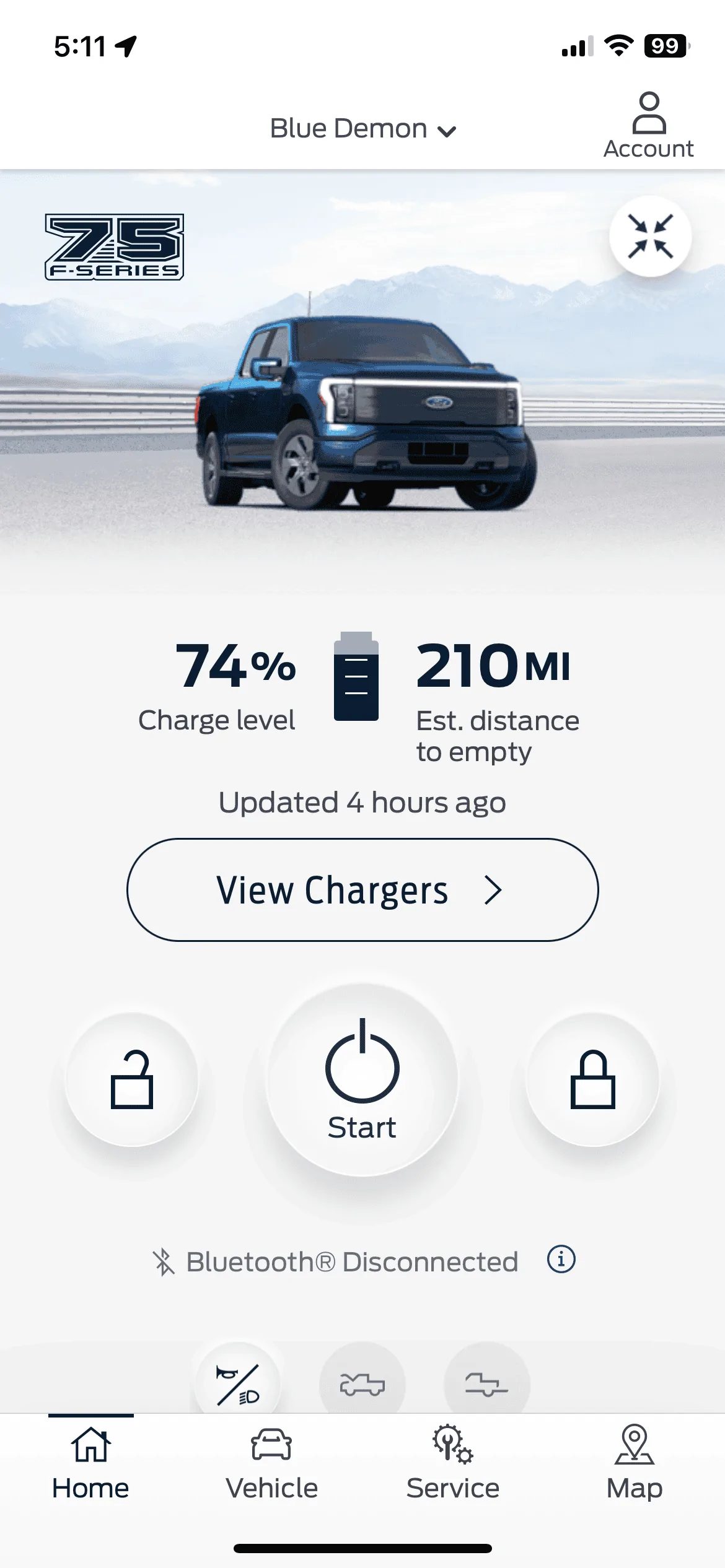

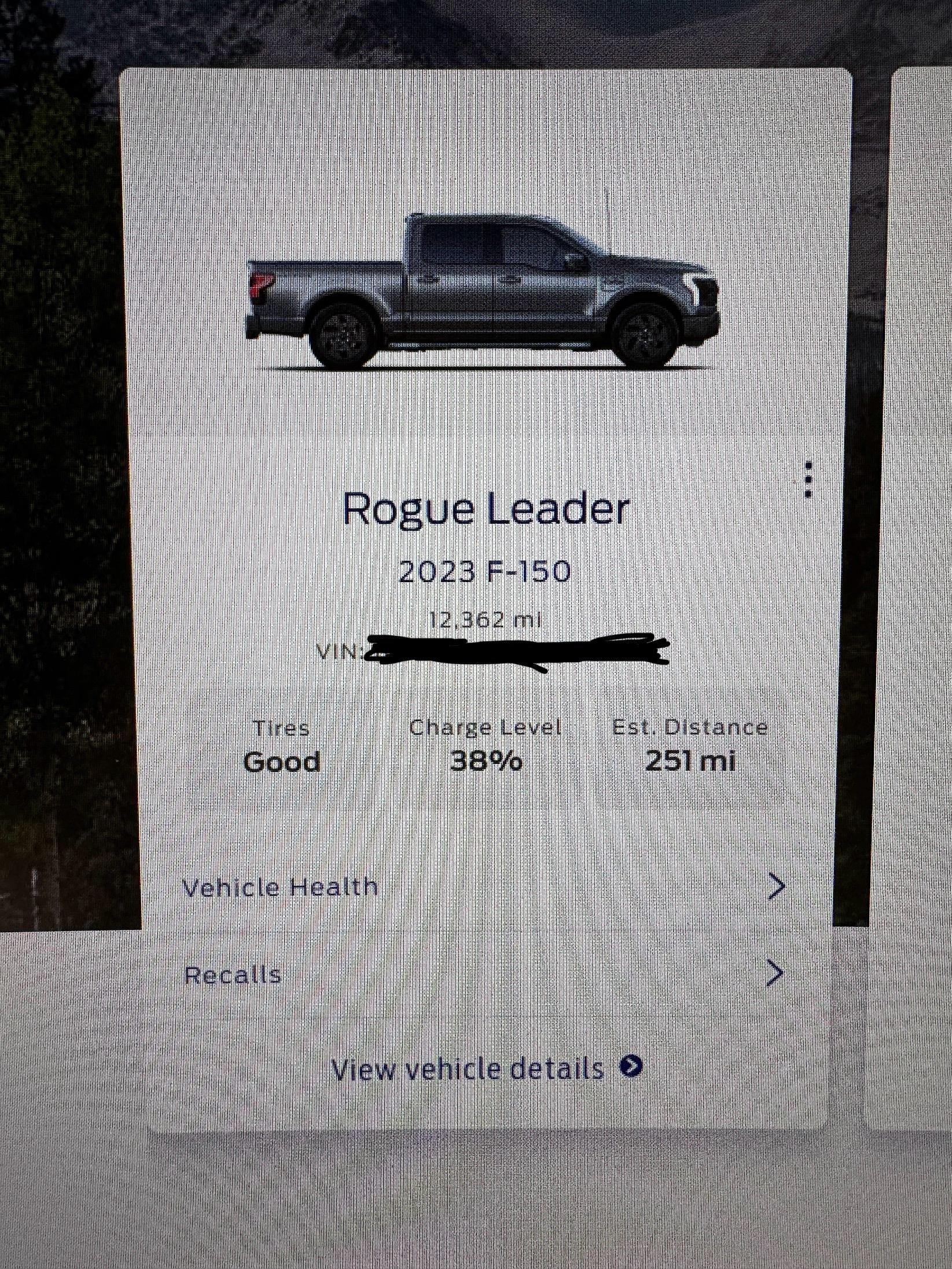

I’ve historically had issues with updates failing, and I don’t know that my HVB has ever been down to 38%, so I’m curious about this actually being the 12V battery %. I’ve got 6.4 and the 2023 Improved DC Fast Charging update in the last 3 days, so things are seemingly working a little better.

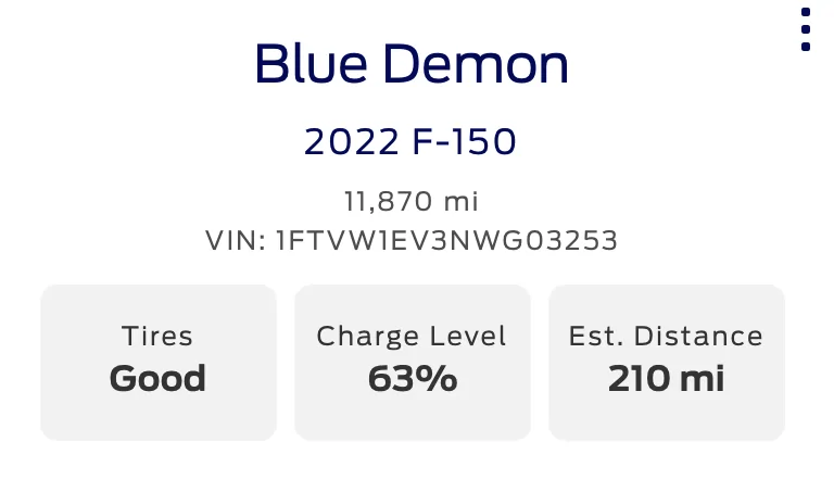

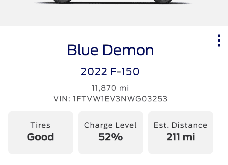

OK - This SOC is even crazier. I went to read the MachE thread and clicked the link there - logged into my Ford Account again - I took these screen shots 25 minutes apart. I've not been to the truck, I didn't start the truck, I haven't driven the truck and now my "SOC" what ever it is from now shows it is 10% less AND I gained a mile of range. My mobile app now show 211 miles DTE too.
First screen shot taken at 5:11 PM Central, the second taken at 5:36 PM Central. SOC drops 10%.

In my experience the Ford Account data on the web does very slow updates. In Home Assistant it will tell you the last time it updated. Often it is more than 12 hours for me when not driving. The nice thing about HA is you can force a refresh and it will ping the Ford servers. I know in the app you can pull down on the screen and get a refresh but since this LVB is on the website I don't know how to force a refresh - it's likely just pushing the same stale data (i.e., clicking F5 doesn't refresh data).
In other words your 63% could be from many hours ago and it refreshed between 5:11 and 5:26.

Theres a glitch in the site - that is actually your 12V battery SOC.
