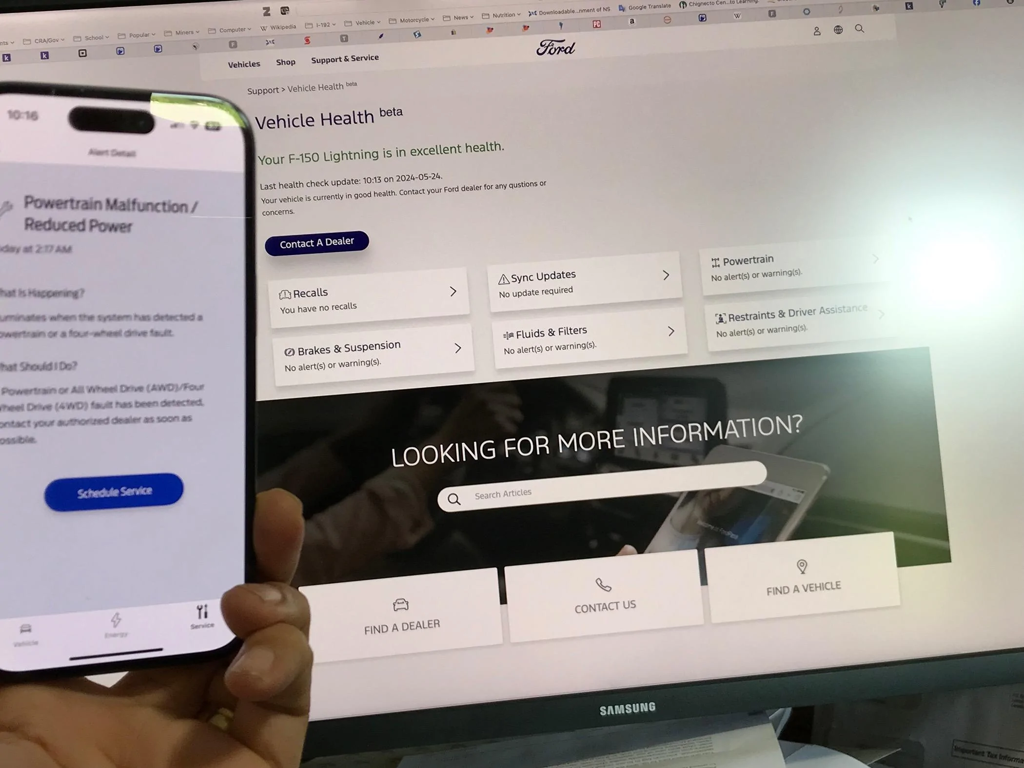

Even the Service Advisor can easily see the codes set by looking at your VIN. They get a very nice display by day on the truck comms and codes.
Let's just say, I'm a little frustrated.
Since I bought the truck, I got to drive it for 2 days. It has been back in the shop for a week and we don't have the cause of the problem identified yet.

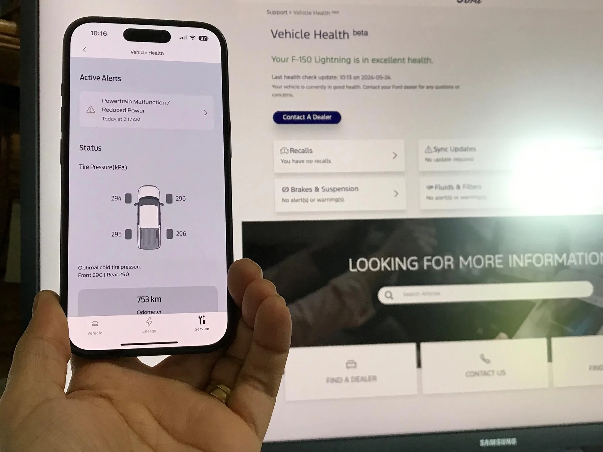

So, finally got an update. It’s the DC charging module that faulty. Exactly what I told them it likely was a week ago. The part is being shipped and should be repaired in a week’s time.
