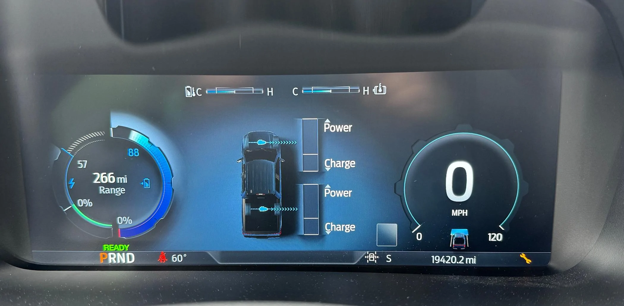

Well... I woke up this morning with a nice surprise and didn't feel confident about going to work this morning.
It charged last night to my normal 90%, and this morning I went to remote start (like I always do). I had issues with that EVSE in the past, but noticed it didn't have an error, although the truck did (red ring). I restarted the EVSE, still the same. I then tried another EVSE, and it still gave an error. I then stopped by the dealer (~10 minutes away), and now I am just waiting.
A few minutes after I arrived at the dealer, I saw my max power being reduced to 57%, and I then received a Powertrain malfunction/Reduced Power on my Ford App.

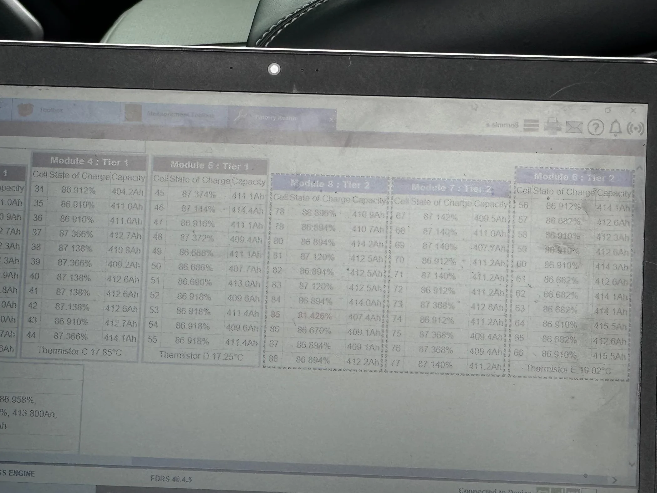

So it looks like I have a cell issue - Module 8 : Tier 2…cell 85:
Ford F-150 Lightning Powertrain Malfunction/ Reduced Power IMG_1835
Module should come in a week, but the thermal paste is on backorder… :(
Welcome to the club :( . Another 2022. Looks like you have a good dealer though.

They seem pretty cool, and this will be their 4 module replacement. In fact, they are getting done on wrapping up another FL150L with the same issue as mine. However that was module 5 vs module 8.
They said it will be in the shop for at least 2 weeks... most of which is getting the parts from Ford. I wanted to keep the truck at home so it can be "safer" while waiting for parts, but they need the vehicle for testing and etc.
