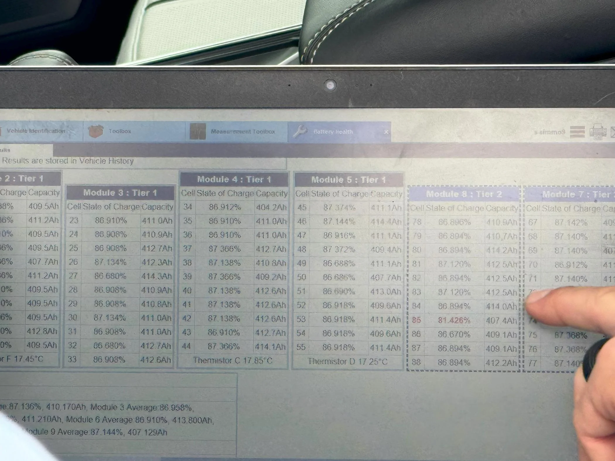

So it looks like I have a cell issue - Module 8 : Tier 2…cell 85:
Ford F-150 Lightning Powertrain Malfunction/ Reduced Power img_1835-jpe
Module should come in a week, but the thermal paste is on backorder… :(
Anyone: How does State of Charge relate to Capacity? See Cell #34 in Module 4 for its low capacity, but Stae of Charge is still up close to other cells. Weird?

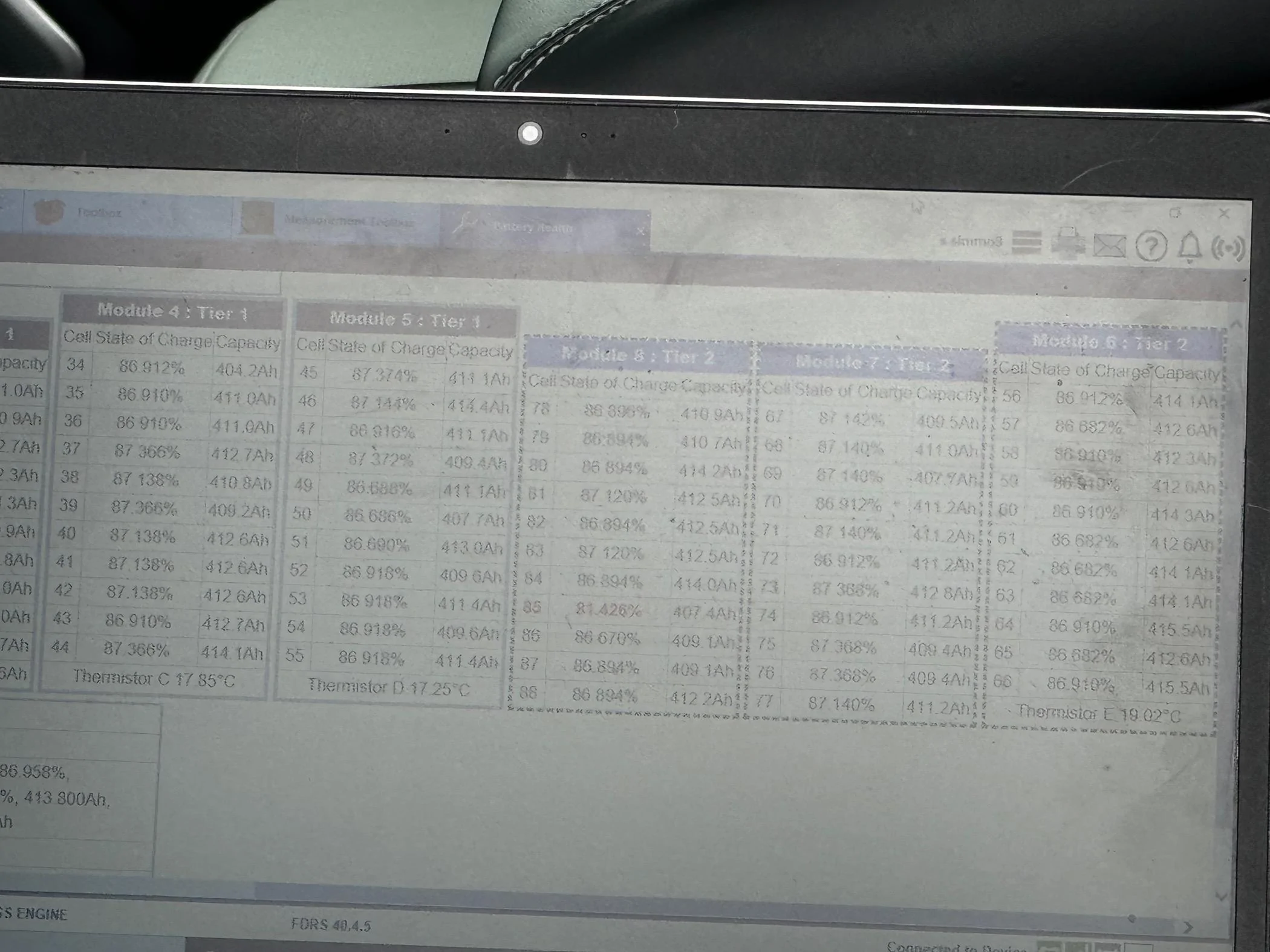

I didn't see that when I posted it, but yes its odd. Keep in mind that I only charge to 90% on the daily, and this was around 87% by the time I went to the Ford dealer (~5 miles away), and it was 89% when I saw the issue remote starting. I will be keeping a ODB reader with me after this and check the charge level more often (or to be able to reset it so I can charge at least) if I am on a long road trip and this issue happens again.
If there is any correlational, I will be needing several battery arrays/modules soon though as some of them are quite lower than the standard. @RickLightning or @MickeyAO might know more about this.
I wish I had a whole picture of the modules, but I snapped a picture of the other side more.

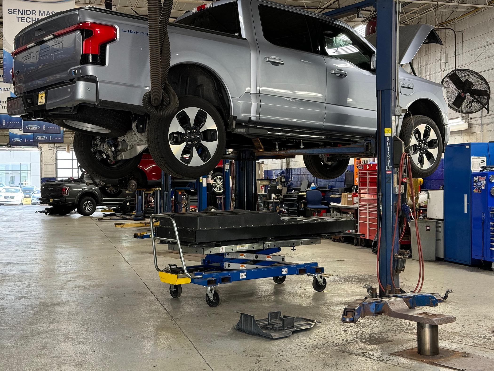

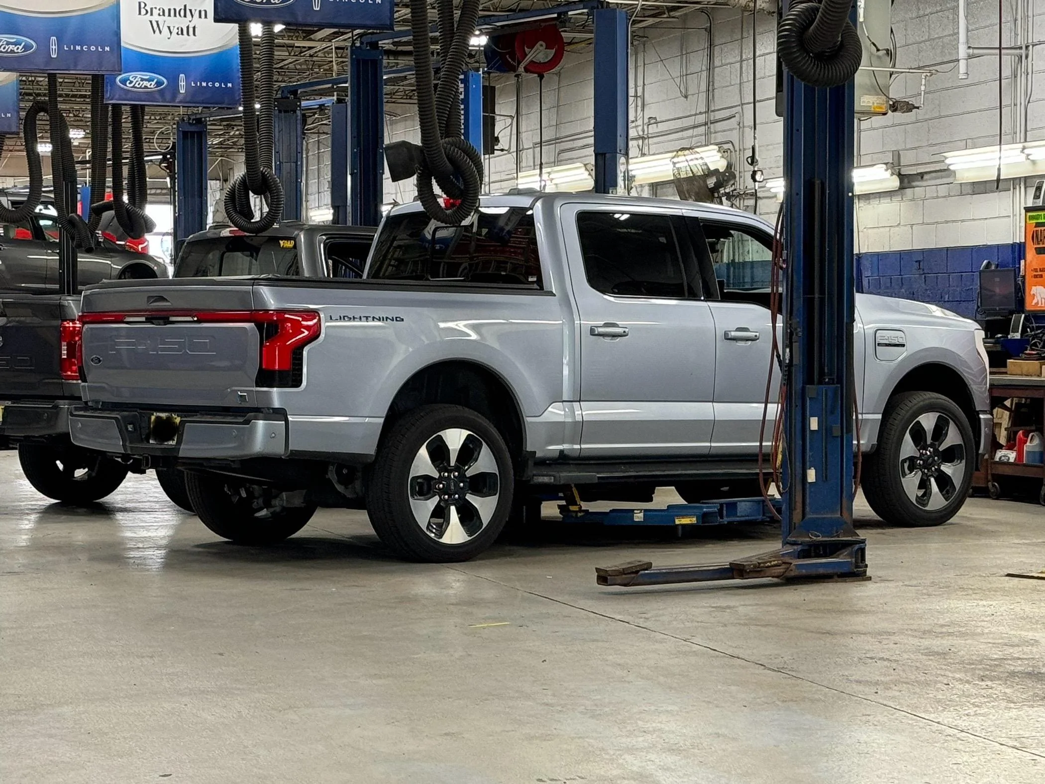

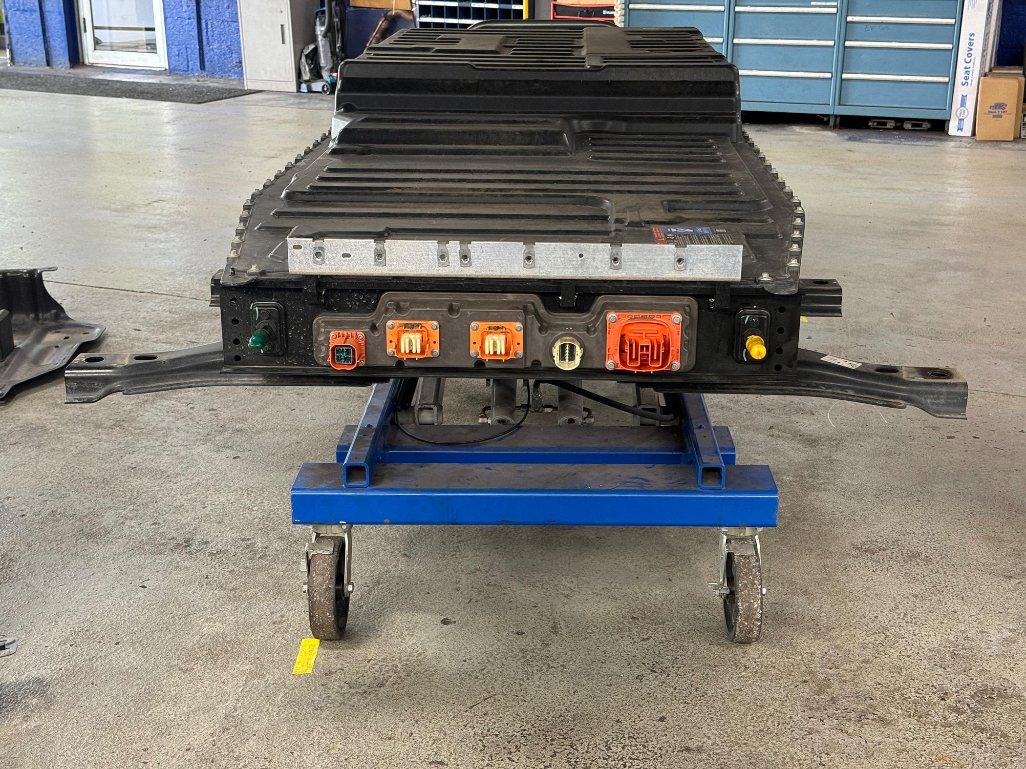

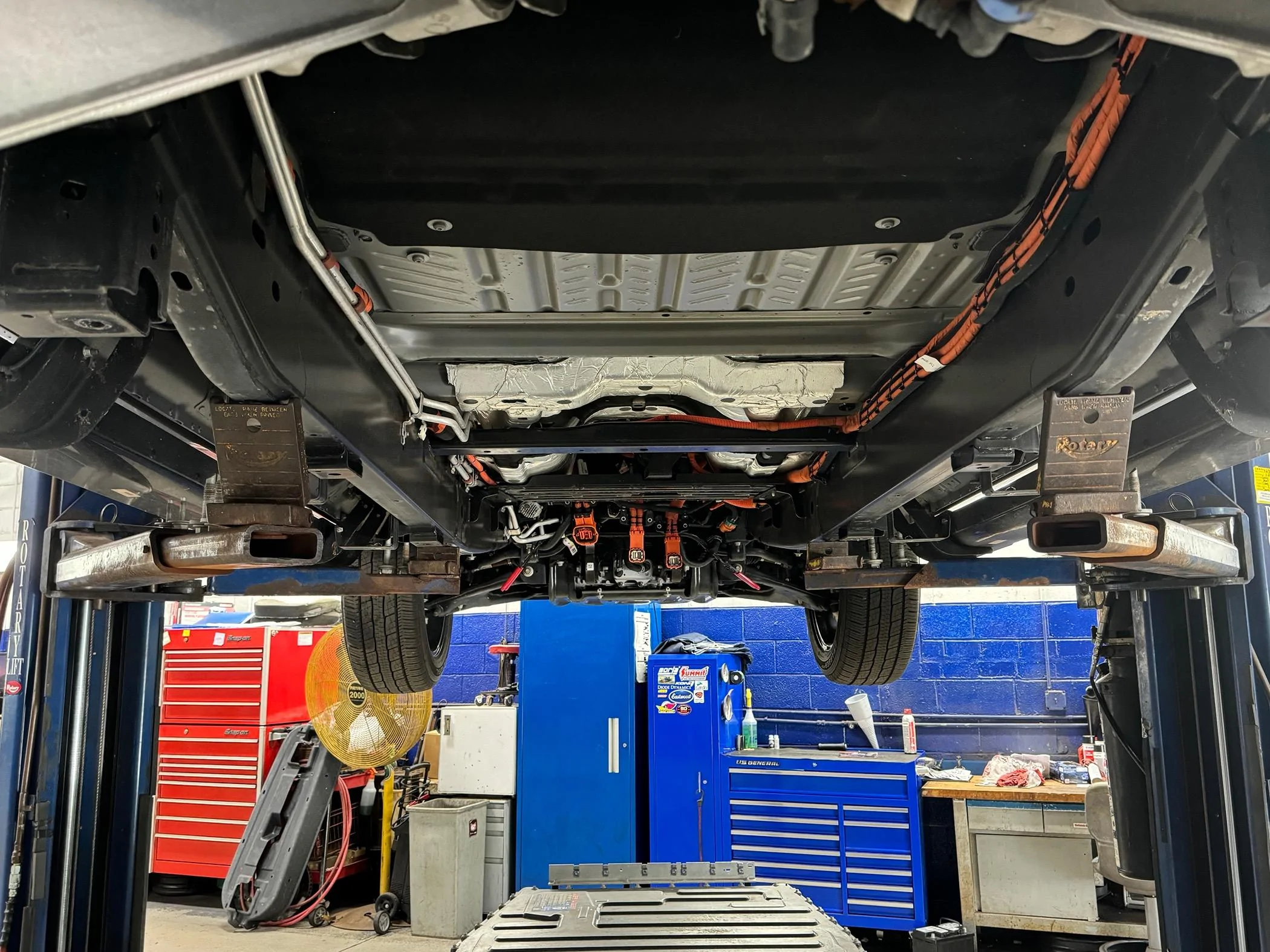

Repair involves a module (aka "Array Assembly"), two tubes of thermal paste, and a new heat shield (guessing the old one is covered in paste).

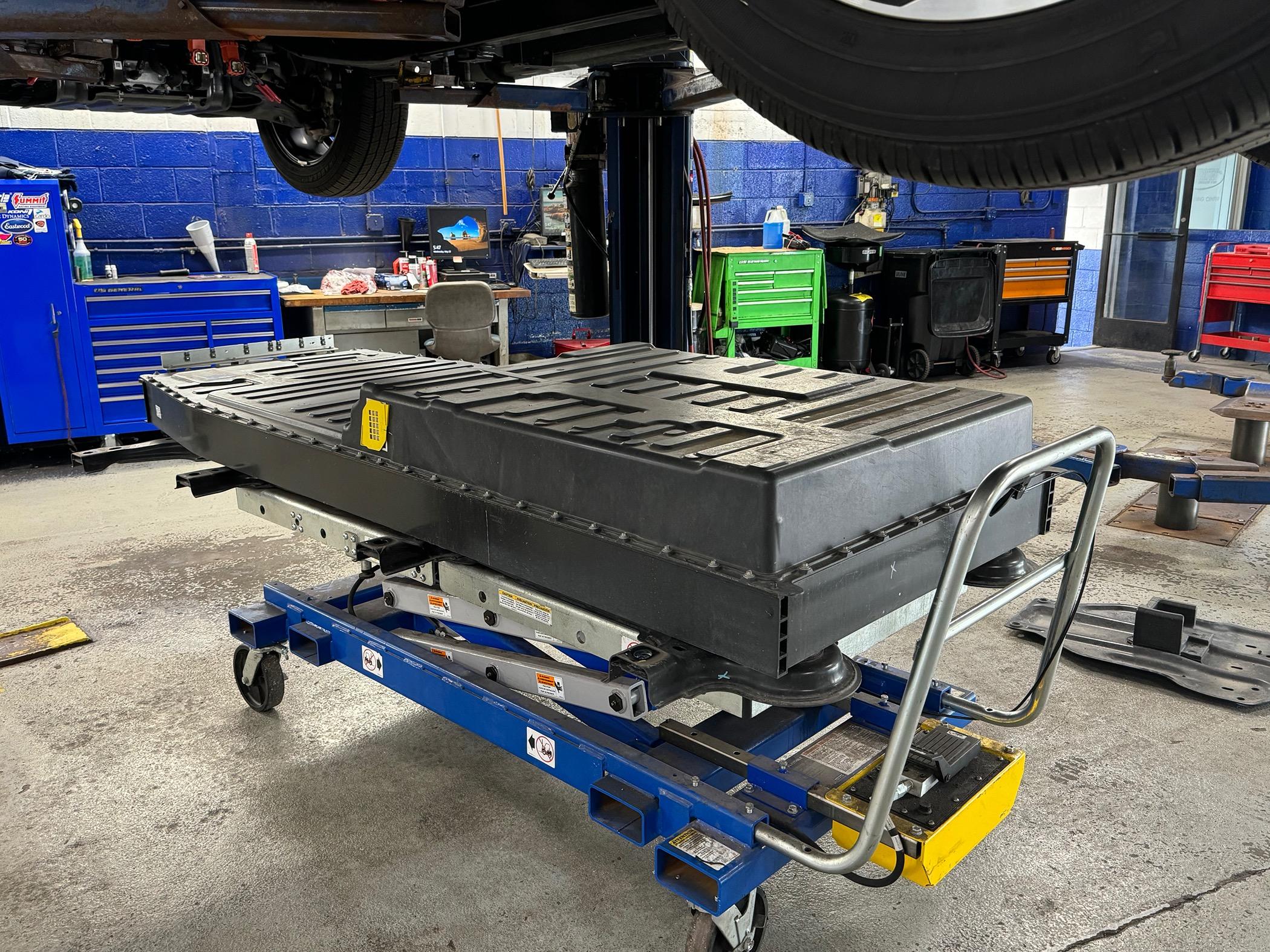

I assume what they label as the heat shield is the cooling assembly on the bottom of the battery. The TIM can be scraped off, but it’s recommended to get a new one since it could be hard as a rock.
I still don’t get understand the use of the word “cover” though. Anyway, they dropped the battery in preparation for the module install. Knowing how big the pack is and seeing it are two different things. This pack is massive… lol.
