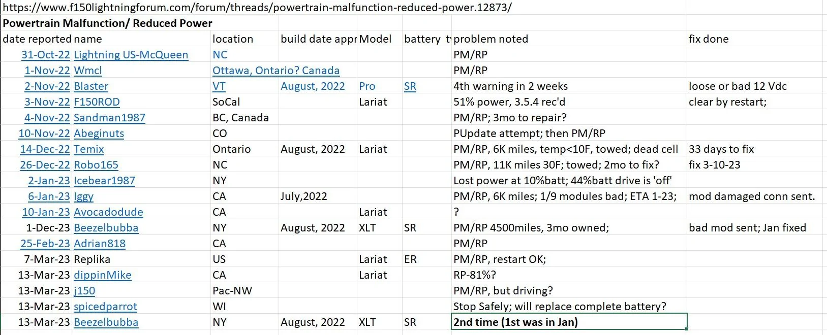

These are the folks mentioned in this thread so far with problems, a couple seem to have self corrected. Who is missing here if someone knows of 33 reports in the forum? Wish folks would put more in their signatures of build date, model detail, and battery type. Maybe @Ford Motor Company would give us a complete list!
Ford F-150 Lightning Powertrain Malfunction/ Reduced Power 230313 Power Malfunction Reduced Power F150Lilghting Forum list of people Screenshot 2023-03-1
Let us know of any missing details and outcomes of HV battery problems and I will try to update the spreadsheet:
Here is link to an extended Google Sheet, including another forum battery problems threads:
230313 Powertrain Malfunction - Reduced Power forum track list - Google Sheets
Am I missing anyone?
230313 Power Malfunction Reduced Power F150Lilghting Forum list of people Screenshot 2023-03-1...jpg
For me it was a faulty module and took Ford 5 weeks to replace. Has been working fine since. XLT extended range
Code:
<a >https://docs.google.com/spreadsheets/d/1xoQZ78uBmrzpOLMD7fHR6g4gS9KpNeKaAjGlQRDR0hU/edit?usp=sharing</a>
Hope you can pick out the web link in the "code" above. I do not get how the link otherwise gets converted to "media" that does not seem to open the Google Sheet. @TaxmanHog
Those build dates are close enough together to suspect a trend. Obviously, not scientific in any way but there's definitely a pattern.
You can add me to this wonderful list. Build date was 7/25

@F150_lightning
"add me to this wonderful list. Build date was 7/25" [hmm quote system not working]
Mileage at failure? Any dealer estimates on time to repair? No warning email from Ford?
Would be nice if the HV battery cell "near future failure" was picked up by Ford (or by an onboard monitoring/reporting system!) before getting stuck somewhere. I wonder if Ford had an idea of the number of cell failures they were going to get before going into full production, thinking the customers would tolerate the fail rate?
I also wonder about fail rates as the years go by... I hope @Ford Motor Company will prevent the obsolescence of the truck body by having reasonably priced full (solid state?) battery pack replacements by 8 years down the road. I read the average vehicle life is actually 12 years until junked, but pickups are generally kept longer. Of course mileage is another factor, but hopefully the electronics are good for any number of miles.

@F150_lightning
3-4 week wait on the part

@F150_lightning
Mileage at 2,500
Ford call mid Feb and email end of Feb
Dealership has the parts but dont know how to fix. They are working on someone else’s truck first. They said maybe I’ll get it back next week. Not holding my breath.
